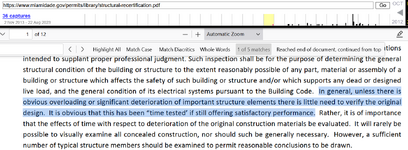

A lack of robustness in the recertification language that at least tempts engineers to ignore life-safety and ignore the existing plans and focus solely on signs of weathering/distress and fixate maniacally on windows and doors and electrical wiring, and ignore wind loading (since it wasn't even mentioned) of the building. (you need the internet archive to see the 'at the time" language, they've revised it.
Current (November 18, 2021):
November 2, 2013 copy:
You can compare the language using Draftable, PDF24 or I love PDF, if you wish, but the bit about wind load was added recently, previously they got excited about windblown gravel, but not the global LFRS, and also waived dead and live loads as a concern because they were "time tested".
