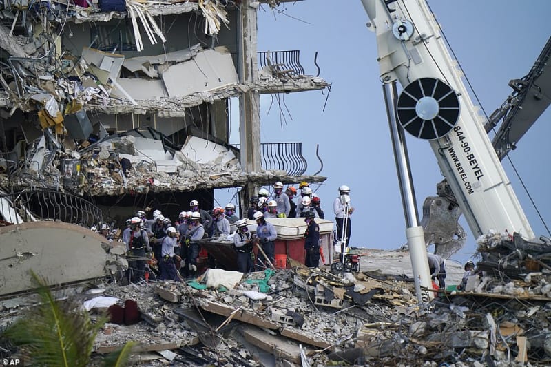

Here's a clear photo of a non-involved column for what it's worth.
