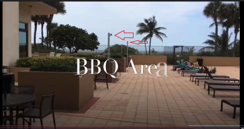

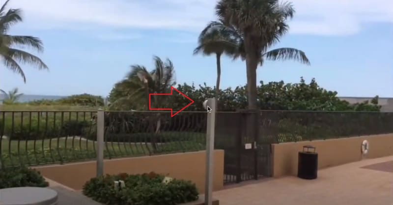

There are cameras on that pool deck. Multiple cameras.
Wonder who has that video... I imagine some or all of the video is stored in the cloud?
