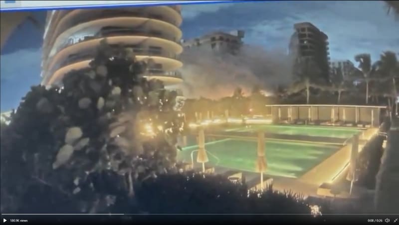

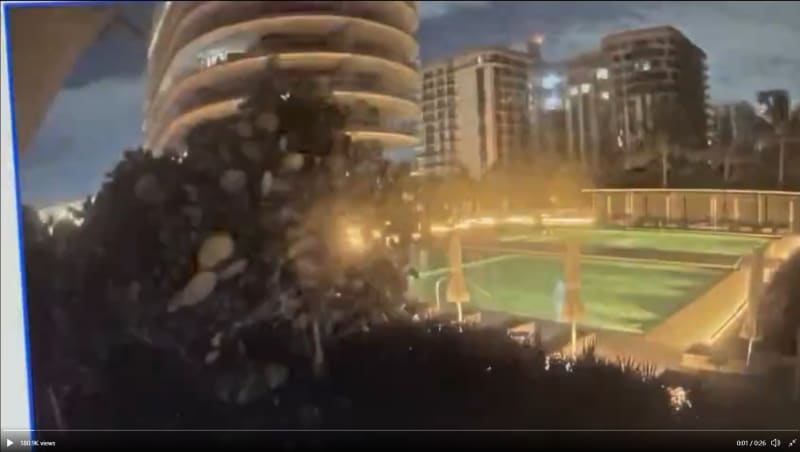

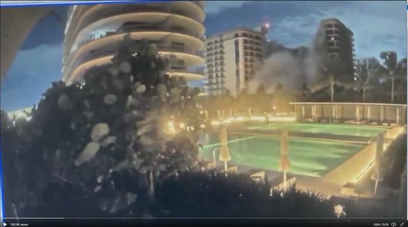

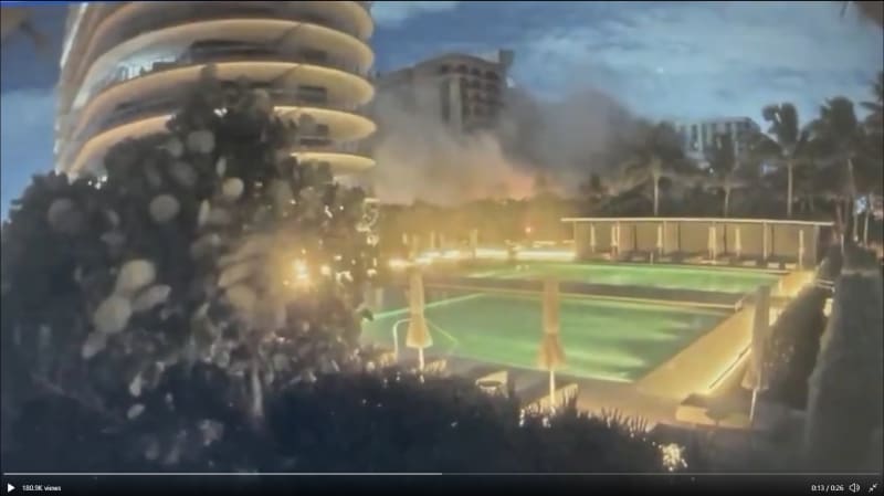

That's total and complete system collapse. You couldn't get it to pancake like that if you tried to demolish it.
Looks like panel construction - echoes of ronan point maybe?

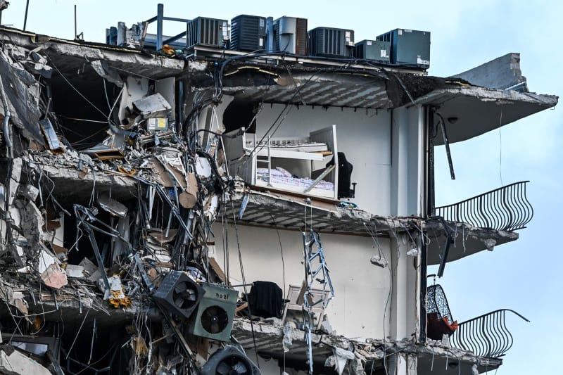

Overloading leading to progressive collapse?
I cannot tell from the photos. Does it look like post tensioned construction or conventional rebar? Is 1981 construction too early for post-tensioning?

[pre][/pre]It looks like a pseudo pan joist system formed with insulation. I am not familiar with that technique. It looks cast-in-place. I cannot tell if the reinforcing is PT or conventional.
Very odd for a 40 year old building to fail in a catastrophic way like that. Be interesting to see what the cause may be.
I can't see a re-roof causing this. From the video it looks like failure initiated at the base. It would take an awful lot of materials to add enough load to a column to fail it.
Being so close to the Atlantic it could be some sort of long term corrosion.
