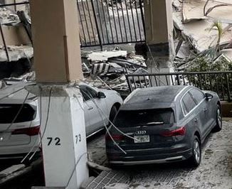

I spent more than a few minutes scrutinizing the rubble pile before I noticed the parking slab under the standing portion. There is not a lot of reinforcing in the top of that slab. Nor do I see any PT even though the slab is pretty thin. I think that may be why the rescue efforts are not extremely active and robust. If that parking slab did that under the entirety of the standing portion, I would be really concerned about the stability of that remaining portion.

I noticed that the remaining part of the slab around the columns, which have punched through, is almost nothing:
I would have expected the normal ~30 degree pyramid shape still attached to the column, unless this was lost among all the damage and debris?
