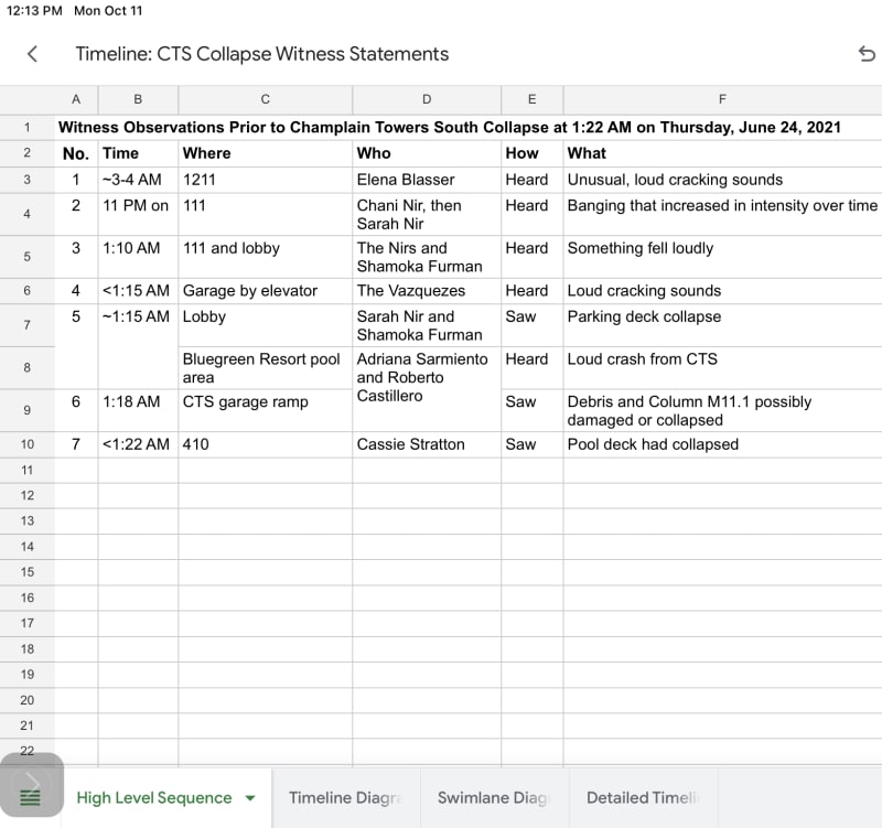

SFCharlie said:
Maybe we can talk about if we can tell what fell first the valet parking or the planter from the witness statements?
We have already talked about this in past threads, so I see no value in rehashing it. But, to review, no, you cannot tell a deck collapse sequence from witness statements.
We know from Jinal’s structural analysis where the weakest part of the deck structure was.
We know that Elena Blasser in 1211 was awakened by unusual loud cracking sounds the previous morning, sometime between 3 and 4 AM.
We know from the banging sounds heard in 111 from 11 PM on that something was already changing in the deck or building. We don’t know if these sounds were heard elsewhere, or if they started earlier.
We know that something fell loudly at 1:10 AM, and was heard from 111 and the lobby. We don’t know what fell or where it fell.
We know that Nico Vazquez and his wife Gimena Accardi were in the garage elevator vestibule just before the deck fell at about 1:15 AM, and they heard odd loud cracking sounds a few seconds before they got on the elevator. They were actually in the elevator when the deck collapsed. The Vazquezes did not state that they saw any debris in the garage before they got on the elevator. That’s not to say that a piece of ceiling couldn’t have collapsed in an area that they didn’t look toward. However, we don’t know what space they parked in or what path they walked to the elevator.
We know that the only witnesses (Sarah Nir and Shamoka Furman) who saw the deck collapse at about 1:15 AM saw it from the lobby, so they were looking at the parking deck near the lobby. Neither of them reported having looked past the parking deck at that time.
We know that Adriana Sarmiento and Roberto Castillero were in the pool area at the Bluegreen Resort, and heard the deck collapse at about 1:15 AM. They made their way over to the street and videoed the debris within the garage viewed down the garage ramp at 1:18 AM.
We know that Cassie Stratton in 410 told her husband that the pool deck had collapsed when she spoke to him in the moments before the building collapsed at 1:22 AM.
>>>>>Edit: charlieSF favors PPTs and I favor spreadsheets. So here’s a spreadsheet version of all this text. I can add a column for Why if anyone has any explanations they’d like me to add.

so, "something fell loudly at 1:10 AM", "just before the deck fell at about 1:15 AM, and they heard odd loud cracking sounds a few seconds before they got on the elevator. They were actually in the elevator when the deck collapsed", "saw the deck collapse at about 1:15 AM saw it from the lobby", "heard the deck collapse at about 1:15 AM. They made their way over to the street and videoed the debris within the garage viewed down the garage ramp at 1:18 AM.", "the pool deck had collapsed when she spoke to him in the moments before the building collapsed at 1:22 AM" Thank you Maud!
