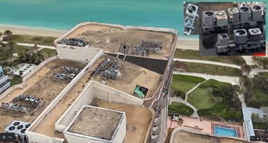

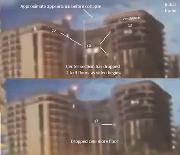

In the first frame of the surveillance video, the center of the building had already dropped down 2 to 3 floors. The parapet for the penthouse roof over the middle section of the building appears to be missing while the parapet for the roof of the 12th floor remains. Building on the narrative that warrenslo and Dold have elaborated, I believe that as a result of penthouse roof weakening induced by the recent installation of anchors close to column tops that may have compromised the rebar underneath and the additional load of roofing materials added to the already critical load of air conditioning units, the penthouse roof may have given way at the front causing the parapet for the penthouse roof over the middle section of the building to crash down behind the parapet for the 12th floor roof, leaving the rear part of the penthouse roof attached like a hinge. This would have caused the penthouse roof to tilt down at about a 20° angle (see photo). This amount of tilt would have caused some of the air conditioning units to topple over because they are already top-heavy as a result of their motors being near the top of the units and placing them even higher on raised metal frames would have caused their centers of gravity to extend over the footing of the frames. After toppling over, they probably rolled downward into the parapets, crashing through the parapets along with the green bag of roofing materials, and then falling further to the deck below right in front of the three critical columns holding up the middle section building. This would have caused the two columns K10 and L10 to punch through the pool deck, initiating the fall of the center section, which then caused more of the pool deck to fall as a result of the loading from the collapsing building.

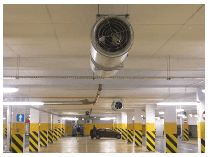

we see a round object inside a squarish frame near column 27 beside a second rectangular object and what appears to be two portions of a broken column. Sym P. le has speculated that the round object inside the squarish frame near column 27 and the second rectangular object to its right are an SUV (possibly a Ford Explorer) positioned head in to parking space 27 that knocked down the column behind it. SFCharlie has speculated that the round object is a washing machine, and JS5180 that is a ventilation fan. Sym P. le has also speculated that the green object is a planter from outside room 111. I believe that the round object inside the squarish frame near column 27 is an air conditioning unit originally installed on the penthouse roof over the middle section of the building. The color even matches the light color of some of the air conditioning units (see photo below). I believe that the rectangular object beside it may be another air conditioning unit and the two rectangular objects adjacent to it may be portions of the parapet for the penthouse roof. I join with warrenslo in believing that the green object is a carrying bag used by the crane to lift materials to the rooftop that was left on the rooftop overnight (see photo below). I believe that these objects slid off the penthouse roof when the roof tilted as a result of the rebars holding the penthouse roof to the front columns were weakened by drilling holes for anchor installation and gave way later during the night as the weaker penthouse roof was heavily loaded with air conditioning units, anchor materials, and roof repairing materials. This event would have happened before the TikTok video was taken seven minutes before the collapse of the entire building, and probably seven minutes before the entire pool deck collapsed. This event would have caused two loud crashing sounds, one when the penthouse roof collapsed onto the roof of floor 12 below, and one when the air conditioning units fell and crashed into the deck below along with sections of the penthouse roof parapet and the green tote bag carrying heavy roofing materials left on the roof overnight by the workers.

Really good job on that post. On Round object in tic toc being an a/c compressor unit: not sure but I think I see the fan blades.

Just wanted to comment with regard to A/C units on the roof(posted by MarkBoB2). I was an HVAC /Energy Conservation engineer. The units on the roof are small units like you would have in your home probably 3 to 5 tons (12000 btu/hr = 1 ton). Codes require them to be bolted down.
Also they are not top heavy, but bottom heavy with the compressor mounted at the bottom, the coil wrapping around horizontally. A small motor at the top of no more than 1/2 hp is on top that weighs about 20 lbs. I just sold the cond fan motor from my 3.5 ton Carrier on ebay.
Certainly all ac units in the collapsed section ended up on the ground.

If the roof collapsed many minutes before the rest of the building, where are the panicked 911 calls from floors 9, 10, and 11?
If there was some cascade of debris coming off of the roof onto the ground below, how was it that no one observed this or reported noises coming from outside of the units?

Also, your pic of the surveillance photo is mislabled btw.. those lights that are on near the middle of the building must be for the 9th or 10th floor because they're right around where those vertical lines on the building end. It is a bit of a mystery on why the roof and penthouse aren't visible, but they could have fallen down to the 12th or 11th floors in the second before that video starts.

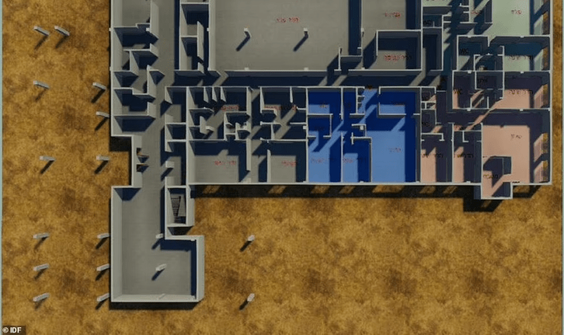

Also, according to that budget doc it does look like they had a security room btw.. they said that equipment was in the Central Recording Station and the photo they seem to show is of a second monitor. If you look at the Israeli 3D models of the site too, it looks like it went through several reconfigurations downstairs.

I think he is referring to the other circular object apart from the gate Champlain "C" . It's been discussed here separately as being possible anything from a washing machine to a truck wheel well.
They also had round tables right next to the planters btw.. could easily be one of those.
Yes, but then someone found a photo of the ventilation fans in the garage, and this is obviously one of them that was hanging from the ceiling right above where it fell.

Thermopile said:
it would not surprise me that most of those residential units are NOT tied down.
On the roof of a 12 story building in a hurricane zone?
Thermopile said:
I fully agree Penthouse and perhaps 12th floor in middle fell first. Something woke up the security camera to catch the scene after initial trigger.
That would have happened several minutes before the main collapse. When 111 and 611 were hearing noises before they fled the building. Wouldn’t that have all been captured by the security camera as well?
If I heard the Penthouse roof crash down and got woke up in middle of night, the last thing I would do is call 911.
I would get my ASS moving fast
