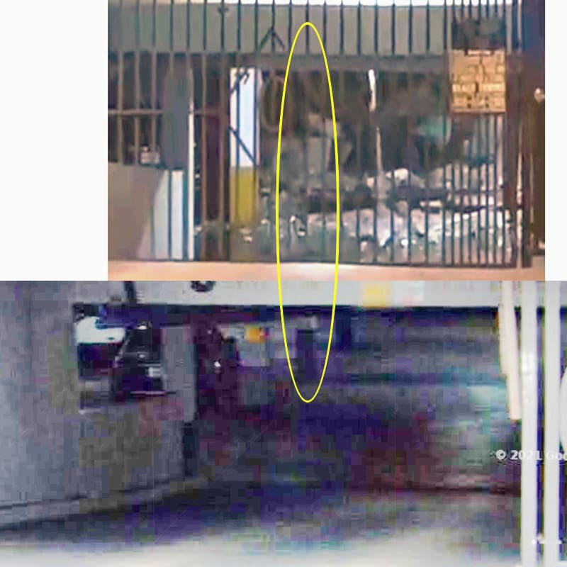

The following images compare the TikTok view to that of the Champlain North tower from Google Earth. It seems that the column between stalls 27 and 28 has been obliterated and perhaps the rebar from the column lays across the entrance aisle. The column at front of 28 (next in line in these images) is known to still be standing having punched through the slab and being visible in the post collapse imagery.
The missing column would be unique in not having punched through and this would be consistent with impact from falling debris. MarkBoB2's comparisons are compelling even if hard to believe.
In the following, I've scrunched the image width to somewhat account for the difference in perspective.
