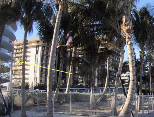

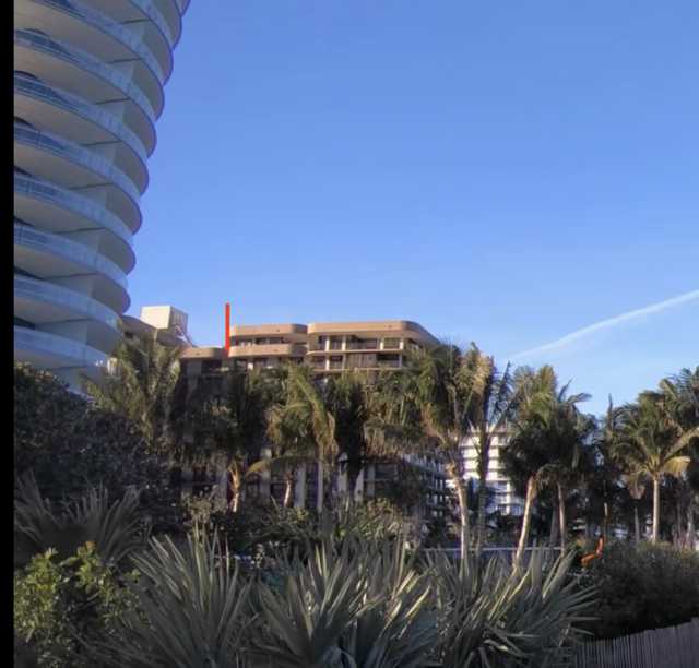

I continue to think that some degree of early damage occurred on the western penthouse roof - these images is from the surveillance camera’s perspective, and includes the camera itself. The drop of this middle area is not well explained in the context of the lights still being on. Both theories need some work, and there isn’t much to prove or disprove.
It’s incorrect to say that it’s impossible because nobody reported falling objects. How many people were watching before the booms?
As for occupants on the upper floors or in x10/x11 above floor 7, we don’t know if there ere any that night. The lack of complaints doesn’t mean there wasn’t an event there.
Finally, a roof collapse could have occurred even seconds before the main collapse, and that would explain the missing parapet. Again, I don’t see how any of these theories can be ruled in or out at this time.

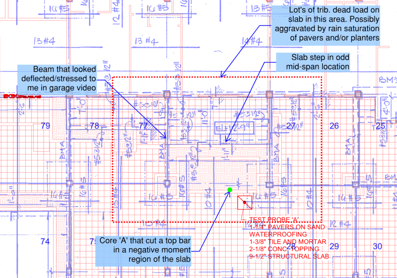

@Demented - good point about the water weight. Do we know if there was a drainage system installed prior to the collapse? It looked like white pvc drain pipe was hanging below the plaza slab in the parking garage tour video. But that may have been for something else.
The planter soil may have been quite saturated as well.
The "impact by falling roof stuff" theory is certainly sensational in comparison to the more pedestrian "highly-deteriorated, minimally-redundant plaza slab system gives up ghost" theory.
For the roof-based theory, it sure seems like there needed to be a chain reaction of components experiencing there own acute, sequential worst case scenarios.
For the deteriorated plaza theory, all it really needed was father time and breakdown of inherently impermanent / imperfect systems.
Something cut this building's legs out from under it. I personally lean towards the plaza deterioration theory. At the same time, the falling roof debris theory isn't an impossibility.

bones206 - I feel pretty strongly that the deck collapsed first. It's hard to know the exact origin with the available evidence. What you suggest is a strong candidate. The other area of interest to me is the at grade parking area south of the lobby and west of the pool deck. This area was also in poor condition based on the reporting and videos. It too had planters but unlike the pool deck, there is no evidence this area ever had waterproofing in its 40 year history, then add in the live load of cars backing in and out for 40 years.
I also feel pretty strongly that failure at the area you point out led to the eventual collapse of the building. Start on the basis that the deck collapsed first, and then ask why some parts of the deck simply punched through supporting columns or sheared away from the structure, yet this particular portion of the building collapsed? Then ask, what is different about this area? The answer to that is that this area had a stronger connection to the building than any other area of the pool deck because of the beams supporting the step down terrace. And therefore, the most likely area of the building structure to be impacted by a failing pool deck.
