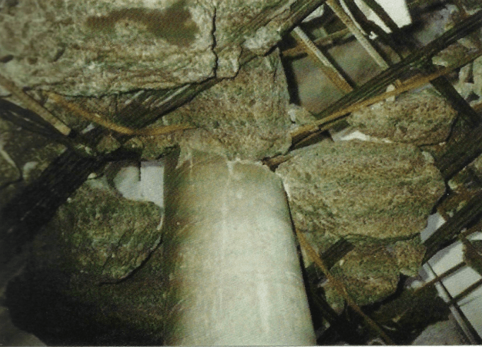

I don’t see how unbonded PT tendons that are stretched to 70%-80% of their ultimate tensile strength can offer any shear strength. They would be under extreme tension + shear = pop.
Modern connections are more robust due to the use of stirrups or stud rails or puddling of high strength concrete atop columns (questionable).
The pool deck design had no real shear reinforcement. The design concept was
To design the concrete thickness to handle the shear. Then to design the horizontal top bar for flexural tension, and then place a certain amount of horizontal rebar directly over the column for good measure. This is the same philosophy with modern PT.

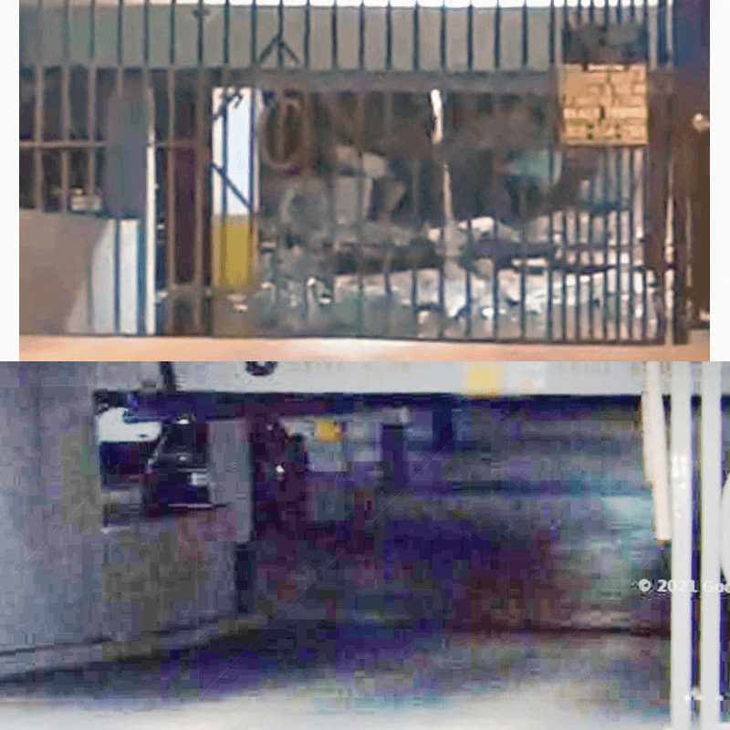

Does anyone see the black stuff In the middle of the rubble. I thought it was a contiguous object at first but then I think I realized that some of it is interspersed with shadows due to the lighting orientation amidst rubble, and it just looks like a continuous piece of something. And then for some unknown reason I thought of roof paper rolls. And then I looked at it a bit more. Thing that bothers me is that I did not look at it with the idea of finding roof paper rolls. I was not looking for them.

I am missing your point. I think it's been said there was roofing paper rolls on the roof. Everything fell down, with the roof pieces on the top. I would expect the rolls to be there, on or near the top of the pile.
Please explain why you are surprised.
1994 Northridge earthquake - PT integrity tendons support severely damaged slab:

Sorry about that. I wasn't trying to be elusive. After I posted it I realized I left out the context. I meant to post as an ongoing description of what is in the tic tic capture that has more recently been under review. I mean to describe what occurred to me as it appears in that enhanced capture. So that in effect this would describe roof paper rolls in the basement before the main structure collapsed. I meant to look at it as objectively as I could. But what I think I see is roof paper rolls and then as mentioned before in the thread, not far away in the basement is what appears to be a material that is the color of the tarp that was used to cover said rolls. If anyone mentioned the appearance of the actual rolls in the basement before I missed it.

The left side of image looks like 3 rolls of tar paper all lined up, with slight angle changes between rolls

I see the problem. You said "in the middle of the debris". Debris to me is the big pile at the former building site. You are talking about some debris in the parking area, down the ramp. I think.
Yeah, that surely could be roofing paper. Or something else.

Then that could mean broken column is leaning onto Square planter from above
Maybe that'd be a good experiment too, toss a bag of roofing rolls on the ground from a few stories up and see if you can get them all to land in one spot. Looked like some sort of metal bar to me.. maybe a deck umbrella? I'm not sure anything on the floor of that tiktok video can be positively identified, except for maybe the column and planter since we know exactly where they'd be. Is this all we're going to discuss now? I'm not sure I see the point when the video is at such low resolution.

Js5180, I think you're underestimating how far apart the lengths would descend from this perspective.. either way, it can easily still be that white object at the bottom of the pile of rubble there.
Thermopile, How would the column end up on top of the planter though? It's also too far back.

"The left side of image looks like 3 rolls of tar paper all lined up, with slight angle changes between rolls"
That is some quality roofing paper, to remain (semi-)usable after a fall like that. I should get the manufacturer's name.

I was figuring planter rolled on way down, and column did not fail immediately?
