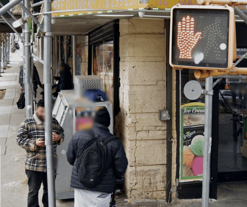

That’s wild that a pier like that would be assumed non load bearing

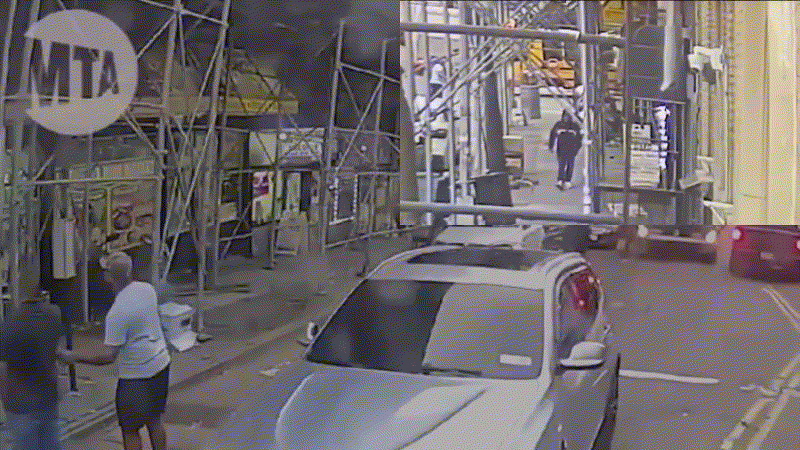

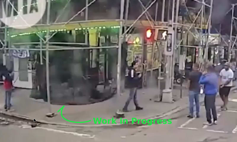

Having spent time reviewing it, I now think we are mostly seeing the work screening mesh tilting with the east scaffolding interspersed with various flashes of light and shadows. I also believe the column ruptures and sprays bricks into it but I don't think I can conclude that the column leans over.
Here's another GIF, the bro's coming to their senses. There is a flash of white (something coming down?) and buddy in white turns to leave. Right after, another rustle (just below) and buddy kicks it into gear, probably sparked by audible queues. Also, buddy in the black shirt needs a little more convincing but with the second rustle gets lit.

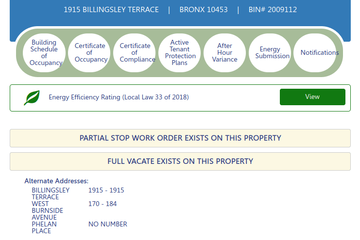

NYC Department of Buildings Self-service for online Permits, Appointments and Applications
I copied some of the inspection documents dated 2001 to the attached file.
Permits for the facade work dated 2003 are in the DOB file (not copied). The permit states drawings are filed herein, but i was unable to locate them in the records.
Reading between the lines, the item the DOB found concerning is that the POST with cracks was not addressed in the inspection report (as far as I can tell).

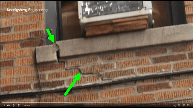

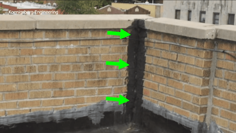

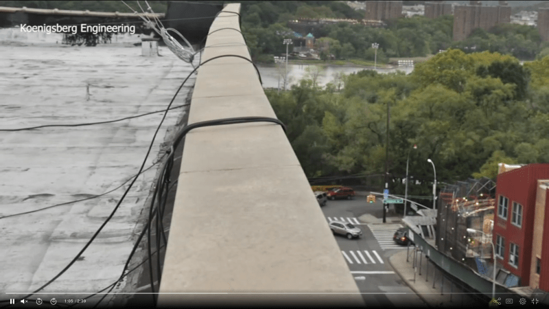

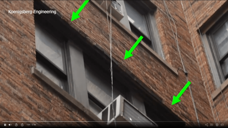

This column was highly fractured.

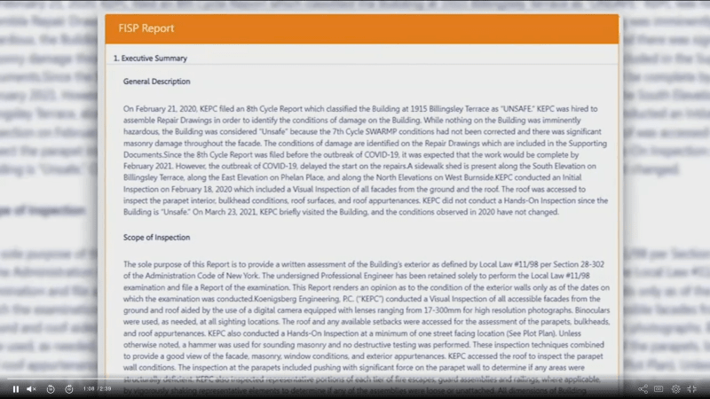

I can't find a copy of the Koenigsberg engineering report so please allow me to start with snippets that have been revealed by ABC NEWS 7.
FISP - Façade Inspection & Safety Program
