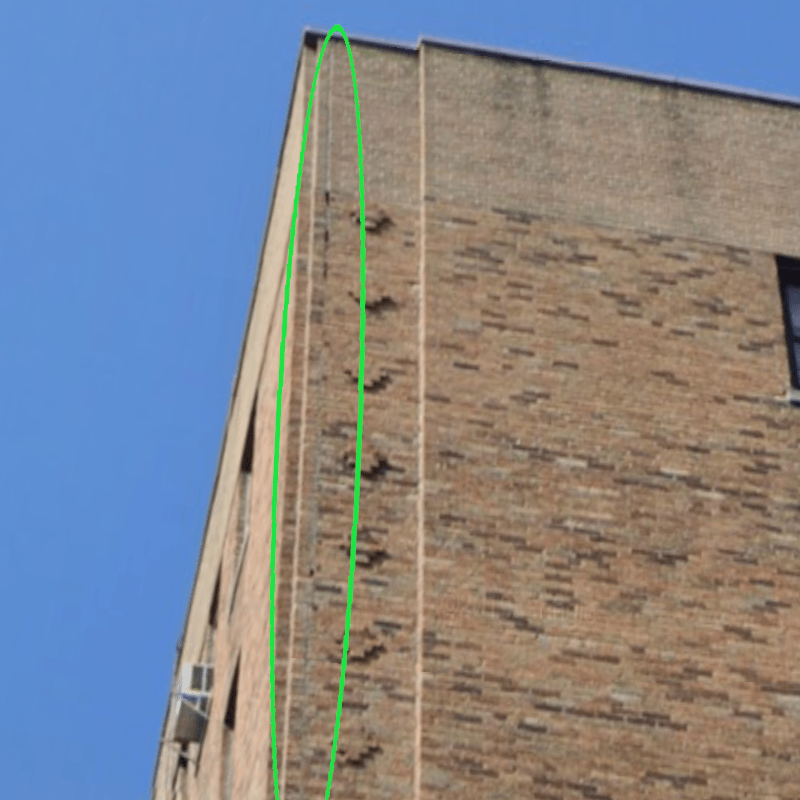

So this article mentions a 2020 engineering report that had noted a bowed and cracking parapet. It’s certainly possible the parapet let go and landed against that corner, taking out the column.
I think the engneering report speaks more to the general state of decay that was poorly understood. There are photos of the bowed parapet and the length of it is not what collapsed.

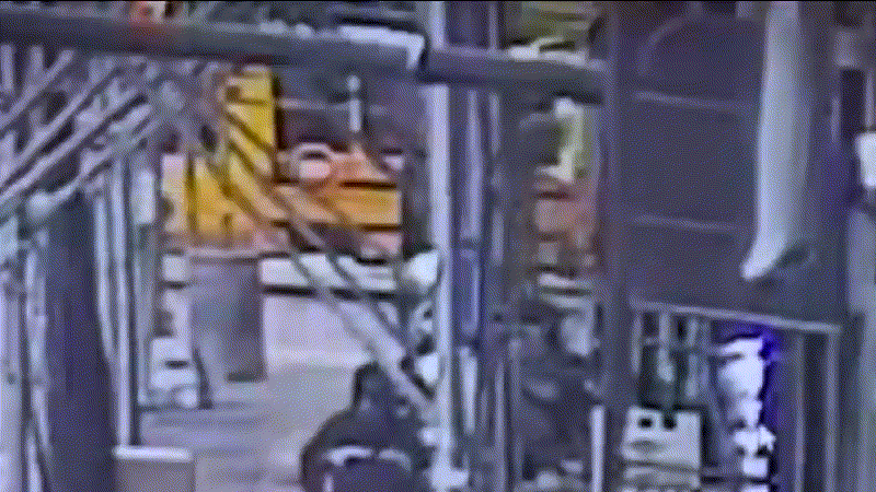

It looks like the column at the bottom was tilted outward by failures above it rather than a crushing failure.

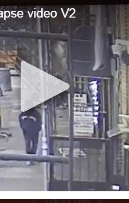

P.S. I can't see anything that looks like the column. 3DDave, can you post a photo?
The video player on that site doesn't allow a good way of pausing without also overlaying a giant "play" button triangle over the area of interest.

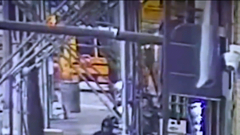

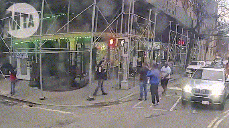

The building corner column appears just between the right side of the foreground scaffold and the mid-sidewalk series of the scaffold posts. I snipped it - look just above the arrow point. There is what appears to be a cloud of dust following it. At the end one can see how the awning is forced away from the building rather than being smashed straight down.
Ok, I see what you're looking at. If you can post a youtube link for me, I'll grab some frames later and hopefully enhance and/or gif them.
I didn't find it on Youtube - I could probably get frames from that. This is from pix11.com (link above) which has some awful video player.
The pix11 site video player is Anvato, from a company that no longer exists. That news group must have an old license to create and distribute.
Here's the animated GIF and attached MP4.
I see things leaning over followed by the column crushing, followed by the awning coming down. This would be consistent with the structure failing from the upper levels. Witnesses evacuated the bodega because of significant creaking preceding the collapse.

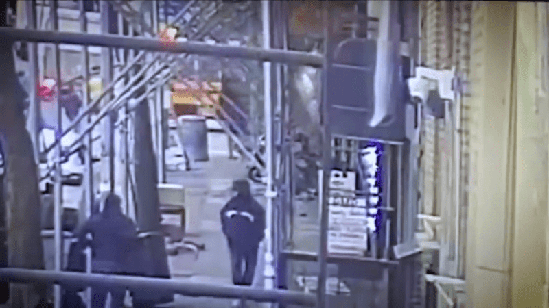

3DDave, I believe this is your frame,
Time crop and slow motion.
So are we thinking it was a local failure in the column that lead to leaning but not total rupture/collapse of the column? Then as it the wall above leaned it lead to a overload and full compression failure?
Shit. Unless I'm mistaken, that short clip seems to show someone getting buried.
In the mp4 you can also see what looks like someone flying through the air on the far left of the frame.
Composite of both videos queued on the awning lights.
It appears as though the east face of the building came down first, pushing the east scaffolding north. The animated guy in the white shirt and ball cap looks as though his attention is directed to the east face as well. I question whether the seven story column of brick had any ties to the floor levels (on the east face).
There is also this vertical seam which appears to require maintenance to avoid water ingress.

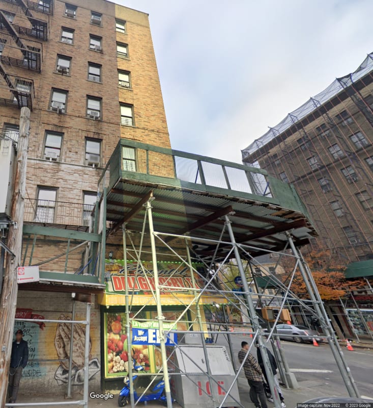

Google Street View

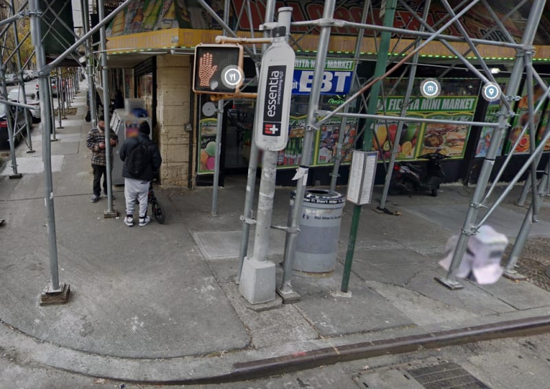

Street scene with trash bin and white box seen in above GIFs located for perspective. Most of the action early in the collapse seems to happen east of the trash bin, which is why I believe we are seeing the east side scaffolding come down first, not the column bursting.
based on Google Street View
Again, for perspective, the relatively narrow column of brickwork that came down. It's seems odd that anything collapsing would push (and tip) the east scaffolding north, but that is what the videos plainly show.
Apparently the collapse was triggered by workers taking a support column apart after being reassured by an engineer that the column was decorative.
