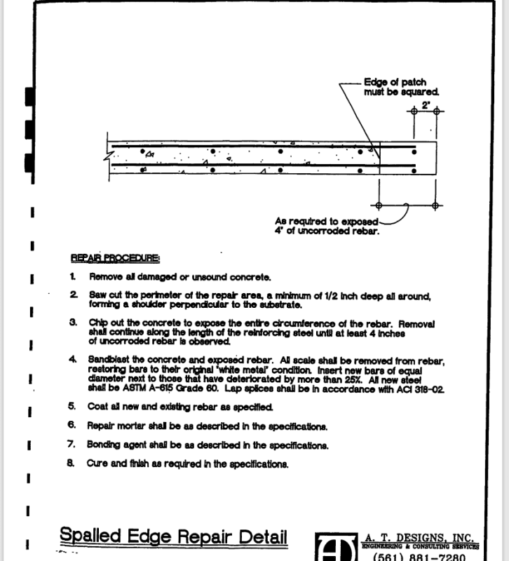

MarkBoB2 (Electrical)22 Jul 21 00:28 said:
At the request of SFCharlie I have uploaded a PowerPoint file with this submission containing the four images shown in my last submission. Hopefully this will improve the resolution of the images. It will also allow removing some or all annotation over the images to permit viewing any objects obscured by the annotation.
For anyone without a PowerPoint application, I suggest copying the JPG or PNG images from my last submission using your computer's COPY function and then pasting the copied image into either a Word or PowerPoint document before viewing. Both of these applications have zoom capability. When I did this on the images from my last submission, the resolution was only slightly degraded, probably because of using the Microsoft Paint application to create a JPG or PNG version of each image. If you still find the image resolution unsatisfactory, then it's likely because your computer display is not good enough.
Thank You!
( for those of us that don't have PowerPoint, I have attached each slide as a .png file in following posts )

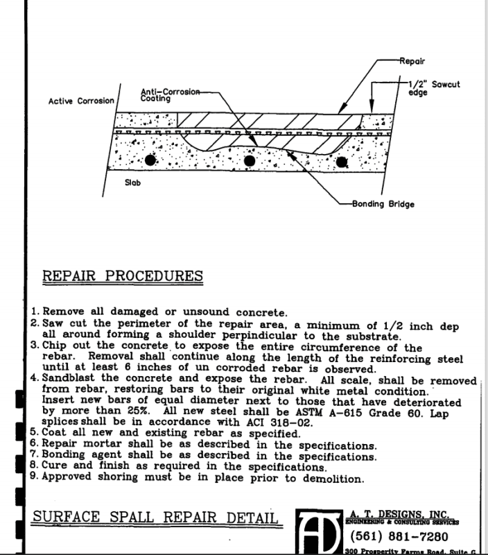

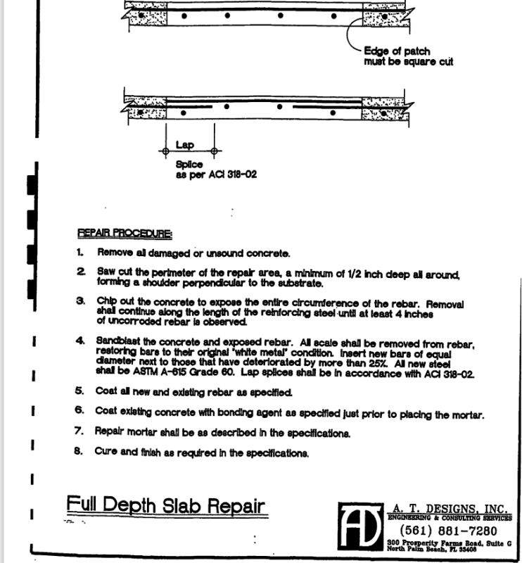

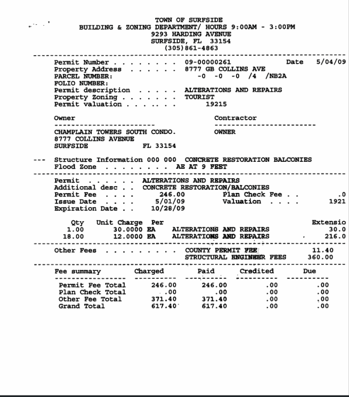

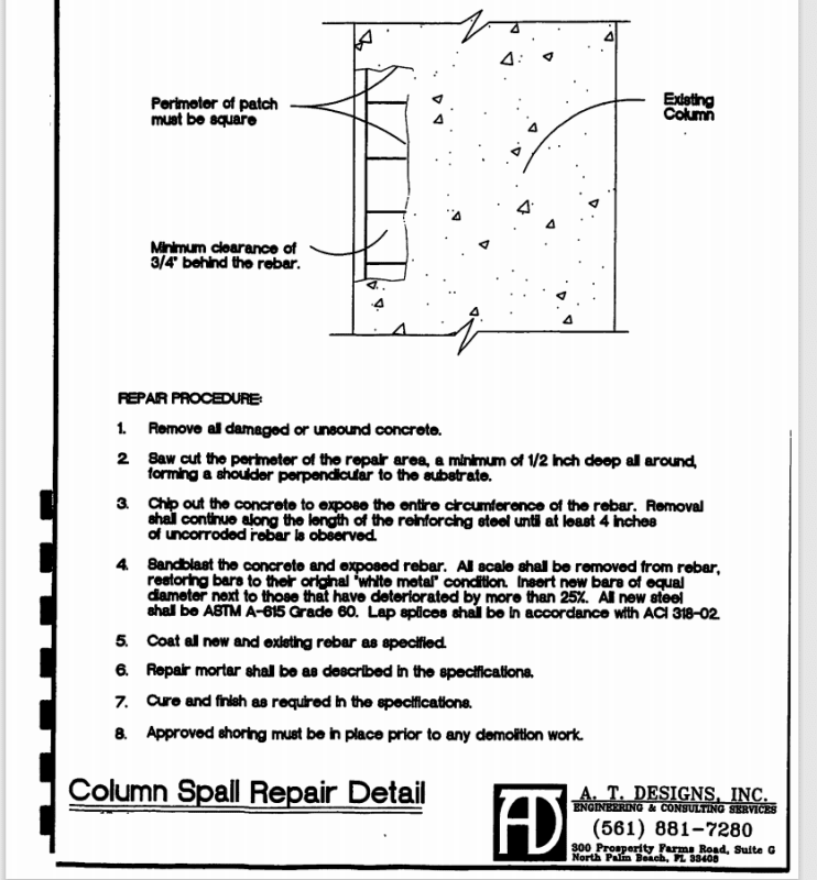

2009 permitted work.

Small world. These guys are right around the corner from me.
Please find attached:
SF Charlie
Eng-Tips.com Forum Policies
 https://files.engineering.com/getfile.aspx?folder=725b747c-4f36-4943-a90e-cde025e1e6d6&file=Photo_1_from_MarkBob2's_last_submission_.png
