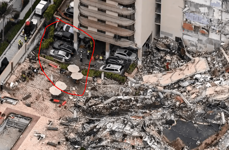

In photo 2 of your Powerpoint you mark two cars and ask "Is one of these cars parked in a driving lane? Something is not right here."
These two cars can be seen in this picture... they are in the guest parking in marked spots.
MarkBob2, I am having a hard time seeing what you see, but my laptop is a 2012 model....... and after Spartan5's Trail Mix BM, I don't think I can see or want to see anything clearly anymore......... Way TMI.......

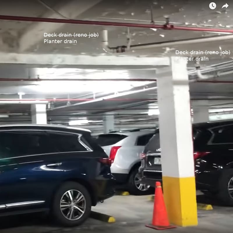

Devil's advocate back again. Is the cubic grey item a test weight for a crane and is the water draining from the deck drains, the implication being an initial partial deck collapse?
Frame grab from USA Today video
View of back of stall 27 from Youtube video of Unit 611 tour (near the end)
EDIT: deck drains are likely planter drains from initial construction
Interest thought, and that would explain it looking like raw unfinished concrete cube .......
Or counter balance weight for a swing stage hanging over parapet wall from I-Beam sitting on top of scaffolding......
There is nothing good to tie back end of swing stage counter balance to, at ground level on an suspect elevated garage, therefore a counter weight on swing stage makes a lot of sense with only crappy parapet walls to anchor to...

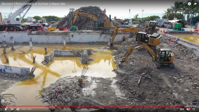

Can anyone explain why the recovery crew left this small pile of debris near the end of the ramp for two days when they cleared the area of the parking basement behind it? Was it because there was one or more objects of interest in the pile?
MarkBob2,
I clearly think there were objects of interest in that pile, and I can see some of the man made objects, just not clearly enough to validate what I am seeing on an old laptop screen with old eyes too.....

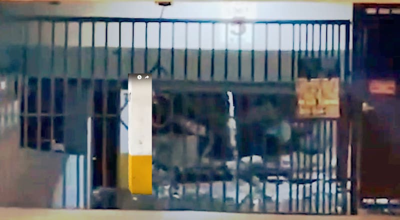

Using the frame posted above from the USA Today video along with a superimposed cutout of column 27 from the 611 tour video (scaled from the top of the numeral 27 to the top of the yellow band), it is obvious that we see the floor of the parkade, not a slab drop from above, at least in the driving aisle. The debris in the aisle likely tumbled in from adjacent areas or includes chunks from overhead but not a complete section drop of that area.
As others have told you repeatedly, red paint denotes the presence or potential for human remains. Most likely that a cadaver dog had hit on this area of the pile.
None of your the items identified through your theoretical squinting have visible paint on them.

Maybe you could use that software on the "mystery of what's beyond the Gated Ramp" photo? Prob best to start with an original photo vs anything we can link on here, or just a few posts above this one, Sym P linked one. I'd love to see what you could do with that!
The "gated Ramp" photo was from a TicToc video taken using a cell camera having a very limited resolution. My computer and high resolution display cannot increase this image resolution when it it limited by the camera in the first place. The photos of the debris pile that I have shown were taken by a high resolution camera on a drone or by a high resolution still camera while standing near the ramp area. These photos are clearly of professional image quality made by someone who could afford a camera with high quality optics.
