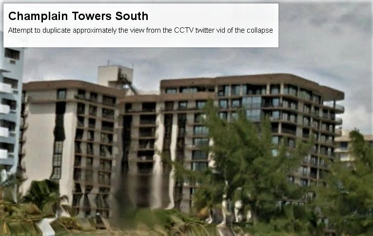

I have been at work on a prototype of a new PowerPoint presentation. I removed all the "duplicate frames" (frames with no light, leaf, or collapse movement). Around frame 20, I noticed I could see the top floors. I marked them in red and then backed up to the previous frame and aligned the red with the portions that remained visible. I was able to do this almost to the start of the frames.
Are you saying your top red line is not actually in line with what may be seen as the far (north) PH corridor parapet? And what is immediately below is not the roof surface hinged down?
rodface said:
For those looking for grassy knolls in blurry videos...
This is how the building would have looked from the camera's precise perspective, when intact.
That appears wrong. You're missing a section of 12 floor roof parapet.
