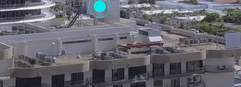

So the PH plans, page S10, with BM42 for the cooler support do indeed have it on columns D2.1, D4, E2.1, and E4. It appears as though it was possibly Spanning out from D, over E, and half into the slab between E and H, or just from the E to H lines. Unless I'm an idiot, I can't figure out why the replacement beam called for 24ft for a 14ft 6in span. Probably just most nothing in a sea of messed up prints.
Demented, I think As-built the beam spans between E and H which is supposed to be a 23 foot span
The Penthouse corridor changed several times on plans, and they did away with Penthouse Elevator that was in early PH revisions...
E to H was 23ft. Only issue I see there is, the entire tower stack should be more East than it is on the PH roof as seen in aerial photos. If they did move it to the E to H span, that makes the janky repair work and modifications even more janky.
4K drone video. Whoooo.
Early plans had the HVAC plant on the D–E span, but that evolved to the wider E–H span. As far as I can see, it was built as E–H, and has remained there since. That's possibly slightly better structurally, as all 4 columns go down to the foundation. D4 goes to a transfer beam on the lobby or second floor slab (I forget which), and is replaced by D5 in the basement.
