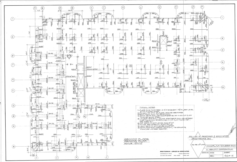

One thing that’s been a subject of speculation is the UPH Addition and what impact it may have had. I think it’s important to note that there is every indication it was intended to be constructed from the very beginning.
Not arguing, but what leads you to that conclusion?
This specific page:
Vance Wiley said:
Could you please elaborate a bit?
It’s one of the few from the original permit set (identifiable by the ring punches and signatures) but shows only reinforcement detail and minor changes required at that level for the UPH.
Compare to the same page from the “New Penthouse Addition - South” application set that came later (but has the incorrect vertical openings):
FWIW, the north tower has one of these oddball pages as well.
If someone else has a better explanation, all eyes are upon ya.

Both drawings are titled SECOND FLOOR FRRAMING PLAN.
So they changed the Second Floor in order to add a penthouse? Probably due to added wind exposure so more drift moments in the slab and columns at the second floor level. The shears and moments for the slabs and columns are increased by one floor due to the addition at the top. Originally the First Floor slab and columns had similar moments because they were an equal distance ( same number of floors) from the top. And the First Floor slab was thicker, as I recall.
The columns have more vertical load and more bending if the penthouse is added. Were they increased in capacity as a result of the PH add?
