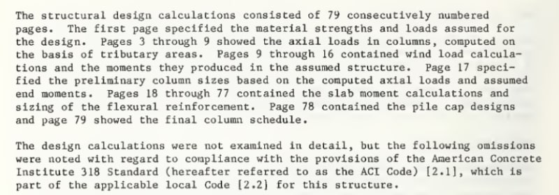

Offhand, I know this isn't on topic, but does anybody out there have the 79 pages of structural calculations from Harbour Cay?
Investigation of Construction Failure of Harbour Cay Condominium in Cocoa Beach, Florida, NBS 145, Lew, Carino, Fattal, Batts, Aug 1982 mentions them.
To quote:
I'm asking as this seems like perhaps somebody who's following this thread might also remember that building.
Any other places one might inquire as to those calculations would be appreciated (All the sources I have tried who wrote articles on it, based it off the NBS report and didn't have the actual calculations, i.e. Delotte).
Also, sorry, on a more related note, I thought somewhere in this discussion somebody separated the drawings by discipline (Structural/Mechanical/Architectural, etc.). I am working back through the thread trying to find that post, but haven't found it yet, so if anybody knows where specifically that post is, it'd be appreciated. I've gone through Part 1 - 6 already.

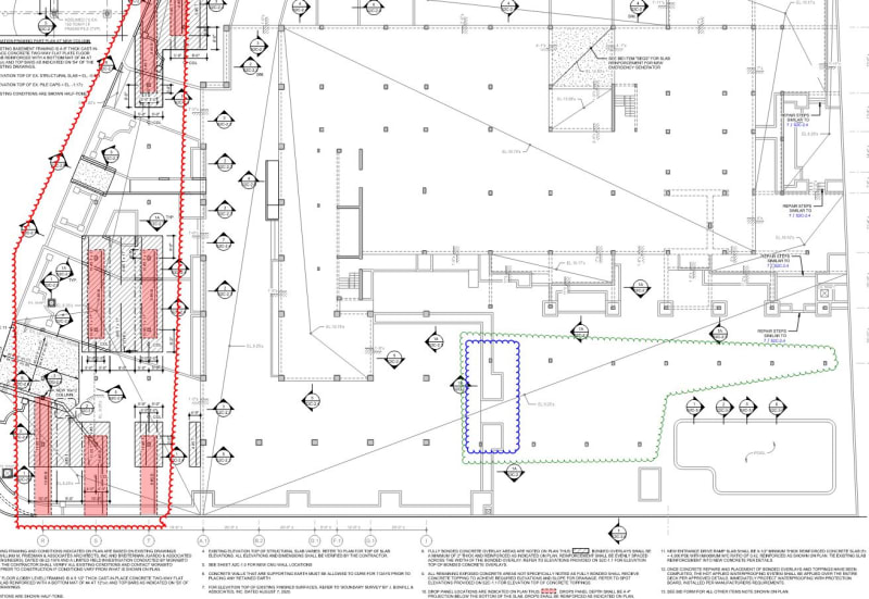

Dave - I don't think this is accurate. Please consider revising your post, if possible.

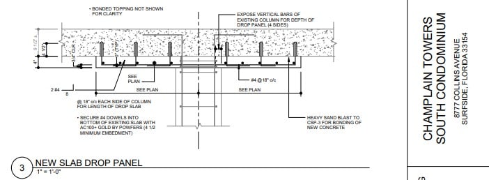

In fact, I think these comments show that you haven't looked at the repair drawings by Morabito. You should review the Morabito drawings before you comment on what was or was not in them.
There were details showing reinforcement in the column area, by Morabito, As disclosed on the Surfside web site: Champlain Towers South, Phase IIc drawings
Source: Morabito Phase IIc, Champlain Towers South drawings, 4/27/2021 Not for Construction
These look a lot like approaches to fix a punching shear problem. Are they in the right locations? That I don't know. The nature of the detail suggests repairs involving the pool deck because there's no column depicted above it in the detail.
Now, it's possible that these drawings were issued after the collapse, I don't know about that. But there was definitely a report that Morabito issued after the collapse.
As to Mr. Klein, this seems inaccurate as well, unless Phase IIc drawings were only issued after the collapse. What's your source, please, because many of us would be interested in seeing that document, and I don't think it's in the 19 threads here.
I've seen a lot of people here post about an obvious punching shear problem, but I've not seen any load calculations or strength calculations, as I recall. I haven't read the entire sequence of 19 thoroughly, though. I do recall a YouTube video where somebody did calculations, though I don't recall seeing the actual calculations just a few screen shots of their work and discussion of how they arrived at it.

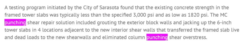

As to the plausibility of Morabito being totally unaware of s punching shear issue, Frank Morabito wrote an article where he discussed the Dauphin towers fix that was done by Morabito and that report specifically mentioned punching shear. That to me suggests that they checked it and intended to address it via structural strengthening at the slab/column.
Source: Dolphin Towers Condominium Remediation, Morabito, Structure Magazine, July 2016
Lucky for us, the same Morabito drawings you linked, and that I had previously reviewed do in fact tell us where they designed these drop panels. Unfortunately, as I mentioned, they are nowhere near the critical areas of the pool deck. I annotated the plan in red to show the locations of the drop panels, the area circled in blue are the critical columns that initiated the collapse, and the areas in green are the other pool deck columns that were underdesigned in terms of punching shear.

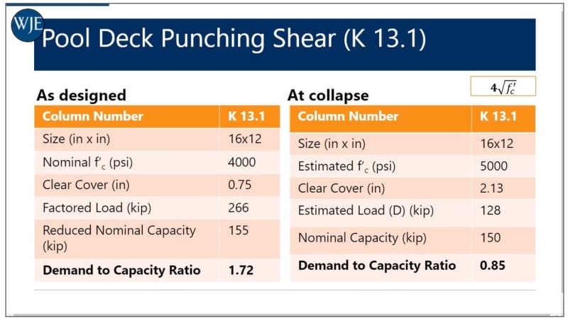

I'm not sure exactly what you're referring to here, but near the 14-minute mark of this presentation by Dr. Matt Fadden who appears to work for (or with) Mr. Klein, they discussed the punching sheer printouts from Morabito.
That same presentation has several other punching cheer calculations throughout the video, one is near the 33-minute mark. Punching sheer calculations are not particularly complicated to do, they've been in the ACI 318 standard since at least the 1970s. If you are looking for punching shear design calcs, they are quite simple to do yourself (as a structural engineer) using the original design information provided by the city of Surfside and ACI 318.
I wasn't implying that Morabito did not understand punching shear as a structural mechanism (as I had even referenced the fact that they had punching shear design calc printouts in their file). I hope it was obvious, but I was referring to the fact that Morabito failed to identify the punching shear design flaw at the critical columns of the pool deck at Champlain Tower South. I definitely wasn't talking about the Dolphin Towers Condominium. I was also referring to the fact that they failed to identify that the distress they observed at the planter was due to deck deflections from punching shear (see the 17-minute mark of the Matt Fadden presentation I linked).
I hope this helps, please let me know if there's anything else you don't understand.
What I said above was that I've seen a lot of claims about punching shear, I've not seen anybody post an opinion on punching shear along with their own calculations on it. They're supposed to do the calculation, not just, as you say, conjecture, an opinion should be supported. That's on the person giving that opinion, not me. I haven't seen that.
The punching shear calculations presented by WJE are along column line T. This area does not appear to have failed during the collapse, at any point.
"WJE was retained by attorneys representing the condominium association to determine the cause of the collapse and provide litigation support."
What I'm (still) getting at is, even at the 33 minute mark, there's no calculations I've seen by somebody (here or elsewhere) putting forth the opinion there's a punching shear problem where they think failure initiated or where failure occurred. Unless I understand WJE wrong, their calculation actually shows the punching shear issue on the pool deck was not predicted via the loading at the time of the collapse. It fails on paper under the design loading, sure, but which loading are they actually claiming there, the original design or the 1996 one? From 13:52 in the video, it looks like there's a planter "as designed" in that area.
They also mention, at 30:54 "current research" indicates factor of 4 may be unconservative for lighter reinforcement ratios. That's not something you can put onto Morabito, the original design engineer, or the 1996 guy. Too bad they don't cite a reference....
What I think gets missed here is these investigations have more-or-less infinite budgets ( there was that comment about some intern spending a week finding stuff in videos that were posted online, locating columns, [let's just skip the whole direct supervision aspect for a moment] for example), and there is a lot of scrounging after the fact that turns up information nobody had at the time. While there are dozens upon dozens of permits disclosed by the city, that sort of information might not be at the hands of a recertification engineer, typically. They also potentially have access to things we don't have, i.e. actual concrete strength, changes to cover versus the drawings, depth of reinforcing, evidence of carbonation and/or corrosion, etc. Th investigation also has the benefit and hindrance of hindsight, the building collapsed so there must be a problem here...
While the difference between the 2020 photo and the photo closer to the collapse show distinct differences, was that photograph even provided to Morabito? Or did they take it?
I am not deeply versed in the Morabito Phase IIc drawings (issued about 2 months before the collapse, April 27, 2021, collapse on June 24, 2021), but the area people like to discuss most (including your green cloud) is the pool deck that's south of the east wing of the building, where there's no modifications being done in 2021. It looks like the drop caps are over on the West side of the building, as you and WJE both mention, where changes are being made (a new ramp?). The drawings supposedly show drop locations on S2C-1.0 but the section 3/S2C-2.9 isn't specifically anywhere on any of the drawings, it's just referred to via 4/S2C-2.3...
Even so, the issue with the pool slab in the SE corner is modified by another engineer as you now mention. This doesn't seem to have been mentioned in the first 1-18 parts of this thread. WJE redacted the firm involved, but it's public record.

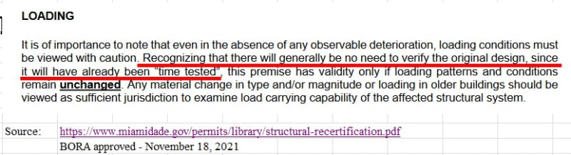

I've added some underlining, please note this is the current language. 2021.
You can track this back to 2013, if you'd like: https://www.miamidade.gov/permits/library/structural-recertification.pdf]structural-recertification.pdf[/url] from Archive.org, 2013, the language isn't all that different.
The Surfside document archive is here:

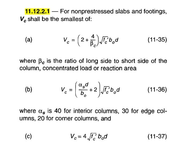

Source: ACI 318-95 (not the right code, but it's something)
I don't have quite the right ACI 318 for this one, I've posted links to a few of them that are in public domain (archive.org) over in the FAQs for concrete.
