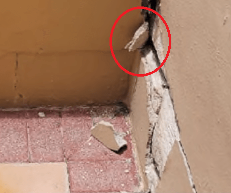

The red ovals have been IDed as elastomer, possibly from a previous repair.
@SFCharlie, you were right. I found another image that shows the lower feature, I had thought was a root or branch, from the side. It is clearly part of the stucco.
I still think the top of the long planter wall is tilted inwards towards the plants and that explains why the section above the horizontal crack doesn't have additional exposed cracks, because the inside edge is acting as a hinge and all the weight of the wall remains supported. There is no need to lift the weight of the wall, so if a root or branch was growing through the vertical crack it only has to tilt the top the the wall.
It’s hard to imagine a retaining wall tilting toward pressure as it fails. Moreover, sudden vertical vertical or horizontal retaining wall damage is very unlikely to be caused by root systems. In my experience, root system damage is slow and inexorable, causing retaining walls to bulge. If any tilting occurs, the retaining wall tends to tilt out from the top.
St. Louis has historic neighborhoods where many houses have brick or stone retaining walls by the sidewalk that are similar in height to the CTS planters. Those that are failing are most often bulging away from the plantings because the root systems apply slow pressure from behind them and push them forward toward the sidewalk until the bulge starts popping mortar. At that point the wall gets dug out and relaid. There is no vertical movement up or down.
I have also seen retaining walls with a sloping terrace above them tilt outward at the top and develop vertical cracks beside the section with the greatest tilt. This is caused by the pressure of the sloping terrace slowly moving downhill over time. In these cases, though, the tilting section does not drop vertically lower than the sections next to it, and the only part of the wall that might fracture horizontally would be at the sidewalk level.

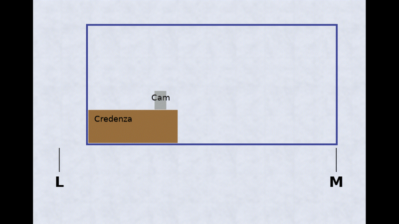

Ring Cam footage and why Column L9.1 (along with K9.1) collapsed first, in simple terms.
To start, I chose an early frame and a later frame, aligning them with the credenza as a reference. Apparently, the camera has shifted slightly on the credenza though it remains in a very similar orientation w.r.t. the front line of the surface (the shift was 7 pixels left/right and 1 pixel up/down).
. Gratuitous spacing 'cause the two images don't sync well.
Consider the 2-D plane of the south face of the building. If Column L9.1 (along with K9.1) fails, the slab could hinge along the Line M north/south axis in turn pulling the two failed bays east. The walls remain vertical, while the floor slopes, forming a trapezoid. The credenza, on which the Ring Cam sits, presses against the walls and gets pushed around but remains a level platform for the camera. The credenza appears to be nudged east as triangulation shifts the floor in front of the camera.
If you consider the transverse orientation, a 2-D plane along Line L, similar trapezoidal action occurs. Given the cam footage, I presume the slab punches at Line 8, moving the hinge to Line 4 and pulling the two bays to the north. The credenza remains with its back pressed against the south wall in its original orientation so the camera appears to tilt forward as the south portion of the unit leads the descent.
As I said, in simple terms.
