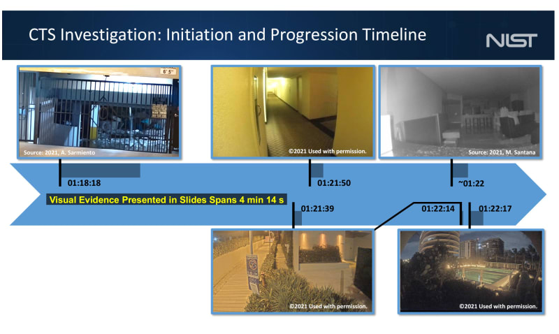

Maude, here is the latest timeline time stamps showing the initiation of the east tower collapse at 1:22:17 AM, and the time stamps of the related security cameras, including the new security camera video they acquired in December, from the 87 Park condo next door, looking down the beach access boardwalk along the south side of the pool.
They also show the time stamps of the security camera from inside the corridor.
Do you need to adjust any time stamps on the spreadsheet based in any of these latest times?

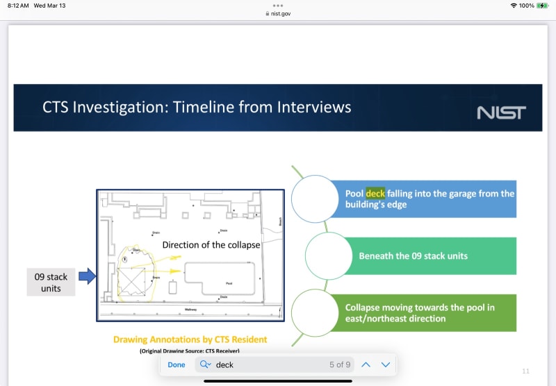

From a witness statement perspective, among the most helpful images were those of the engineer Paolo Longobardi, who apparently drew his perceptions of deck collapse origin and progression as viewed from Unit 309. We had already captured his verbal description on the spreadsheet, which for some reason NIST claims was not reported in the media.

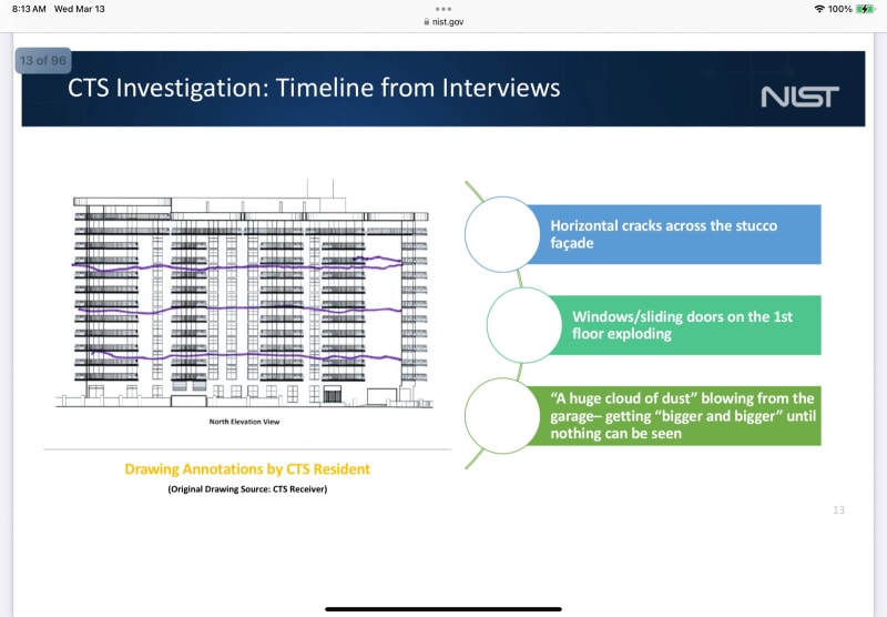

New to me was the description of horizontal cracks in the building facade and the first floor glass exploding. I can’t tell whose observation this was, although the likely witness is Paolo Longobardi, or exactly when this observation was made (after the deck collapse? It’s confusing because the Longobardis were evacuating via the east staircase.) I will try to figure out how to add this to the spreadsheet.

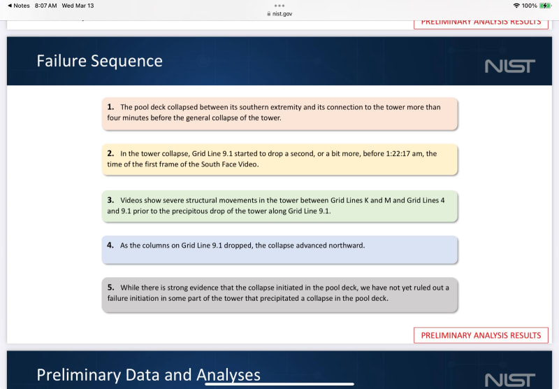

Here is the current NIST failure sequence slide, which relies strongly on the synchronization of all the videos they currently have on hand.
