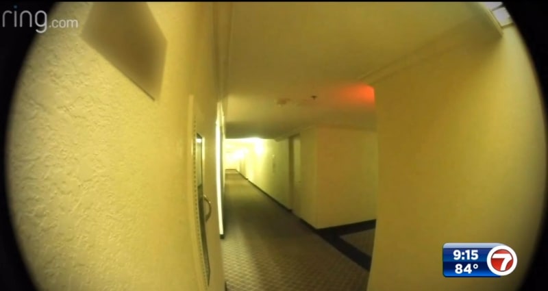

The new Ring Camera video/audio is clearly from an xx5 view of the hallway, and it is the hallway that collapsed. So this clearly shows that the audio of the collapse is laid over a freeze frame of the Ring Camera video (post-production manipulation). Otherwise the video would have shown the collapse happening. Supposedly the actual (full) Ring Camera video does show the full video that accompanies the audio track. Yet another card being withheld.
Thanks for stating the obvious [not sarcastic]. I knew there was something wrong with that presentation but I couldn't put my finger on it. We live in a depraved world when sensationalism displaces news.
It explains the missing motion that triggered the camera. Otherwise it had me wondering whether this was a continuously recording ring. AFAIK Ring mentioned that was a feature that would be available some time ago (for a fee). I was not aware they never came out with it.
Looks like you agree with me.
Nukeman948 2 Jul 22 16:22 said:
It was located at the doorway to an x05 unit looking straight down the hallway of the part that collapsed.
The frozen frame is a possibility, however we know that the building was making plenty of noises prior to the actual collapse. I believe the audio is of the sounds that the building was making before the actual collapse and not the collapse itself. It seems to me that the actual collapse would be much louder and have a brief pause before the eastern part fell.

1) The ring video from 711 is much longer and shows the building crumbling and twisting in the moments before the collapse, but is without audio. This audio would fit over that video nicely.
2) Ileana Monteagudo in 611 saw a crack developing through her living room wall and still had time to escape. While she didn't report any sounds associated with the cracking, I'm sure it was making sounds like in this recording too.
3) Ring cameras require motion a certain distance from the camera to activate them and will continue to record for some time after all motion stops. Is it possible for the video to freeze while the audio continues to record? Isn't it also possible that the motion that triggered it stopped and it still recorded for a few more seconds?
I already admitted that the video was edited but this audio is still valid information of the sounds before the actual collapse.

"It is a shame that they superimposed the building collapse video over this video for dramatic effect, but there is no evidence that the audio has been altered."
Listening to the audio track that accompanied the "new" Ring camera video freeze frame, it sounds to me as though the collapse is in its early stages, and begins to accelerate as the clip progresses, like a snowball rolling down a hill and getting larger and larger, but then the audio fades out, just as the sounds of the collapse avalanche is building. This clip is in mp3 format - not sure the link will work as it is not a image, just a file.

Thank you, I corrected my post. My point was that there were settling sounds and motion for a period of time before the collapse long enough for her to escape. I was responding to sgw1009's comment: "Otherwise the video would have shown the collapse happening."
The silent hallway as she left implies that it was not one continuous collapse but was settling in stages as it failed, also confirmed by Cassie Stratton's phone call. That means that the new video could have been either the first or second settling event.

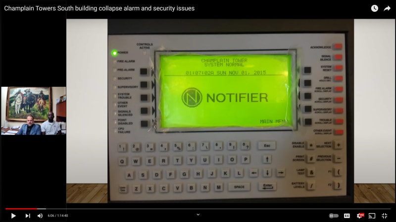

Fire alarm systems are used for other emergencies now and the damn thing didn’t even sound and had some other fault. So yes, they are definitely liable for a part of this tragedy.

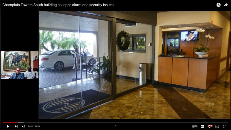

Champlain Towers South building collapse alarm and security issues
Folks, you need to watch this video that just came out a few days ago! See 3 screenshots I made below from this webinar
This is a Webinar with a lawyer interviewing Matt Haiman from Premiere Alarm Systems Elrado Ellis, who Installed the fire alarm system at Champlain Towers, and why the alarm never sounded. Has lots of clear photos, and they go through the log clearing things up.
Most damaging info was that he repeatedly emailed Scott, the property manager of CTS to pull the CPU before they imploded the surviving part of the condo, as it was intact and in the security desk area in the lobby. Scott replied back 3 days later that they never pulled the CPU.
Maud you may want to update the timeline spreadsheet to show that the fire log here actually shows the 911 call from central alarm services being placed to 305-595-1201 (Miami Dade Police 911) at 1:16:27 which is the same time as the lobby phone call that you have indicated on the spreadsheet.
He mentions Champlain Towers turned down the automated capability of the fire alarm sounding the speakers in the bedrooms for evacuation because it was too expensive. CTS had their system set up for human intervention to hit the all-call button, but we know the security guard Shimoka was not trained on i. He said Miami Herald blamed alarm company but he showed the alarm was functioning and did everything it was supposed to. His testimony was so good in the deposition, that it was used against Securitas to get the $500 million settlement which is why Securitas paid out the max on the insurance policies.
He gives a lot of great info here, and his feelings after being deposed for the settlement, and some speculation. But I am working on a video today to discuss this, and some of Matt's implications. Show photos all over inside, some of which we had never seen before.
