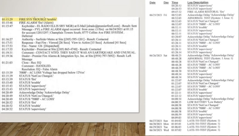

MaudSTL said:
If the all-call did not have a recorded announcement, then I am not sure what one of the survivors from the west part of the building heard after the collapse.
That announcement could have been made by a firefighter at the annunciator panel.
Normally, tones and a pre-recorded message will repeat until it is acknowledged/silenced from the panel while the strobes continue to flash until the system is reset. The system can not be reset if any device is still in an activated state. If the panel receives an activation from another initiating device, the message starts again for all zones with an activated device. So someone on the 8th floor could have used a pull station or a smoke detector may have triggered from dust to start the message they heard.
With most systems, to use the "all call" function you need to push a button to turn on the audio amplifier in the panel and then there is a series of buttons, one for all floors/zones at once (all call) and individual buttons to activate each floor/zone individually as needed. Then you may need to push the button on the microphone to talk.
Without the detailed system log from the fire alarm CPU, we will never know what actually happened. The Central Alarm log, which is shown without the entries prior to the 1:15:29 Trouble code, sheds no light on why some survivors heard alarms and announcements after the building collapsed at 1:22.
Here’s the Central Alarm log image from the alarm contractor’s presentation. I would like to see the entries prior to 1:15:29.

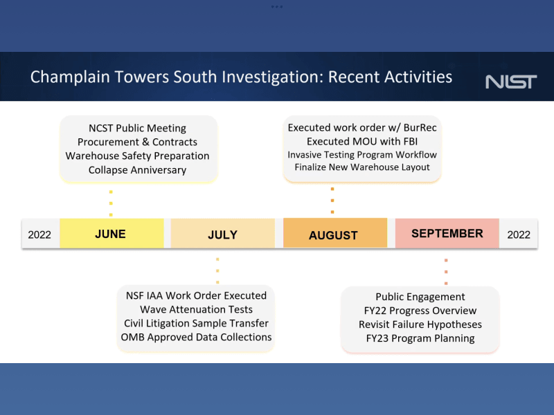

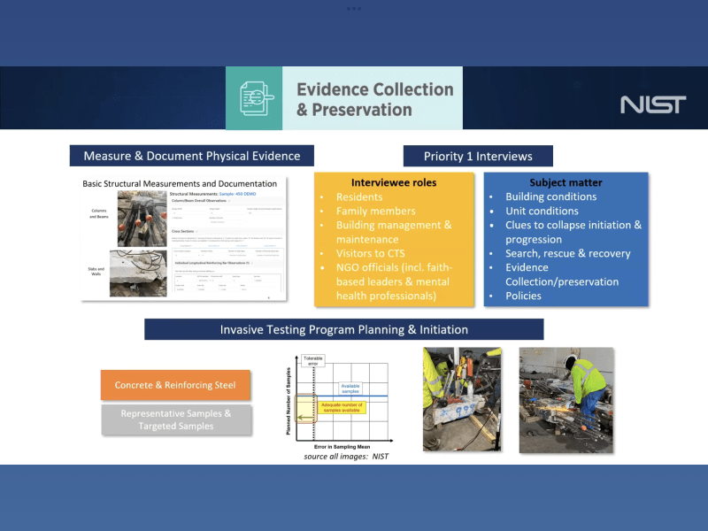

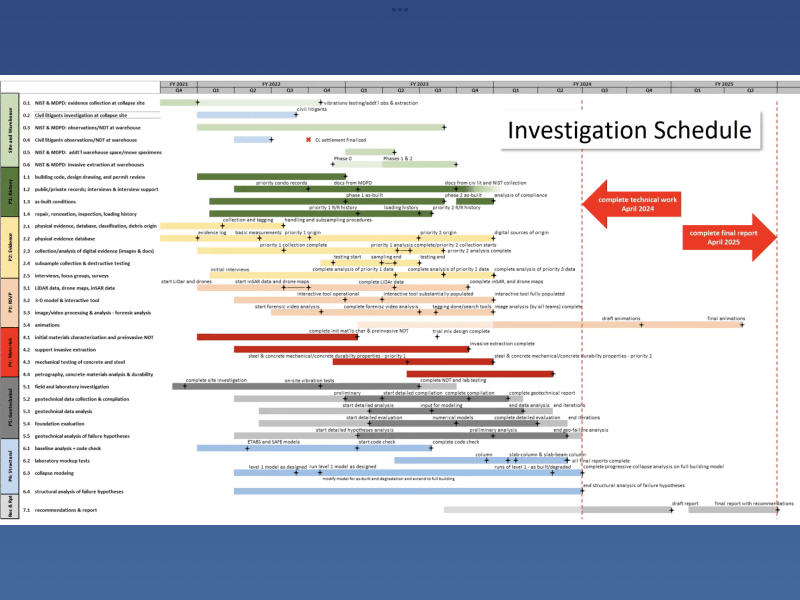

Here’s a high level view of what NIST has accomplished so far. They are doing a lot of interviews, and have also received expert input from two of the major civil litigants. As I was never able to interview anyone, I am really looking forward to the refinement of the timeline I made from published reports.
NIST is having to slip its schedule six months because they have been having a hard time in Miami-Dave’s hot real estate market obtaining adequate warehouse space to work safely, and also because they are challenged to complete their contracting processes any faster than normal. So we are looking at completing technical work in April 2024, and final report by April 2025.

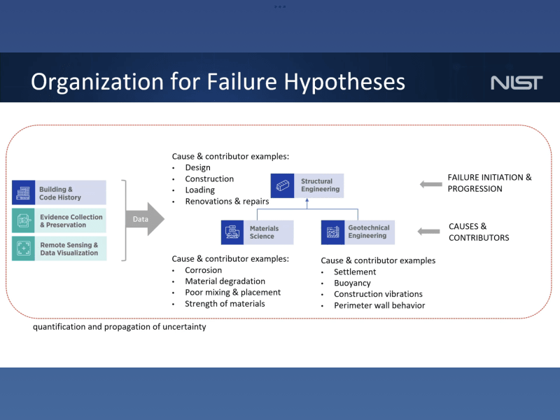

NIST is still considering 24 failure hypotheses. This slide shows half of them.

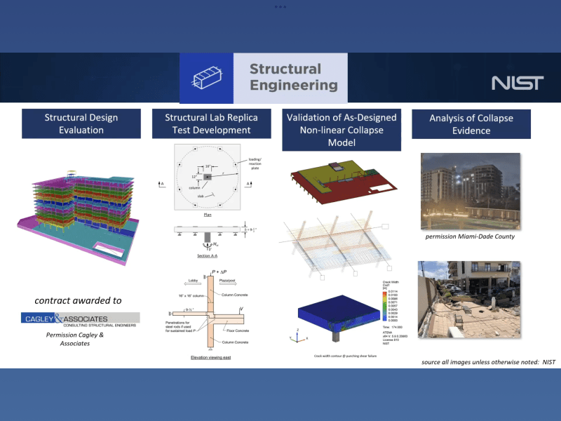

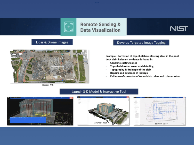

NIST is using these and other inputs to build out the model as a container of all data.

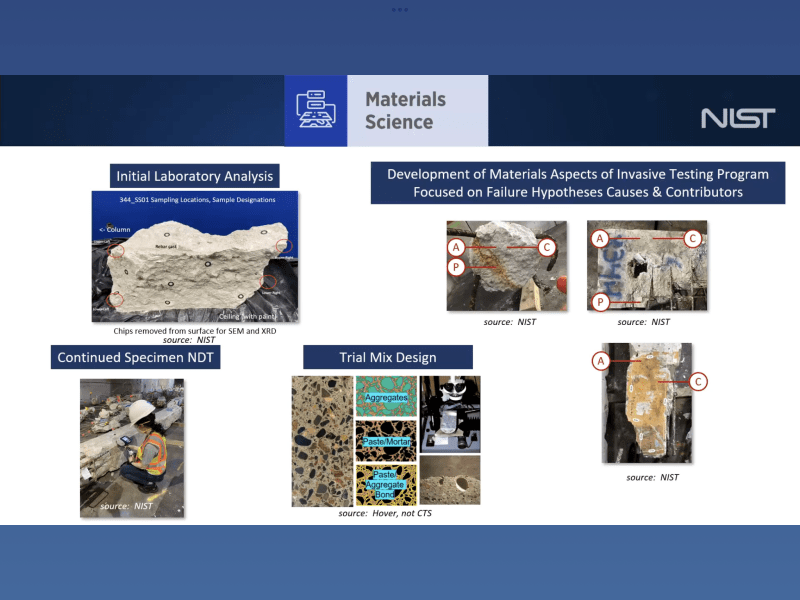

The warehouse space problem is hampering invasive testing. They have no room for their core samples.
During the Q&A following the presentations, Don Dusenberry of ASCE criticized the level of detail of the modeling. Glenn Bell explained, in essence…these are my words, that the building was a system and it was premature to ignore portions of the system without adequate data. He added that when they feel they have adequately defined the collapse sequence they will be able to target the level of detail in the model appropriately.

NIST has identified the actual source of aggregate for their test mixes.

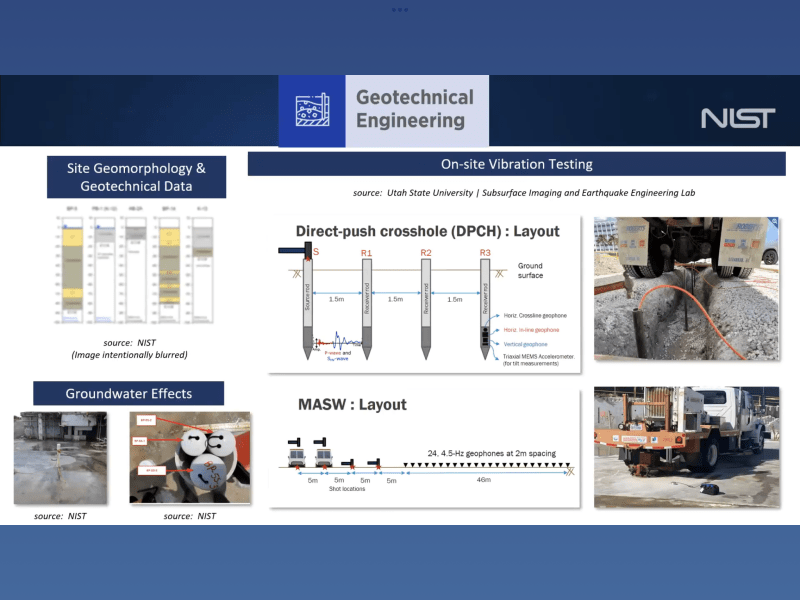

The truck that they use for MASW is called the Thumper.
Carley and Associates is working on structural analysis.

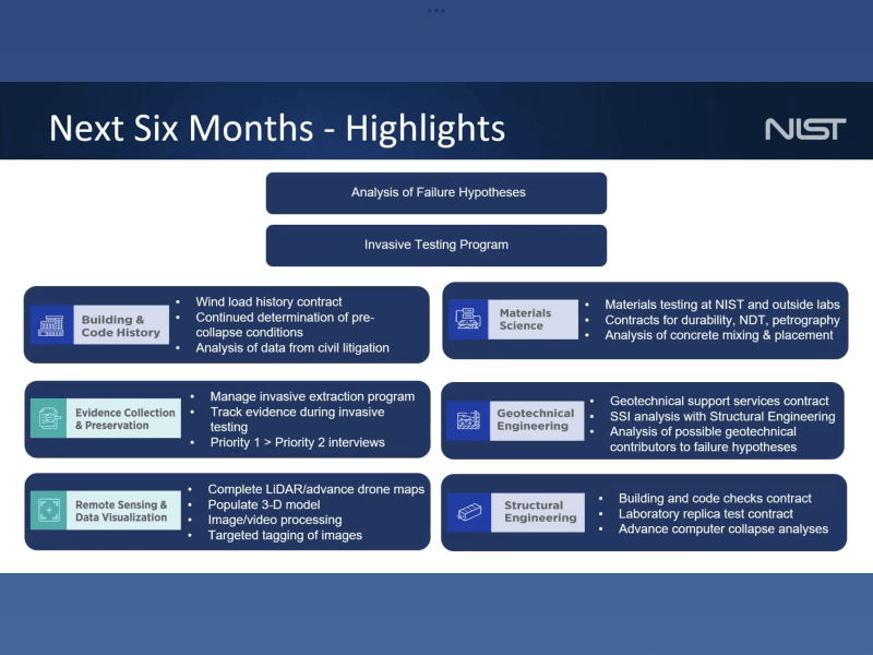

This is a snapshot of the path forward.
