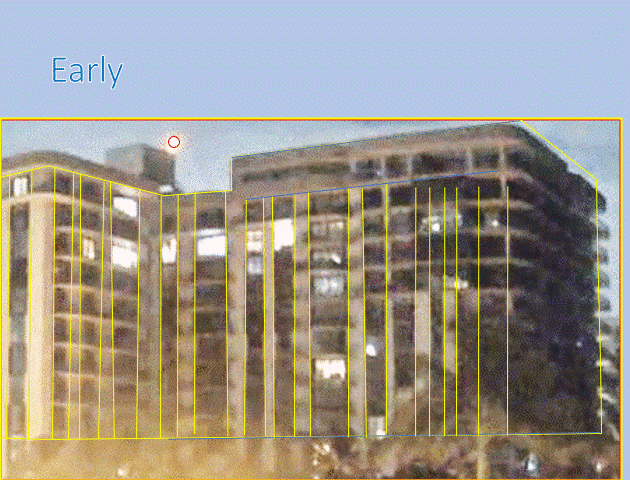

SFCharlie, as I review the issue of the column buckling, I've realized the line you pointed to is CMU infill between column lines. The column lines are associated with the broader infills, not the narrow ones.
SFCharlie (Computer)(OP) said:
said literally nobody...

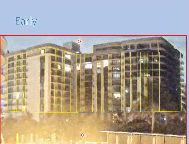

au contraire. So to be clear the penthouse roof is seen hinged down with the far parapet visible. I don't think this quite as discernable before this enhanced image that I can recall. I believe I tended to think that was how it was but it seems clearer now. Or looking at it with my eyes crossed, does it appear the penthouse tilted north? I think the former is the most probable case. It would seem to be one or the other. Does that affect my vision?
Yes, That why I put "columns" in quotes, I was typing architecturally, not structurally. The CMU (cinder block in my time) explains why it went all wibblily wobblily, but does point to the distress the east portion of the tower was under.
SF Charlie
Eng-Tips.com Forum Policies
To me, the "façade" (palisade?, south parapet, what ever) of the penthouse appears to have fallen straight down one story in the "late" frame...???

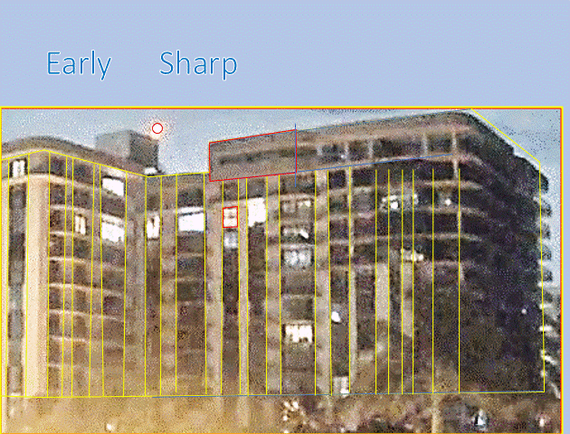

Couldn't help myself, did a little sharpening in the gif above...
That's what I was trying not to see. That was not what I was thinking I should see. What accounts for the appearance that the penthouse looks like it is leaning/moving north?
Edit. well I thought of something anyway. That' a thin section of the penthouse. It's not too much to think that the east wall of the penthouse would fall that way at that location. South wall of penthouse falls north. I don't think it's that significant. The forces that are pulling that way are possibly related to the mode of the roof failing. But that is a guess.
I think y'all are trying to extract very precise information from an extremely imprecise source.
You're never going to get precise information from the low resolution, low framerate image produced by a camera at an unknown distance with unknown optical aberration and parallax characteristics. Those images are a general guideline, not more.
