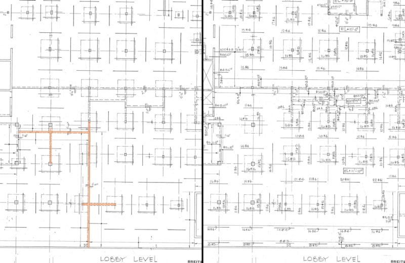

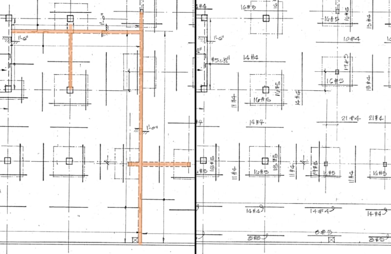

There was an important design change made in the months that the building was under construction. The change was sent to the EOR for approval. In effect the change removed a step-down of about 4"-6", as I recall. The architect or builder wanted to flatten this step down. When the design change was made, it essentially removed a beam which would have had 2 pieces of rebar, top and bottom. That area was revised into what became more of a "slab" than the beam it had been. This was in the exact area in the parking garage where sagging and water leaking had been observed (and patched and painted) for decades. There is no doubt in my mind that the deterioration in that slab was the location of the initiation of failure for this building. All other construction errors, like rebar spaced further than the design specified or fewer bars than shown on design drawings, might contribute 0.5% to the collapse; the removal of a beam such that a slab transfers load that it is not designed to support -- not by a long shot -- has to be at least 99.5% of the cause of collapse. This design change was probably sent to a junior engineer to review and approve. Not having designed the structure, the engineer may not have recognized the significance of the change. [I admit that the "junior engineer" idea is speculation. Paper records other than the designs on file with the county have undoubtably been trashed by now, and all people involved are likely dead (over age 75 or so), so we will never know what transpired in the design change process.]
The step beam and beam type A deleted from plans stamped 1981 vs original (1980). This was noted a long time back in this topic. Are these beams present on the North Champlain Tower? Maybe this was mentioned somewhere in the past 18 pages. If so it's one less reason to be overly concerned about the other site. I think they are taking measures to improve the punching shear.
Comparison of original design versus revised build copy with removed steps and BMA's highlighted.
Undoubtedly, the removed features would have reinforced the broad area of weak slab and offered some interruption between the pool deck and lobby parking. Is it wishing to much for NCST to study this aspect of the failure, that is how well are significant revisions evaluated prior to approval?
Note: The pool deck slab was raised one foot with implications towards garage clearance, building height, or excavation requirements.
