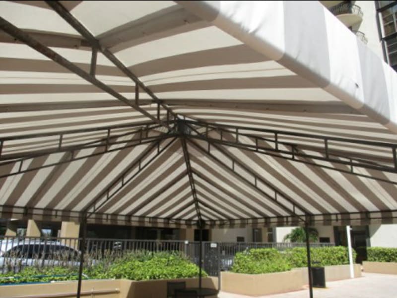

Have you folks seen this photo before? It is the view from under the cabana tent on the pool deck of Champlain Towers South, taken around March 2020, facing the now famous planter that developed the serious cracks just weeks before the condo collapse.
I don't recall seeing it. Do you have a full crop of the lower portion or should we admire the stripes?
Is the pipe along the planter some type of mist cooling system?
No I believe that pipe was draining directly from the planter and down into the garage where it goes into some other main water collection point
Have you noticed anything out of place in the photo? Where did you come across it?
The photo came from a March 2020 report on the HOA reserves. The pipe running along the front of the planter is definitely out of place to me. This says that maybe the as-designed drainage pipe underneath on the garage ceiling was not doing its job so they rigged this ad hoc drainage pipe to run along the front of the planter to bypass the old drain. That is my hunch.
