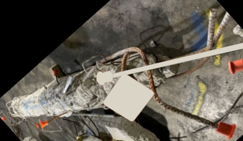

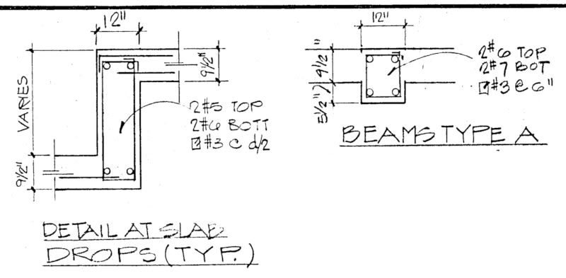

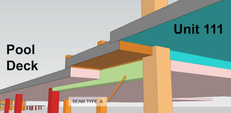

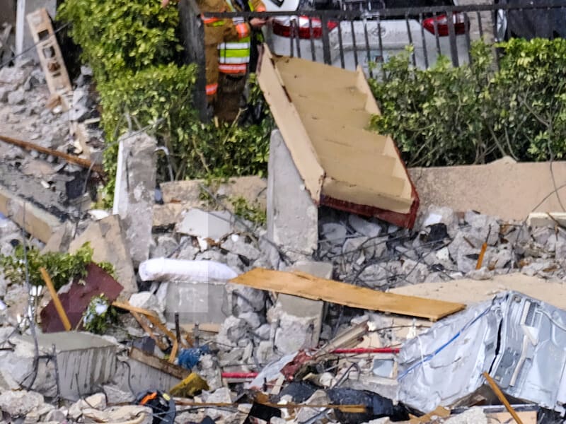

Gary Klein presentation talked about how building end of the Beam A's was not attached to the column properly. I'm still curious about the deck end of KLM 11.1.
K 11.1 was the only one of the three visible after the collapse (left center of pic). I see the top rebar which was connected to the deck, but no rebar below that where the Beam A should have been connected. I'm thinking that there must have been some sort of improper connections at that end too for the deck collapse to have been able to take the beams don with it.
Reverse_Bias (Electrical) 31 May 23 03:15 said:
... no rebar below that where the Beam A should have been connected.
Excellent point!
BMA's are only 5 1/2" deeper than the slab at line 11.1 and could have been nested between the column/slab connection rebar. In the recovered specimen, it looks like the end that rested on line 11.1 (the far end in the image) is void of concrete which allowed it to slip off the column support. If so, the surviving column presents as expected.
