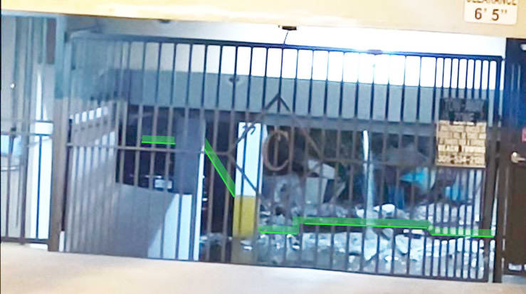

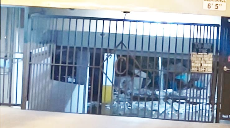

So I bounced back to the garage video interpretation and came up with the following. The green line represents underside of fallen slab while the shading represents slab thickness. The dark areas beneath the green line are shadows where the fallen slab does not rest flush on the garage floor. On the left side of the image, the slab drapes over the vehicle. This implies a clean deck slab break at the tower perimeter, as expected.
The second image is an unmarked copy of the first. They are taken from the June 2022 NIST presentation with the contrast/brightness pushed.
P.S. The missing column might be partially visible as the light patch at center-top of the "C", otherwise obscured by the draped slab or planter sections.
Yes, I think the pool deck collapse most likely extended to KLM 9.1 (the southern wall of the tower). M9.1 is the bright column in roughly the middle of the image, with the yellow base. I said at least KLM 11.1 above, as the greater volume of rubble a little further back from M9.1 can only really be interpreted as total collapse. Closer to M9.1, it certainly looks to me like the slab is fully collapsed, but I'm allowing for other interpretations.

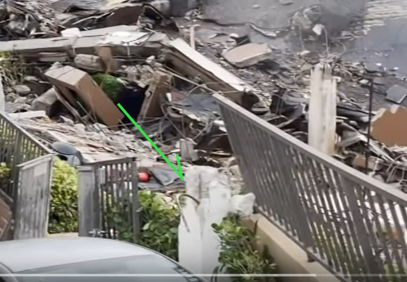

I'm curious about column K15 (I mistakenly referred to it earlier as K14.1). The connection rebar on its north face is not readily discernible in most images so it was either pulled down through the collar ties or snapped off. Either way it is unique in its failure where most other pencil tops just had their connection rebar bent downwards.

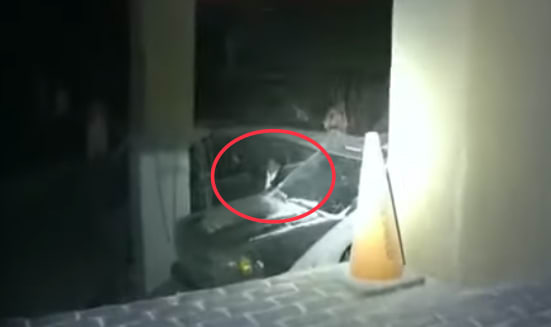

@MaudSTL Thanks very much for the detailed description. I hope you don't mind me adding a couple of additional observations here. In the police body cam video Shamoka states that the lady she is with is also injured. I have not heard any reports of what Ileana's injuries were. I have often wondered at what point the pair of step ladders were placed onto the back of the black Chevrolet Silverado. It appears to me that at some point someone stepped onto the cover over the bed of that truck, presumably thinking it would take their weight, but instead, it collapsed.

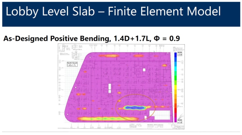

From the WJE Webinar slide

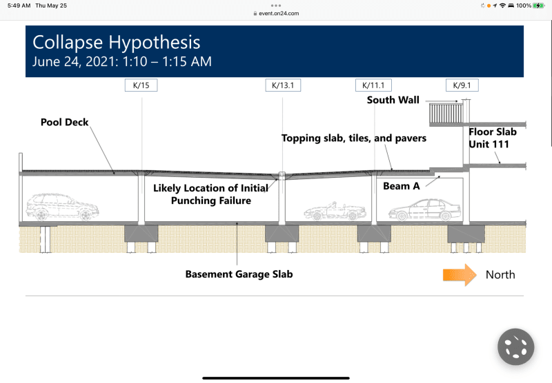

I find the positive bending weakness along the south perimeter an interesting feature. I also owe IanCA an apology for pushing so hard against his theory (part 14 - 6 Feb 22 06:30). It turns out when the structure is analyzed as a whole, the positive bending maximum shifts significantly towards the south portion of the span rather than center span. In fact, it will take abuse from the planter and the parked vehicles, especially a 3 ton truck.
Although I still think the failure initiated from the pool deck, this perimeter weakness could be the explanation for the slab pulling off the perimeter wall in the parking area while transitioning to fracturing along the wall through the somewhat more robust and less loaded pool deck area (three failure zones part 14 - 2 Feb 22 21:07).
I believe Prof. Lehman, who's study was used by Miami Hearld, states somewhere that of various scenarios her team considered, the only one that brought down the building initiated at the south perimeter wall.
Give me some slack on this one because I haven't done anything like this before, but where does the load combination 1.4D+1.7L come from?
No problem Sym, curious what the crowd has to say.
From a quick google search, it seems like this may have been the load factors during the iteration of the code that this structure was designed, rather than the current 1.2D+1.6L.
Those were the DL and LL factors for concrete at the time, I seem to recall... back in 1965, it was 1.5 and 1.8, respectively.

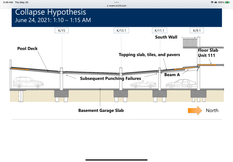

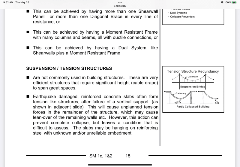

Question for structural engineers. Is it possible that K13.1 punched through, the deck dropped just a bit and then remained in catenary for up to five minutes, and then failed altogether? The reason I am asking this is because I am trying to explain the 1:10 crash heard on the first floor, which was followed a full five minutes later by the deck collapse at 1:15.
Is it possible that the deck could remain in this state for up to five minutes?
Then at 1:15, the punch through progresses rapidly as the deck collapses, crushing cars and unzipping at the south perimeter wall while progressing to the building facade as seen by the Longobardis.
This is a FEMA article I was looking at, showing catenaries in partially destroyed buildings.
