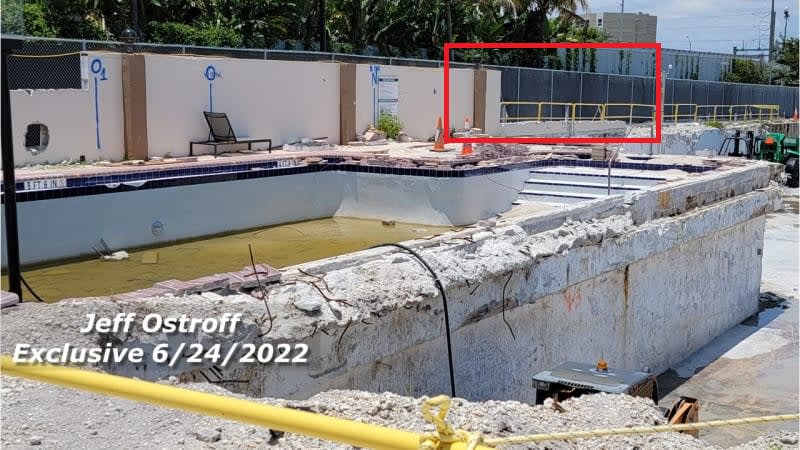

I notice from Jeff's picture above that a large portion of the western end of the south wall has also been removed.

sgw1009, the red box you showed on my photo, the site was like that in September 2021 already long before they started invasive testing.
Yes, you are correct.
No, I'm sorry that is incorrect. For example, please refer to your video that premiered on Nov 6, 2021 (video recorded Oct 26, 2021).
Link
Please count the wall sections West of the pool.
Yes, Sections M and L are missing.

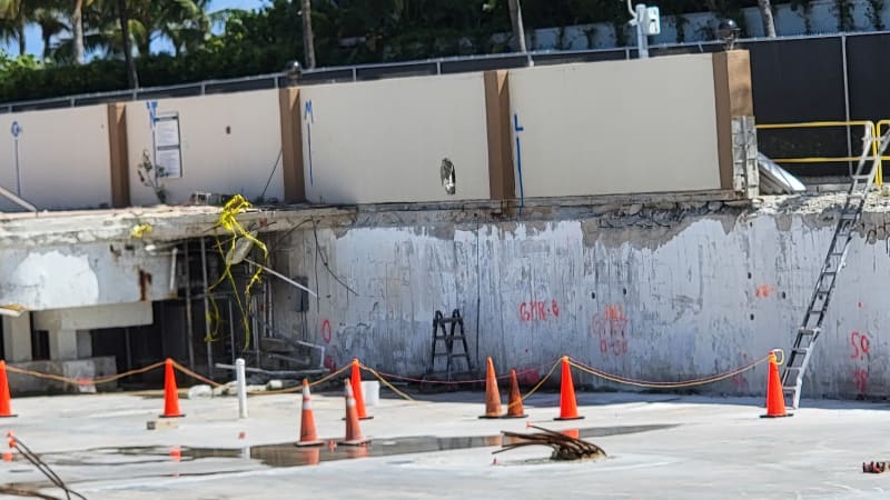

Here is my photo from March 19, when they were still there.

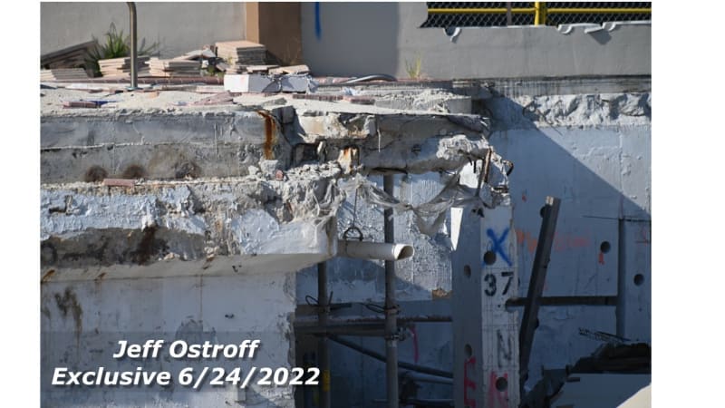

I'll be premiering my video tonight showing all of the close-ups and numerous photographs that I shot at the Champlain towers site on Friday, where we were given access to the site itself due to the remembrance ceremony that they had. But here's a sneak peek of one of my screenshots from the video showing all of the holes drilled right around the pool and the column number 37, look at the top of the South wall where they have taken numerous core samples and then sliced off a few entire panels of the wall.
Thank you for finding and sharing that Jeff, much appreciated.
Thank you.

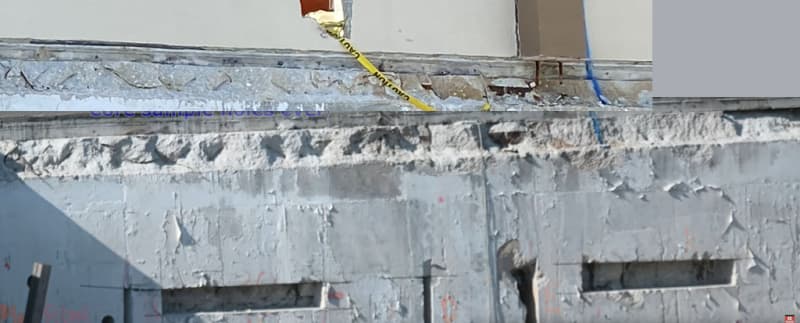

With Jeff's new pan of the south wall, I've done a collage using screen shots to compare the shadowing with the Allyn Kilsheimer images referenced some time ago. Attached is a full scale jpg.

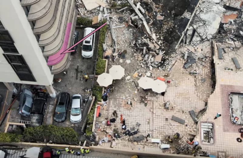

Longobardi's vantage point from their deck in front of their bedroom sliding door, unit #309.
Edit: Just to be clearer, the master bedroom is at the south end of the unit so I moved the arrow.
Oh wow. Metallic crunch could be the cars crushing each other. I was once a service director at a car dealership, and we would rejoice at the metallic crunch of fender benders because it meant work for the body shop.
