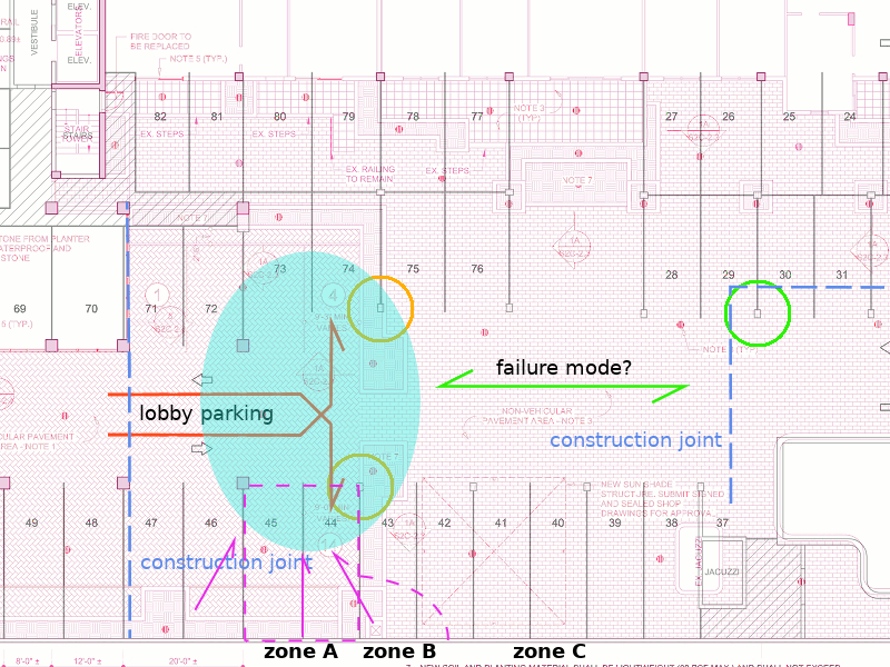

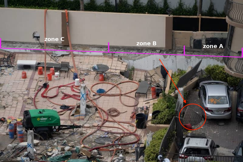

IanCA (Mechanical) 2 Feb 22 07:55 said:
If the initial failure begins at the southern wall, by the deck detaching from the wall...
There has to be a mechanism that allows for the slab to be pulled off of the wall. Either the slab edge moves north or the wall moves south. The wall does not move south so the slab has to move north and the only way for that to happen is for the collapse to initiate further north in the parking area around the columns.

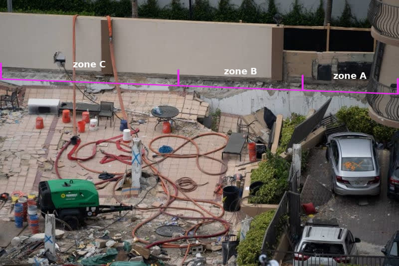

As I've further considered your previous images, I've realized that there are three failure modes along the southern edge and I propose the following:
Zone A: Slab is pulled north off the south perimeter wall​
Zone B: A tab of the greater slab fractures along the edge as it is pulled simultaneously off the wall and laterally to the west as it follows zone A​
Zone C: The slab breaks cleanly along the perimeter wall but does not pull off of the wall​

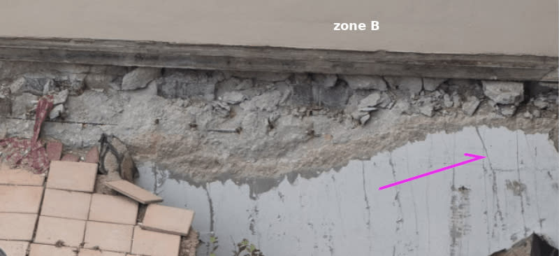

Note the diagonal scratches in zone B:

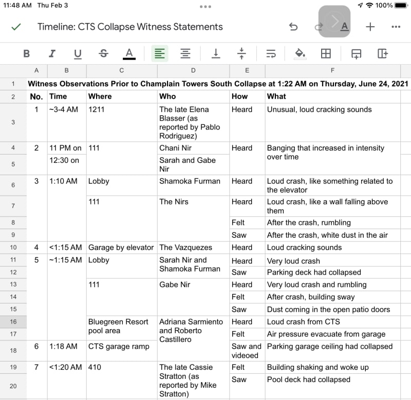

To correlate the deck collapse sequence under discussion to the witness statement timeline, after over two hours of banging sounds heard in 111, the first big crash was heard at 1:10 AM by the Nirs in 111 and by Security Guard Shamoka Furman in the lobby. Is it conceivable that what they heard at 1:10 AM was the the rebar failing as I14.1 began to punch through the slab? If so, could this occur without visible collapse in the garage?
The reason I ask is because the Vazquezes have said nothing looked out of the ordinary in the garage when they parked in the garage and walked to the elevator just before 1:15 AM. Unfortunately, we don’t know what space they parked in, so we don’t whether a small local collapse of a delaminated ceiling layer, if one occurred, would have been within their line of sight.
We do know the Vazquezes heard unusual, loud cracking sounds in the seconds before they got into the elevator. To relate to the theory under discussion, could this have been the failure of the Zone A connection as the deck collapse began?
The Vazquezes were ascending to the first floor when the deck collapse occurred at about 1:15 AM. So the deck collapse occurred within a few seconds of the loud cracking sounds they heard just before they entered the elevator.

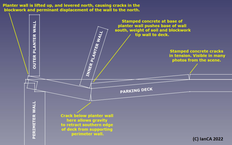

Thanks very much for taking the time to add additional notes.
I agree, and I have attached an image below showing what I believe to be one possible explanation for how the deck detached:
This is a sectional elevation through parking space 45 looking west.
I believe this satisfies all of the available evidence.
Thank you very much MaudSTL for taking the time to summarize the sequence of events in your post at 20:34 and for relating events to the sequence under discussion at 03:11. It is going to take me some time to think through your comments and to try and line things up in time. As you can see in my post at 06:07 there are several places where rebar and concrete could have been slowly failing and causing the banging sounds heard for two hours before 1:10am.
Yes, correct, but there is one slight adjustment required to your plan view, please. Zone A should also encompass parking spaces 46 and 47, and is centered on column I14.1, along with the blue ellipse being centered on column line I.
Thanks again.
I greatly admire your thorough, logical approach. To simplify the correlation of your detailed theory with the timeline, here is a screengrab of the key perceptions for your convenient reference. I understand that we cannot truly know how to correlate all structural failure details with the witness statements, but there does need to be some logical connection between the events proposed in the structural theory and what witnesses say they perceived.
Thank you so much for your efforts.

Along Sym P. le's Diagonal movement of deck, would this portion of broken slab also indicate the diagonal movement?
It would seem it takes punch shear of a column further from South wall than planters, to pull the slab totally away from South wall?
I can see how a break under inner planter lifts the end of slab, but I would expect to see a horizontal crack in the step part of the edge of slab where the deck slab caps off the sheet pile. See IanCA's 1 Feb 9:04 post diagram of as built conditions.
Back to image, does the stamped concrete area indicate we have back and forth lateral movement like the card table situation, prior to punch shear or as columns are punching and creating load transfers?
Or was stamped concrete pushed up in accordance with IanCA's planter fail diagram?
Or is raised circled stamped concrete support IanCA’s planter failure even more. Being slab in circle ⭕️ is pulled North first by drop at planter near South wall?
That piece was pushed up by the column that punched through. Trying to apply more meaning to that seems like a fruitless endeavor.

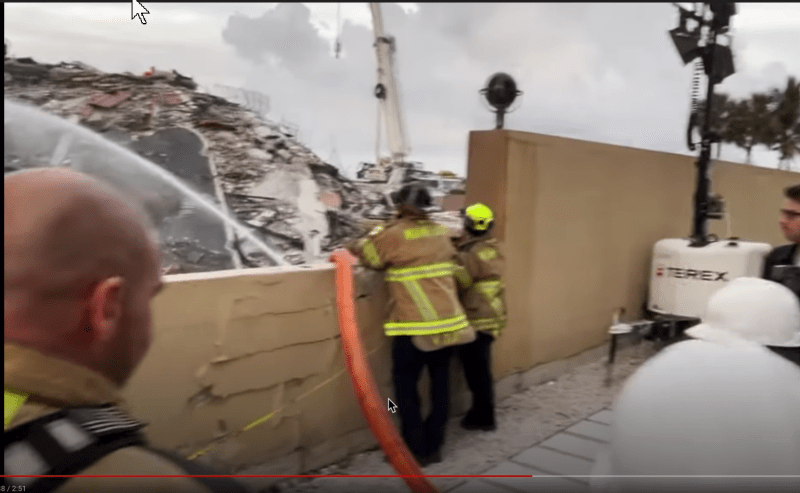

Here is a view that shows the the entire part of the deck that detached from the wall.
The wall behind the parking area showed damage on the opposite side as well.
