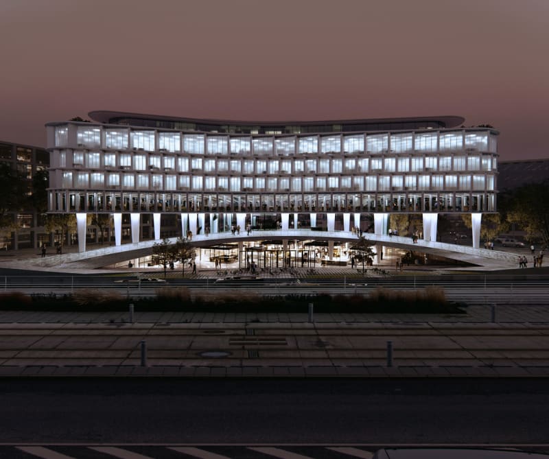

Dorte Mandrup said:
"I am not a female architect. I am an architect"
Dorte Mandrup has imagined 'The Hinge', a landmark transition between the new urban area Aarhus Ø and the historic town.

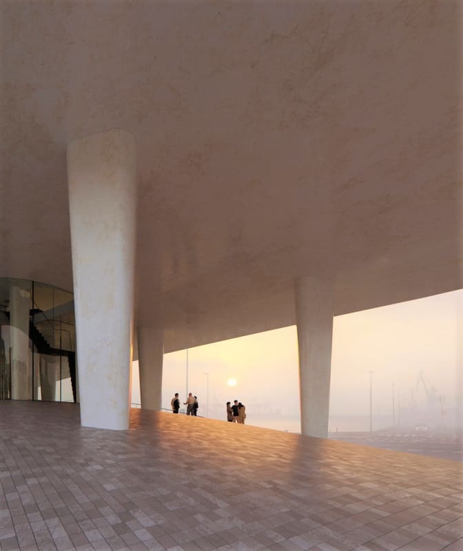

...and speaking of "other weighty matters"...
Another image from Dorte Mandrup's portfolio...
Curved buildings are noted for their resistance to earthquakes because they are not excited by shaking in any one axis.
To me, this image makes a statement that slender pillars can carry immense weight.
Thank you, Maud, for returning my focus to columns that can help protect against slab shear punch-through.
