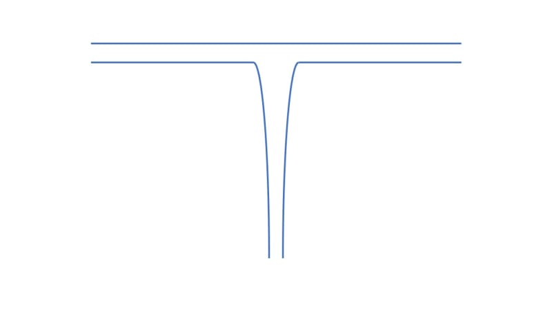

Why no just make beautiful spacious columns?
Sorry, not a structural, mechanical, nor civil engineer...
SF Charlie
Eng-Tips.com Forum Policies
GPR at several wavelengths for rebar and for shallow voids and structures, Small scale seismic (MASW and/or refraction) for deeper investigation. If they have the time and the inclination they could build a 3D model of the subsurface that way, I assume they are just being thorough. Have we seen any indication a pile moved?
Modern construction methods for flat slabs use drop panels for increased shear strength at columns, which is basically what your nice-looking column sketch is getting at, but with less complex/expensive formwork and construction.

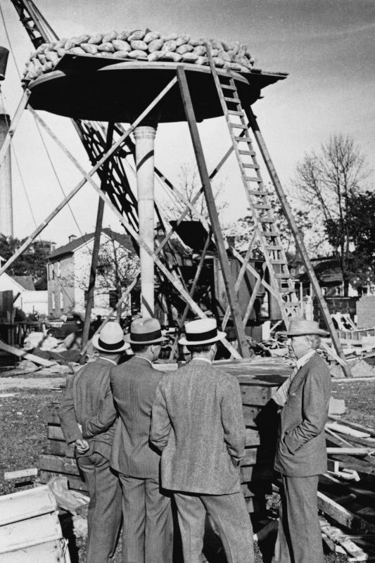

SF Charlie - Your column looks suspiciously like the Frank Loyd Wright columns in the Johnston Wax Headquarters building. I will grant the are visually pleasing, but they pushed the limits of concrete construction way too far.
(I didn't mean to claim any originality for the columns.)
Wikipedia said:
In the Great Workroom, the columns expand from 9 inches (23 cm) in diameter at the bottom to "lily pads" 18 feet (5.5 m) in diameter at the top; skeptical building inspectors required that a test column be built and loaded with twelve tons of material. After the test column proved capable of supporting the specified load, Wright had the load progressively increased. Only at sixty tons load did any crack appear.

As for gracious columns... there's a business opportunity here. The forms rental companies could have standard modular graceful column forms. They could come in standard sizes. Also, they might be only for the top, so the contractor could customize the height.
SF Charlie
SFCharlie said:
...an image would sexy up this thread...
Something like this.
