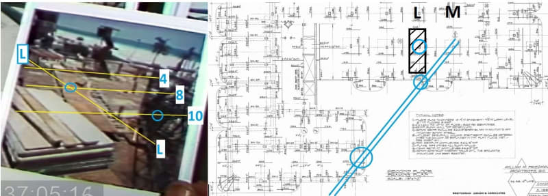

Interesting presentation. Thanks for posting.
If we the "axial compression force ratio" is correctly determined and presented it seems to mirrors the initial collapse quite well.
Same caveat, we can see that the Penthouse addition was not the whole and complete cause.
A "load Ratio" of 1.89 has probably [1 floor added/13 floors total] = maybe 8 % Penthouse and was [1.89-.08] = 1.81 "Load Ratio" to start with.
Of course we do not yet know if this is actual load and ultimate column capacity or factored loads and some % of ultimate column capacity.
But either way it is bad news and the "load ratio" as presented seriously exceeds codes and good practice.

So does column load ratio typically take into account the secondary moments too, in what appears to be a sway-frame RC Design for at least the collapsed portion, in at least the E-W direction? Although it would appear to me, that the lateral displacement would be worse at 2nd floor due to patio deck providing lateral support to the first floor of the building.
Edit: I may have found the answer to my question. It appears if designer decided this was a non-sway frame design, then he would not have looked at secondary moments on slender columns, like you rwould in a sway-frame design. Now it appears this building is part non-sway frame and part sway-frame design to my untrained eyes?
However Wind Loading is yet another loading calculation, and perhaps that would affect sway-frame loading too?
Watching the crane collapse video, it seems like this general planter area really was in the wars. The crane 'collapse' appears to have dropped the elevator wall formwork onto the deck, bending over the column starter bars on Grid L8.
The crane itself seems to have dropped down onto M10 where one can see the planter beam formwork (in other portions of the video). On the way down it also damaged the 2nd floor cantilever balcony at J14.
The west portion of the building appears to have been a floor or two ahead of the east. One wonders exactly where the pour joints were, possibly the podium deck was tied into columns J13, J14 and J15 later.

1) It certainly should address moments. However the graphic plan is titled "axial compression Loads" and that implies the moments may not have been addressed in this study.
2) Design for RC columns should address some minimum incidental moments, such as perhaps 5% of column dimension - perhaps 10%. As addressed prior, the shear walls are minimal at best and act in one direction only. The columns should have been designed for hurricane winds and that induces moments in the columns.
3) A lateral design with columns resisting shears from wind or seismic generally creates a point of inflection in columns that is at about the mid height between floors so shears in the column create (lets say) clockwise moments above the slab and likewise below the slab, and those additive moments have only a slab for resistance in this flat slab system.
4) The flat slab has column strips with reinforcing concentrated in those strips and which act as beams to support loads and moments. The cantilevered balconies provide negative moments at exterior columns to balance some of the loads from within the building. There are conditions where a c olumn exists at the edge of the floor area without a balcony, and the negative moments from the slab have only the columns for resistance. So the vertical load only can induce moments in the columns due to unbalanced floor loadings or locations, and the reinforcing must be detailed for development - and this can be difficult in thin slabs.
5) it appears this building is part non-sway frame and part sway-frame design As you stated correctly, in one direction it has some help from shear walls (not much tho) and in the other, the columns are all there is. And yes, the wind load design is additive and impacts the design of columns and slabs. Thus the beefed up reinforcing for the Second Floor slab due to the addition of the Penthouse.
If this happened in calm winds, think what the next hurricane could have done.

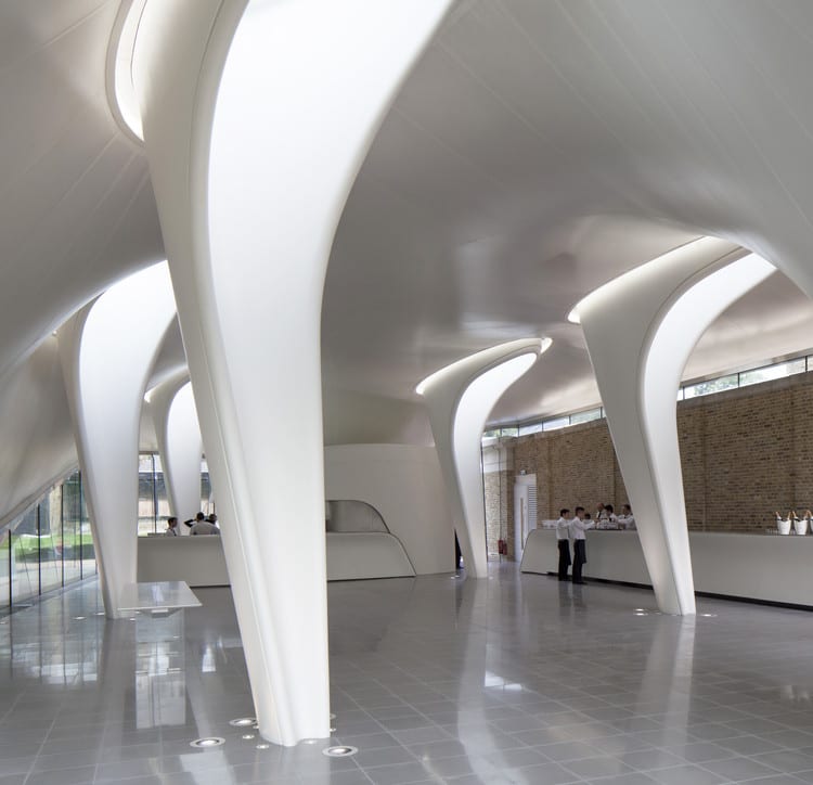

What would you call that 'Column' of Water in your image?
This is more my idea of a fluid column...
The_Serpentine_Sackler_Gallery_-_Zaha_Hadid_Architects_-_ArchDaily_ZHA_Serpentine_Sackler_Gallery_08_wdahiz.jpg

Logical follow-on question is how do you design SFCharlie’s fluid/elastic columns in one direction, yet use a more rigid shear wall in the other direction/plane without some sort of flexible or adaptable isolation coupling in sway frame direction with shear wall? It seems the fluid movements in one direction would be constantly clashing with the braced direction.

I don't think the columns are flexible, but if you would prefer something easier to calculate...

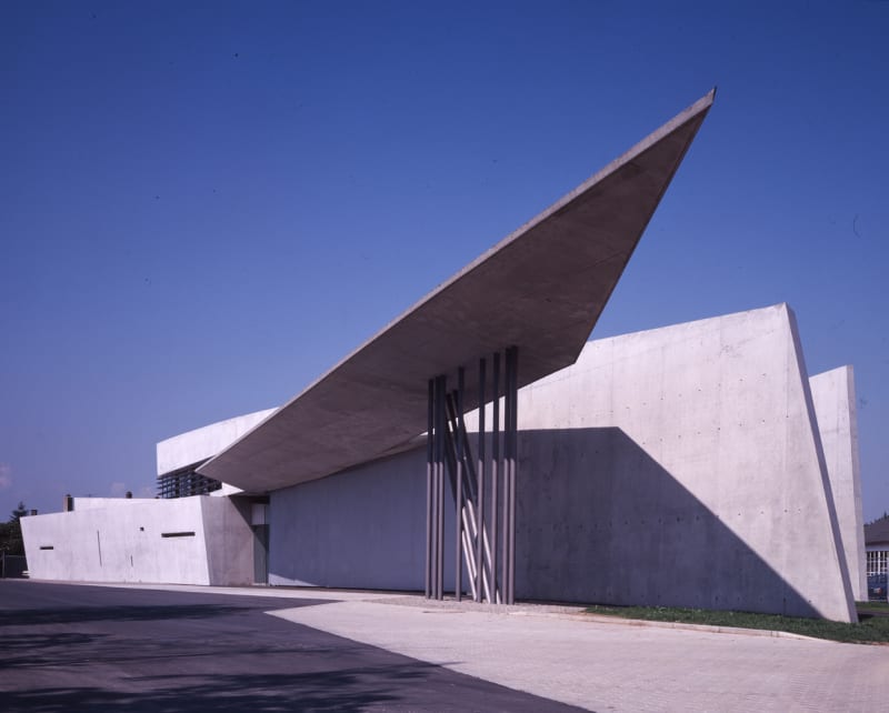

Spikey - AD Classics: Vitra Fire Station / Zaha Hadid
archdaily said:
Although Zaha Hadid began her remarkable architectural career in the late 1970s, it would not be until the 1990s that her work would lift out her drawings and paintings to be realized in physical form. The Vitra Fire Station, (1989)

The 'fluid/elastic' columns are in London, worst seismic recorded is 3.9. When concrete goes fluid it has fractured and it is all over. Lots of confinement reinforcing is needed to keep the concrete inside the reinforcing cage.

The museum 'fluid/elastic' columns likely have different stiffness in each of the possible different directions and with rotation each column is loaded at a different direction.
