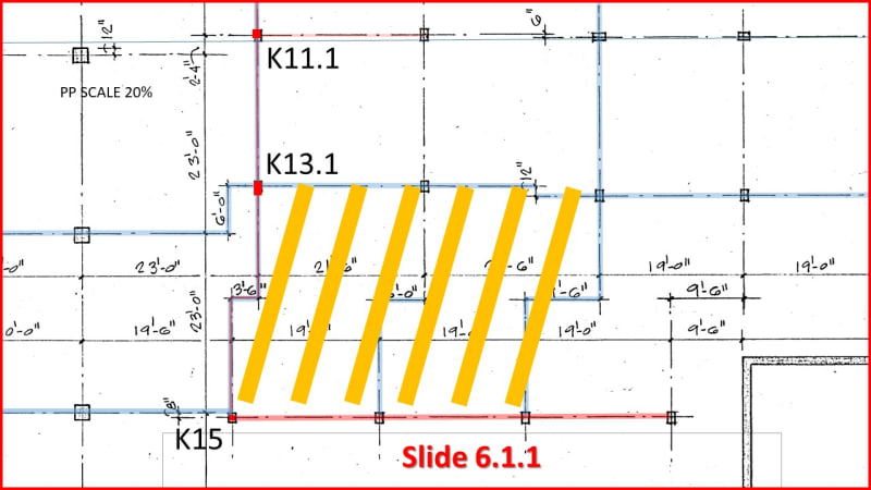

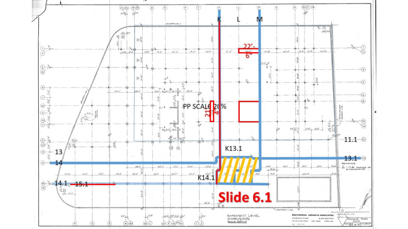

Only columns K11.1, K13.1 and K15 would seem to be subject to enough cyclical loads to suspect fatigue failure.
I'm confused by your column nomenclature, Maybe I'm using the wrong sheet?
Overheads_of_debris_pile_at_end_of_ramp__zoom_with_slide_in_lower_RH_corner_-_6.1_r9ivsr.jpg
SF Charlie
Eng-Tips.com Forum Policies
It looks like you are using Sheet S2 of 14 revised Jan 17, 1980 and titled Basement Level Dimensions. On the bottom left, I see a grid line marked 14.1 and one marked 15, shown as being about 12" apart. I don't see one marked 15.1. I used sheet S2C-1.0 from the Morabito documents dated 4/26/2021 and titled Level 1 Slab Reinforcement and Framing Plan. It was page 11 from the pdf. I uploaded it in my post above on 20 Aug 21 at 03:51.
The distances between grid lines marked in different blueprints don't match, but I haven't found a grid line marked 15.1. The west-most (i.e. bottom of the sheet) 12" by 16" column at the end of the valet and visitor parking area is offset to the north from grid line K. The vertical grid line for that column is not marked on that sheet, but it would be between I and K, but very close to K, so I am calling it K15. I had to measure very carefully, but I believe that column lines up with grid line 15, and not 14.1 (on the Morabito sheet). The sheet you are using shows 12" between 14.1 and 15. The Morabito sheet shows 8" between 14.1 and 15.
There is also an error on the left hand side of the Morabito sheet where 23' is indicated between grid lines 14a and 14.1, but the actual distance shown on the blueprint appears to be 16' 9". Trying to figure out the distances between columns is a nightmare. There are unexplained differences between blueprints. The whole thing is a dog's breakfast.

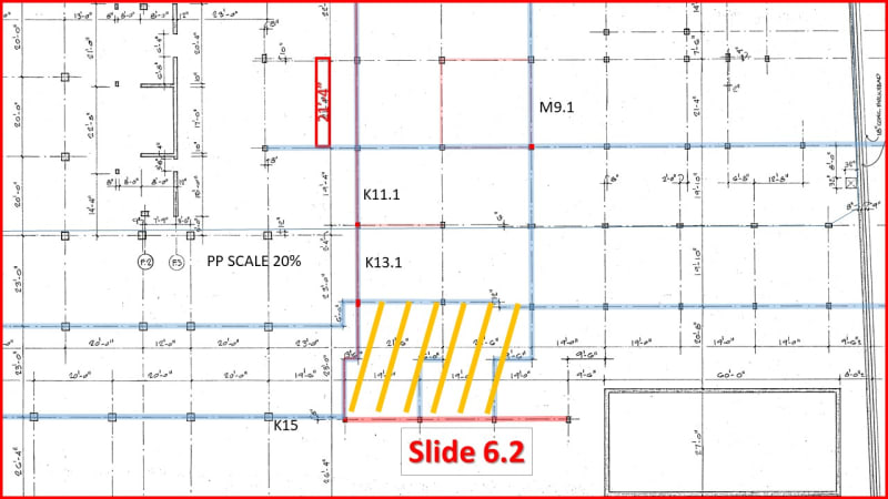

Red Corona (Computer)24 Aug 21 19:06 said:
so I just read the top part...
...to me it still seems like something internal around M9.1 failed first
For more from the text see the attachment above.
M9.1 Located:

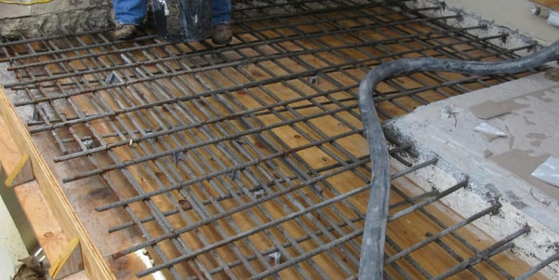

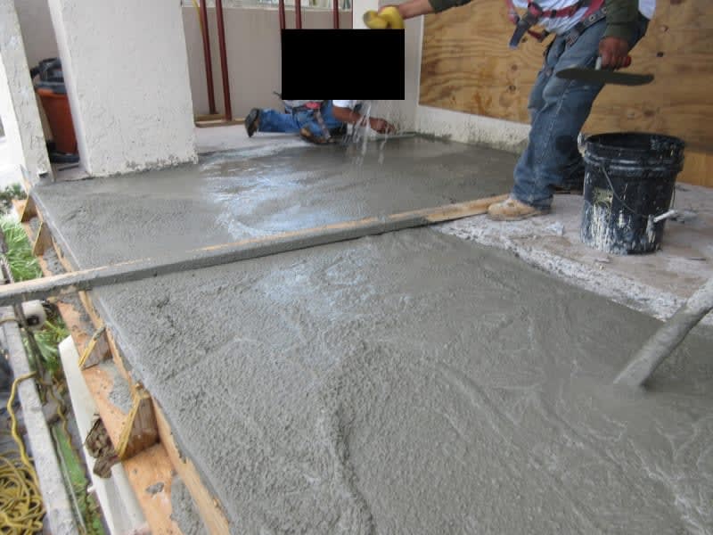

I just watched this video by Building Integrity about "delamination" leading to the pencil head columns observed after the punching shear. He also pointed out how the cores were fractured.
How prevalent were concrete pumpers in 1980s Miami? When you are mixing on site, you may run out of time doing a large slab. In that case, did they pour the bottom half first and then come back the next day to finish the pour? Could that have led to "delamination?" Just a thought.
Yes, I believe there were instances of that.
The 1992-1997 and 2003-2009 (this was a long project with firm/contractor changes) concrete renovation to the pool deck is a lot of the major delamination we saw. Large portions, especially under and around planters, had full or partial depth repair work. There was about 14,000sqft total of repair work done to the top and bottom of the pool deck/parking roof slab. This is also where the failures in waterproofing and rebar placement seem to come from, rather than the initial construction. At least in regards to initial images that sparked the "where's the rebar" question in the first place.
