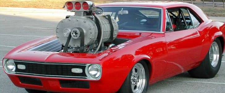

About 30 seconds in, the red car in your video reminds me of the first muscle car era. For Example, I offer this image
More Info: It is actually a Train Blower and he blew head gaskets just blipping the throttle. Not an Engineer Designed Bolt-On! Just a junk yard find, that they decided to bolt on..... Or as they used to say, this was NOT a 'Blue-Printed' System Upgrade for this Engine!
SFCharlie, Yes the HVAC technicians use the compressor on top of the motor to run air tools while on the job! That way they can write off their auto investment! [2thumbsup]
