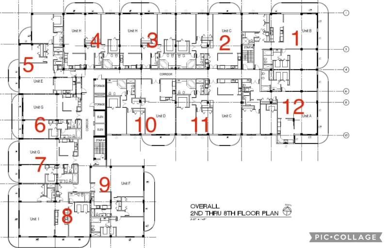

SFCharlie (Computer)(OP)23 Aug 21 02:09 said:
Do we have a floor plan with unit numbers that I missed?
There was one. Start in the northeast corner and go counterclockwise.

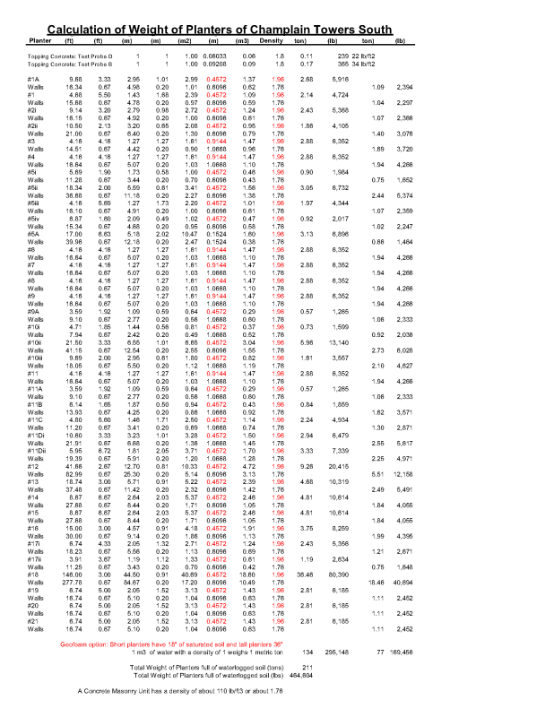

When Demented was looking thru all the maintenance and repairs, one was the tear out of the pool gutter system and installing a new gutter system which appeared to be higher in elevation than the original one. I think when the raised the perimeter of the pool and hot tub, they added probably more sand to raise the patio tiles to match the elevation of the pool and tapered the deck from new pool curb height into the rest of the patio deck. I know in some pictures I have seen, way back in this long thread, it looked clearly like the area around the pool and hot tub was higher elevation, and tapered back into the rest of the paver level on patio deck side of the pool.
I don't think what you are seeing is structural deformations below.
Perhaps Demented has the info handy to confirm my memory?
Correct. That section of slab was original height. Barely any sand was used there to match the pavers. The surrounding areas were raised. Around the exterior of the main building, it was the same. A slow taper that allowed water to collect and pool at the border of the building/deck.
Don't have it handy, but I can dig through the stuff later. However, I did find a series of failed inspections on the rebar placement at that location but it was subsequently approved based on yet another letter from a PE. Same PE and construction firms involved in the other work. Still trying to get as-builts, but those don't exist per the town. I've kinda given up as I've exhausted everything I can dig through being a nobody.
Between the walls falling over in hurricanes, rebar added to an existing design, rebar removed from an existing design, additional sand/paver weight, delaminated slab, epoxy repairs and mortar patching, and pile driving next to that location, I think it's a good location to investigate.
After reading through everything I have, to me it looks like the pool deck restoration work was never finished during a dispute and the pool resurfacing work continued as planned. A 3rd contractor had to come out to fix loose tiles left all over after the hot tub work before the final approval was given by the inspector. Hurricane damage repair work at it's finest.
Planters used to be here too
IEGeezer said:
That would be about 45 inches tall. Where did you get that the big planters were 4 ft by 8 ft. In this picture, they look roughly square as they do in the Morabito Consultants drawing I referenced.
4x8 is just the ref name of them I have seen called out on original drawings and contractor plans. There is a slight chance 1 planter, though I am not sure which one, was built by placing CMU bricks along the perimeter of the existing and the original was demod internally and used as fill. This was around the same time they were modified to 45" tall, which was to replace tapered cracked cast concrete caps.
Also waterproofing was there. Just poorly done and trapped water instead. I'd have to dig up the spec sheets again but we've got the weights there.
I don't think geofoam was used either. I've found 0 mention of it in any of the repairs/rebuilds. Rootballs of old palms and seagrapes were likely left in.
The additional sand and raised/clogged drains on the deck was also a massive area for water to pool up beneath the pavers.

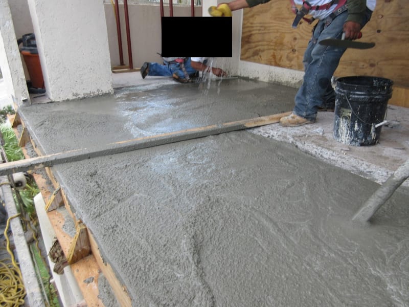

This is NOT a photo of champlain towers south. I'm still told photos of the work there no longer exist. This is partially the same crew that did the work on CTS's balcony, deck, and beam repair. Concrete lab tests were also not done it seems and most concrete was mixed/pumped on site with bagged cement. Processes and work habits typically don't change job to job, especially when the PE and contractor have a relationship.
Concrete experts, does this look right at all? Looks a wee bit wet to me.
It appears no vibration needed with that mix, all the aggregate has fallen to bottom with only watery cream 'floating' to the top?
Assuming there is aggregate in that mix?
Re-defines Layered Pour?

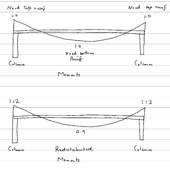

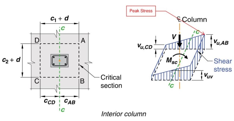

Flexural induced punching failure is also a result of lack of flexural / top and bottom steel reinforcement in the slab. When the deck failed in punching, then initially it just feels as if it failed in pure punching shear and yes it was overstressed from a pure punching shear standpoint, but again it is based on the specified concrete capacity on plans. The punching shear stresses at these slabs is a result of two different components, one is pure gravity shear reaction at the column and other is the moments absorbed by the columns below. So the column at Grid KLM/13 were seeing the maximum stress because of these two different actions. Now the demands (just the weight of deck, pavers and sand) were over by a factor of 30% compared to the "Code calculated capacity". This code calculated capacity is also relatively conservative so that we can account for some construction differences, uncertainty in material strength and so on. So if I remove the factor of safety then the Demand to capacity ratio (DCR) 1.0 and on top of it, this is the peak stresses at the slab column joint when I combine flexural plus pure shear stress. Code doesn't allow a redistribution of these stresses as the redistribution of stress depends on what is the contribution of shear stress at slab column joint because of flexural transfer.
So we know that the capacity of slab punching realistically was okay to handle the daily load if there were enough flexural reinforcement (The reinforcement that is required for the slab to span between columns). If there is not enough top and bottom reinforcement (reinforcement along top / bottom face of slab) in the slab, then it will lead to moment redistribution. Code allows up to 10% of moment redistribution. What do I mean by this?
Now the slab span between grid K/13 and M/14.1 was 28.5' and the bottom reinforcement was not enough to handle the loads so it redistributes the stresses to the top reinforcement at column. And in general it is okay as reinforced concrete is good at that. But in this case, the top reinforcement at column was also barely enough to handle the loads even without this redistributed moments. So this leads to cracking / significant cracking at the slab column connection face. The magnitude of these cracks depends on the actual daily load carrying capacity and not just code calculated. So this flexural cracking because of lack of top reinforcement and its concentrated placement at top of column lead to a compromise in the punching shear capacity of slab. The top reinforcement was also compromised because of failed water proofing and as the cracks stay open for longer, the rebar corrosion also gets accelerated because rebar corrosion is also a time dependent factor. And since the slab was cracking significantly under its own weight, the crack duration can be justified as (almost) the age of the building.
The rebar corrosion leads to reinforcement delamination effects (not the same as coring because while coring concrete can get damaged in the core sample and does often separate from rebar if core is not big enough). With this delamination effects, you get further reduction in punching shear capacity. So, it was the lack of top flexural reinforcement coupled with high unbalanced moments at these column bays that has lead to a flexural crack at the slab column joint which in turn lead to a punching shear failure because the concrete lost its aggregate interlocking capacity and there by the strutting force. This can explain why the pool deck collapse and why it did take as long as 40 years.
Btw unbalanced moments are significant on columns that are supporting different length of slab bays. So in the image above, the slab span adjacent to the circled columns are 20' and 30'. This difference creates a significant moment transfer to the column below and a part of this moment transfer (around 40%) leads to additional shear stresses. So this bay seems to be the most critical bay that could very well have collapsed prior to anything else on pool deck.

Thank You StructuralMadness for you excellent explanation. I think I understand most of what you said, or at least got the big picture? [thumbsup2]
I think it was IEGeezer a ways back in forum that mentioned this area was the area he felt was the most overstressed.
Edit: I assume the flexure in this area is due to auto traffic creating unbalanced moments, and then the rectangular columns to boot?

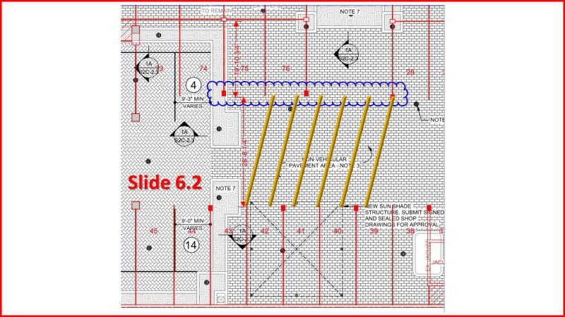

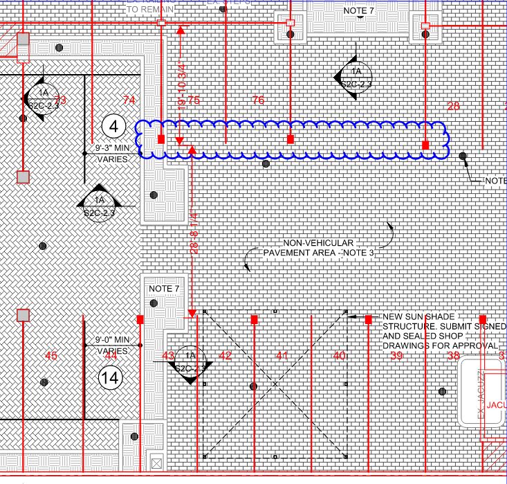

Thank you very much for your detailed explanation. Because I am an analyst rather than an engineer, would you kindly clarify the boundaries of “this bay” as it relates to the space numbers and driving lanes in the garage?
The reason I am asking is because I have long wondered how Nicolas Vazquez and Gimena Accardi, who parked in the garage and got onto the elevator just as the deck collapsed at 1:15 AM, could have missed seeing the first slab that collapsed at 1:10 AM. Of course it depends in part on where they parked and the route they walked to the elevator. But if “this bay” was over a driving lane they didn’t drive on to get to their parking space, or over parking spaces off to the side of their field of vision, they could easily have failed to notice any broken concrete.
Thank you!
first where is K/13 and M/14.1
Overheads_of_debris_pile_at_end_of_ramp__zoom_with_slide_in_lower_RH_corner_-_6.1_wwjdmb.jpg
and from StructuralMadness's image, what are the numbers
Overheads_of_debris_pile_at_end_of_ramp__zoom_with_slide_in_lower_RH_corner_-_6.2_cy17jn.jpg
If I have misunderstood any of this, please correct me
SF Charlie
Eng-Tips.com Forum Policies
Thanks for checking my understanding. That was close to how I interpreted it too, thinking that a bay was bounded by four columns instead of six. Depending on where the Vazquezes parked, they could have missed seeing it.
I found an error in my spreadsheet calculating the weight of the planters. I am also correcting the height of planter #5A from 2 ft to 6 inches. That reduces the weight of the planters somewhat.

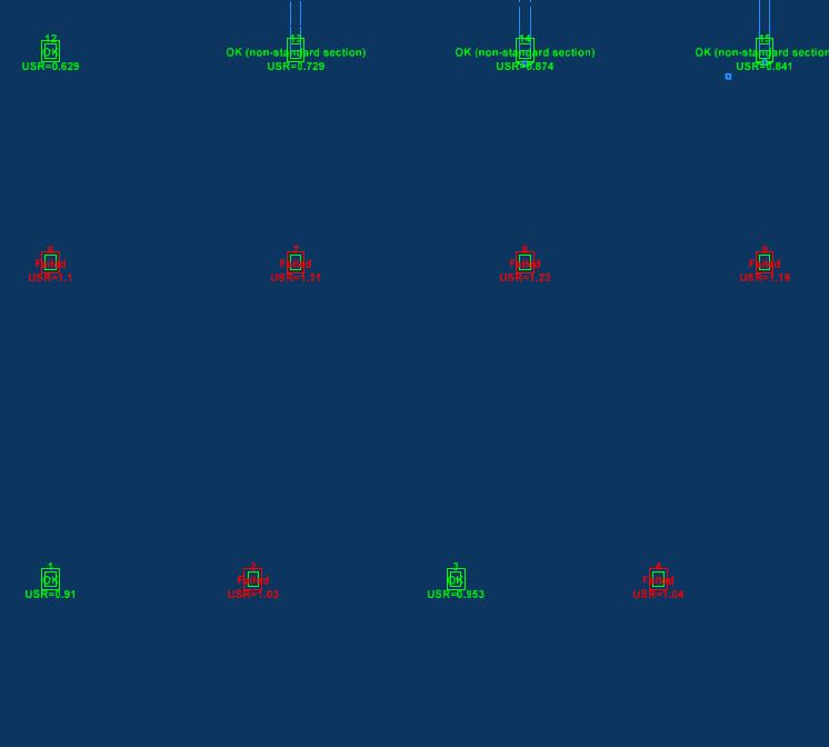

I am also proposing a cause of the failure of column K13.1 and therefore of the building. I am proposing fatigue failure due to the cyclical loads of the parking deck. Although the amplitude of the cyclical loads is small compared to the dead weight of the deck and planters, that may be enough to cause fatigue failure of column K13.1 because the column had a high load. Over 40 years there may have been hundreds of thousands of cycles as I believe this was the valet and visitor parking area. We cannot also forget Building Integrity's point about the deletion of a key beam that would have helped column K13.1.
I would have liked the cyclical loads to be larger to invoke fatigue failure, but fatigue failure checks the following points:
1. It would explain why the structure stood for 40 years and then, seemingly suddenly, collapsed.
2. It would explain the lack of a trigger.
3. It may explain the noises in the building as column K13.1 suffered slow-motion punching shear.
4. Other causes of failure seem less and less likely.
5. Only columns K11.1, K13.1 and K15 would seem to be subject to enough cyclical loads to suspect fatigue failure. Other columns may also have had high loads, but not subject to cyclical loads. The 24 in by 24 in columns may have been stout enough not to suffer this kind of failure.
