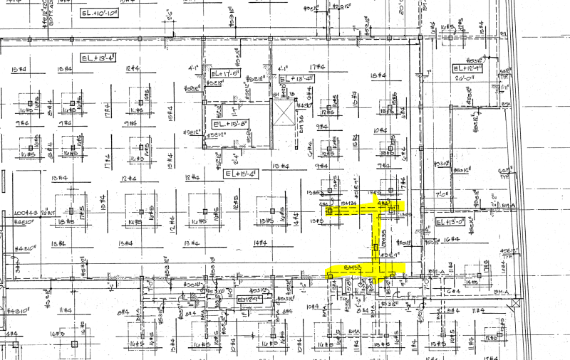

Is there any rational as to why the 2, 3, and 4 PIFs would only be ~53.5" below the surface for this type of geographical location? This seems very odd to me. On a property on this shore line we typically drive H piles down to at least 15ft because of the underground water flow.

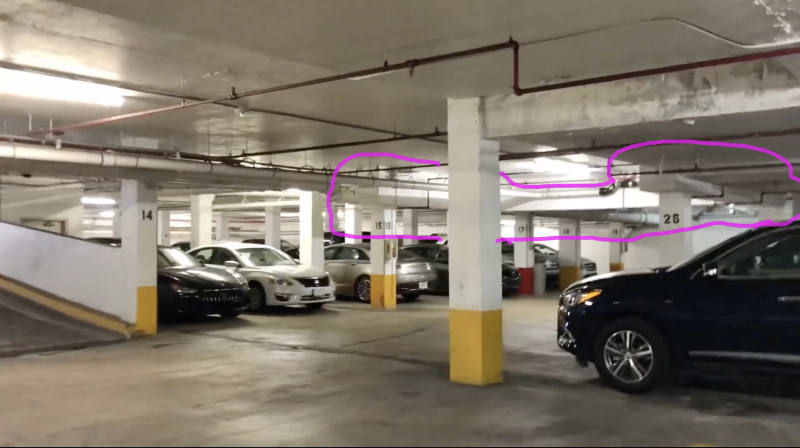

Auri, those are three beams that were above the garage level columns that were just to the east of the garage entrance, see photo below. I can only assume that when that last part of the building came down, the columns were reduced to rubble and only the beams were left, but we have no way of knowing if that is the case or if they removed everything under the beams and left them there. The position is close to the location they were when raised on the columns, perhaps a bit south of it? based on the rebar which must be remaining from the columns. That section twisted when it fell. This photo below is from that garage walkthrough part of the video showing unit 611 from last year.
Auri - I think what we're looking at is three beams that were supporting the garage/ceiling first floor slab. They fell straight down in the collapse but remained in tact.
The piling elevations are not in the plans. They’d be attached to the DERM certs. It’s still unknown if it’s all precast driven or the mixture with driven at the boundary and franki for the interior.

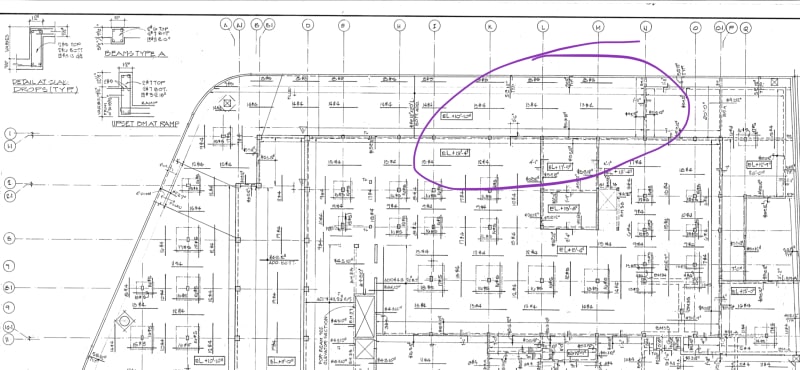

This area has me baffled both in the why in the first place and how was this revised and actually built.

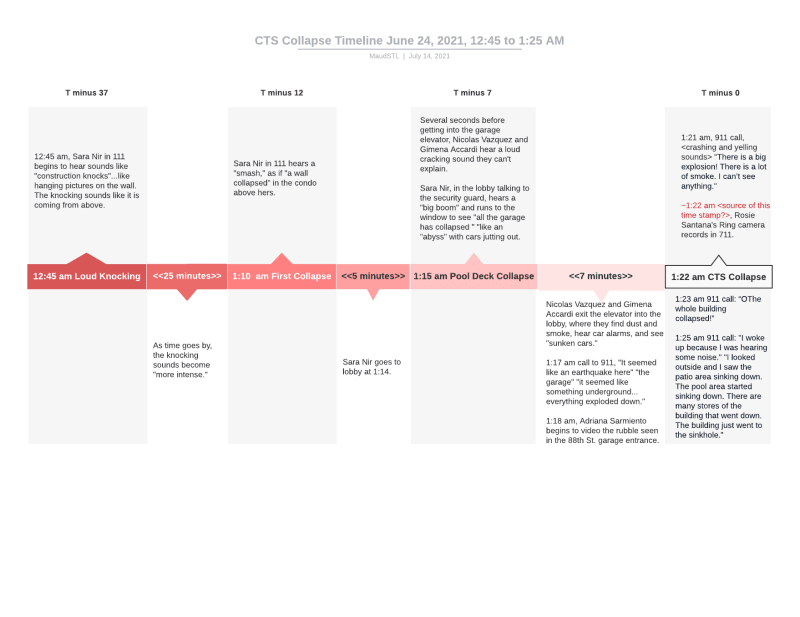

ce3527 said:
Does anybody have any theories on this concrete slab in the post-debris removal photo? It appears to be fairly in tact in areas where it's exposed.
Is it possible that this is the first collapse that Sara Nir in 111 heard at 1:10 am?
For 25 minutes, Sara Nir heard knocking "construction sounds" that increased in intensity over time. Then she heard a "smash" that sounded like a wall collapsing. That is what caused her to go out to speak to the security guard in the lobby.
****Edit: I just read for the first time that Chani Nir says she was hearing the knocking sounds when she got home at 11 PM. So the knocking sounds may have been going on for over two hours.****
Here's a basic timeline that shows this and other events, along with a few building-related quotations from early 911 calls. It may provide some use in testing various hypotheses.

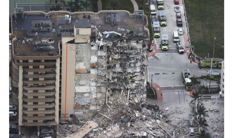

Can anyone explain how this 12th Floor PH parapet is on the bottom of the patio deck pile, where deck did not fail, when the PH was the last floor to find the ground? See Tropmet's picture above for larger image at bottom.
I've done lots of reports for insurance guys... and it doesn't matter who hires me... report is essentially the same.
That’s a planter.

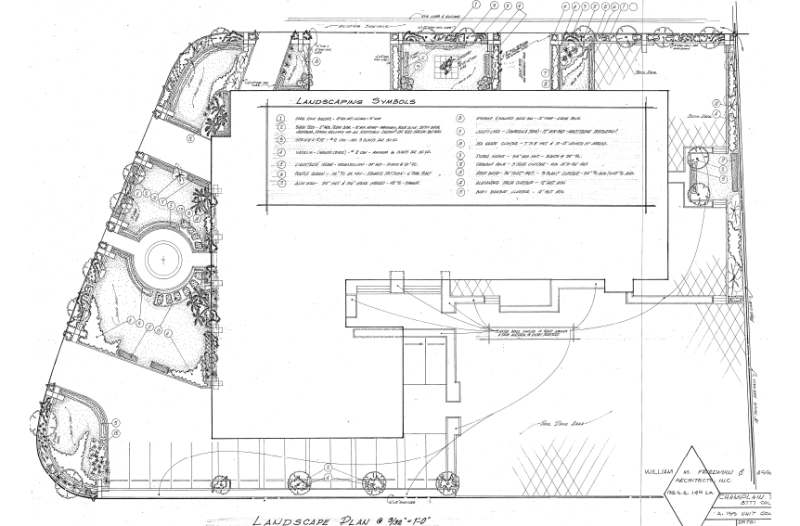

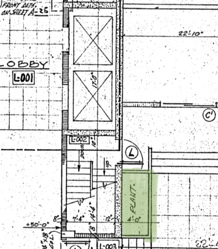

...not sure I know which kind of why you're looking for? Here is the landscape vision:
(also so, the YouTube channel BecauseSurfside has a video from about a month ago about "undergrounding" Sorry, red herring, that was about the cost of undergrounding utilities Looks like they wanted to use every inch of their property underground and still have landscaping.)
