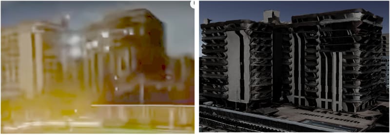

The reflection theory is interesting and I’ll have to take a look. It does appear that that particular “light” gets tucked under, which would be consistent with a reflection.
I did notice that the red light on the top of the elevator room, which I assume is an aid to navigation light for airplanes, is on a circuit with a white light to the far right of the eastern wing.

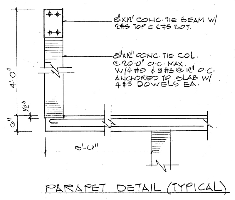

We should be seeing some evidence of the missing parapet theory come to light very soon, if not already. As I said above, the last photo with a supposed parapet looked a bit beefy for a parapet. Its basically not a load carrying member and most likely not more than 8" thick. Has anyone seen that piece dimensioned in a design drawing anywhere.
I think that theory might be getting less probable by the minute.
I'm kind of a stereoscopic photo fan. When I first saw that video, I lined adjacent frames together to view a stereoscopic image in a 3D type viewing perspective. Since many things are moving downwards, rotate them 90° to the right, to minimize the appearance of 3D displacement in depth from the downward motion and it helps. Those lights did seem to have a reflection characteristic, as they seemed to be a bit in front of the action, rather than from behind. Another thing was that I believe the camera was swaying from the seismic vibrations, as one duo of pictures will appear to be displaced a bit forward from their adjacent pairs. These don't take a lot of motion to distort depth. Anyway I was impressed as to the apparent depth of the hole that opened up below what seemed to be the roof, or a good portion of it, that I thought it looked like it was trying very hard to remain horizontal. Well, if you like that potential method of seeing some depth there, I thought it was interesting for awhile.

The 4 ft tall parapet is comprised of reinforced concrete columns at 20 o.c. with a reinforced concrete cap beam and CMU wall filling in between the columns. Maybe there are some other notes or details in the plans but this only states that the column is tied to the slab with 4 -#5 bars.

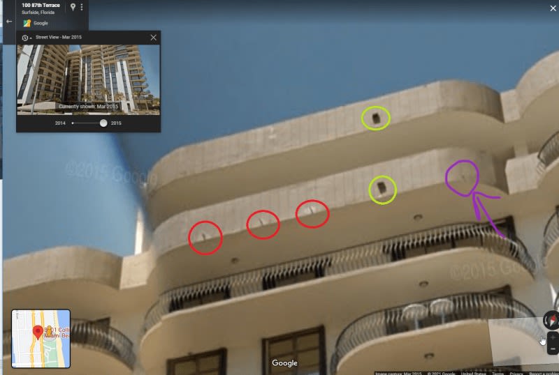

Question for the guys who build buildings: If I am not mistaken the objects circled in green are the scuppers that drain from behind the parapets. But what are the items circled in red? This is from the Google StreetView of 87th street looking up at the top of the façade that came down first.
Edit with a W.A.G. - condensate drains embedded in the floor slab? That they chipped out when they built the penthouse?
Green are the overflow scuppers, red is balcony drainage (added in 20xx)

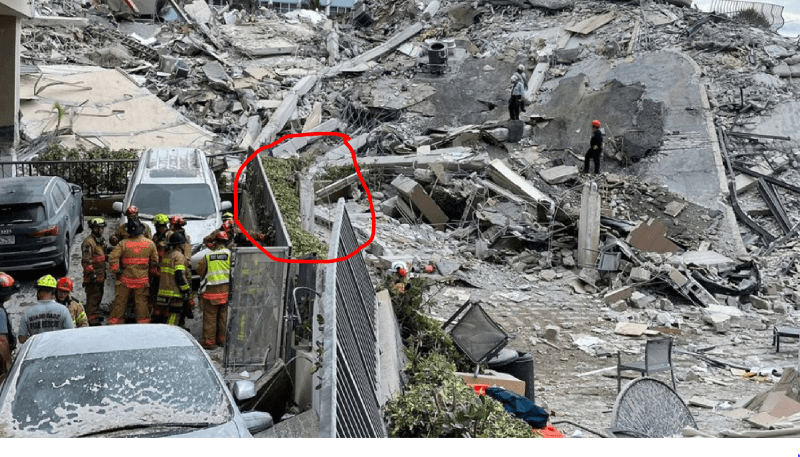

Ungrouted CMU wall. I don't see any rebar. It wouldn't take much to blow that over.
@Santos81 interesting. I would have thought that the scupper sufficed as a balcony drain, but perhaps it ended up too high or too far off to the side? Though if I entertain wild thoughts without enough evidence... if the drain on the RHS was inadequate, and water was flowing/pooling to the LHS enough that additional drains were needed... could that be indicative of slight settling beneath those drains? To carry that thread further: is the balcony itself sagging, or is the building somewhere below descending by 2mm?

The overflow scuppers were not the primary RW drainage outlets for the roof or UPH parapet balcony. Their base elevation was 7” above TOS and incorporate spring loaded doors. It would take approx 10” of water before they will open and it’s not subtle. Definitely wouldn’t want to be standing under one when it does. In Miami, Flat Roof systems utilizing scuppers as primary RW discharge to ground on Mid-Rise and greater structures require downspouts. I marked the original balcony drain on your photo. For the given drainage area, one outlet definitely was not sufficient and interior flooding would occur before the overflow would be reached.

@Santos81 Got it. Those figures surprise me. Does that mean that a flat roof equipped with a parapet and scuppers as described would collect and hold a considerable amount of water before it was able to drain through those devices? I am somewhat ignorant on the subject, but I have to assume that the roof would be designed to shift the water to some other means of collection/discharge and would not be designed with the expectation that it would regularly hold up to several inches of accumulated rainfall?

Generally one would expect roof sloping to centralised catchment points and drain pipes from those to ground level. Only runoff from the balconies would normally be directed outward and overboard.
The anchorage of the parapet looks like it is sufficient, if it was in good condition. A column at 20" o.c. and the top tie beam would be all that I would expect, if that much. The dimension of 8" thickness was exactly what I expected. I'd say, if in good condition, it needed quite a bit of help to get knocked off the roof.
So to see that on the ground, we look for 8"x8"x16" CMU bits with some sand-cement morter columns on each end. The columns cannot be more than 4" wide and they have only one 16" long block between them. Anything else would put the columns at > 20"c/c. So, probably adequate, or more so, but probably not very chunky when broken into pieces. The cap beam would most likely form the largest remains of that assembly.
