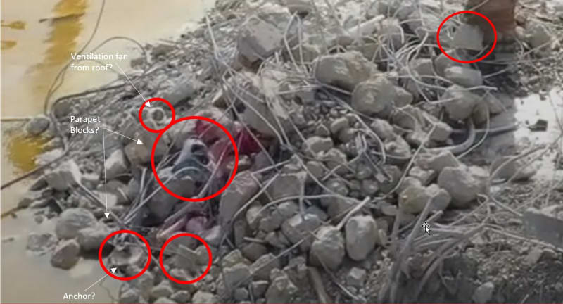

It seems like all of the objects they believe have an importance are being sprayed painted with some sort of tag (usually in blue or black), and are nearly always removed on the day they tag them. I've yet to see anything that was clearly from the roof get tagged.
If you look at the photo below you can see that several shots of red spray paint can be found around one of the objects. I was wondering what this red coloring was, and now you have confirmed that objects of importance have been spray painted with some sort of tag before removal. This object must be considered to be one of importance. I believe that it is an air conditioning unit from the penthouse roof.
It is not a "problem" for the failure theory at all, if the first column did not fail in punching shear. Columns do not fail in punching shear. Slabs and plates fail in punching shear. Columns usually fail by combination of axial load and buckling flexure, especially if they lose lateral restraint provided by a slab. With one column buckled out, the adjacent columns would get an instant 1.5 x design load. With the slab no longer providing lateral restraint to any of them, they're most certainly going to buckle instantly, probably faster than the first column. The next columns then have 2.5 times their design load and no lateral support and so on. Actually there is no need for a failing slab to pull on the columns at all, but that certainly would not help the situation if they did.
Without a known scale reference, its hard to say, but those look kinda chunky to be from the parapet. Surely the parapet wasn't more than 6-8-12" max thick, no? I mean if that's a fan, OK it is circular shaped, from an AC compressor, those blocks must be at least 18" cubes or more..

NOLAscience said:
I don't think that is red spray paint. It's too diffuse. Could it be Conduit Red in concrete, which is designed for coloring concrete used in utility work for proper identification, like this stuff: ?
Then why is the rebar above it colored red as well?
A smudge of red on a pile of garbage.
No red on the “anchor”, “parapet blocks”, or “roof ventilation fan”.
No cones. No caution tape.
You’re doing more to undermine your “theory” than to support it.
I happen to think that that red smudge is the remains of someone’s oversized sock puppet.
Since it’s still a USR Triage site, red indicates HR location.

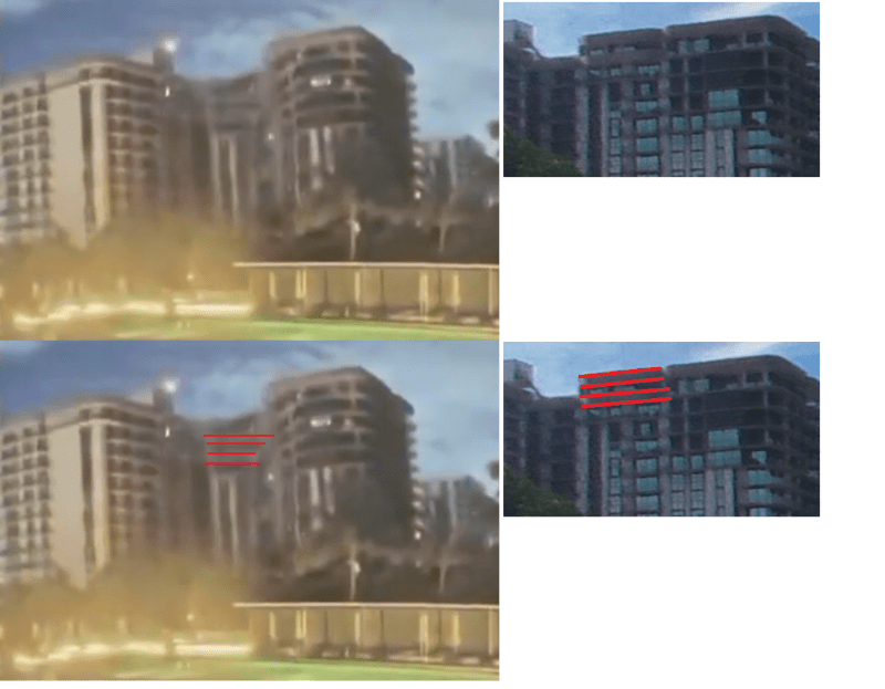

I don't have time to do a full writeup at this point, hopefully later today. But I invite any of the video-pixel-peepers to revisit the CCTV from the condo to the south:
-SLOWLY scrub back and forth from 0:00 to 0:06 in the video, the beginning of the visible collapse.
-Note that the two arc flashes between the collapsed portion and the standing portion are the first frame of the clip.
-Note how the flashes don't correctly line up with the lights going out in the windows to the right.
-Note how the two windows right in the middle seem to stay lit up for a very long time after the flashes, once they seem to have moved more than 1-2 stories.
-Now I invite you to consider the following: those are not lights; they are reflections from lights across from the windows.
-Watch how tiny "lights" appear to turn on and off as the facade slides downwards. Notice that the sequence appears to match the movement of the building. Perhaps what looks like lights turned on is nothing but reflections.
What does this mean? Perhaps nothing. Just interesting.
For what it's worth, that mush doesn't look like it includes the penthouse parapet in the collapsed section :O
Edit: Well I don't know if it's there in its entirety or not, but the upper two parapets are clearly visible at the top of the falling facade:
