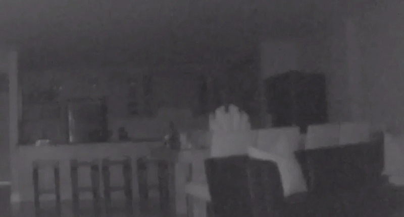

In my original post with 3 GIFs from the Ring video, I referred to tilting of a "refrigerator" - but I wasn't talking about the stainless steel refrigerator that is on the left near the doorway. Instead, I was referring to the tall, black shape on the right, behind the couch and chairs, which looked like the side of a refrigerator to me. But I don't know why the unit would have two fridges, so I'm not sure what this is. I've edited my original post.
Here's a cropped and zoomed version of the first frame-last frame GIF. Look at how the tall black object behind the couch moves. It's probably the second most active object in this sequence, other than the vertical wall/column between the doorway and the entry.
There's a column right there, so maybe the floor slab is buckling at that location, pushing the black object up But the black object is on the far side of the column line; I would expect the hinging to happen on this (camera) side of the column line.
This crop also better shows, I think, that the side of the room the closer to the camera is sinking relative to the kitchen.
Can you provide a non-cropped and zoomed version so we can see what is actually going on?
I notice there is a picture hanging on the kitchen wall (left side). We barely see it in side view. This gives us a clue about verticle as well.

Did you miss the beginning of the thread? Scroll up. The uncropped versions are in my post at timestamp 13 Jul 21 03:59.
Good eye. If that is indeed a hanging picture, seems like it remains almost exactly vertical, so that does give weight to the theory that the room (or the camera) is not tilting, at least not as much as I illustrated in my 3rd original GIF.
