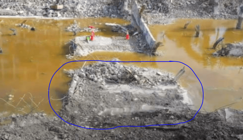

Does anybody have any theories on this concrete slab in the post-debris removal photo? It appears to be fairly in tact in areas where it's exposed. I thought initially this was the garage slab on grade and they just removed the rest of the garage slab on grade around it which became filled with standing water. But I don't think there's any reason for them to remove the garage slab on grade, or that place becomes a mudhole plus I haven't seen it removed in any pictures. Then I thought maybe it's the pool deck from above, but A) it doesn't have pavers on it and B) this is the exact area in the Tik Tok video where it seems to show concrete chunks to have fallen, so how would this be in one neat piece?
Maybe the answer is obvious, but it's escaping me.

It does seem to be higher than the other slab areas which I assume are submerged. Is it possible that this is an upper slab that punched through? The slab elevation change, planters and the supporting beam I feel that might have failed first is to the south of this location.
Colostruct - yes, that makes the most sense to me that it's the pool deck slab. they may have just removed the pavers. someone in the tiktok video said "i thought it was an accident". if that slab pulled away from the building as one piece and dropped suddenly to the ground it would have made a huge bang.

I don't think it's the pool exterior slab. I believe it is an interior slab. If I have the orientation right from the plans, there is a row of columns between the base of the ramp and the exterior of the building and we can see remnants of two of those column in the photo you referenced. I believe the outside of the building and the edge of the planter/pool deck would be further down the photo. (South on the drawings). Unfortunately, I haven't see a great photo of what the beam looked like at that location.
But, I do believe this to be "ground zero" for the collapse of the building (after initial collapse of the pool deck and upper parking areas). My gut feeling is that the column to the right of this "slab" you are pointing out is the one that finally collapsed and brought the building down. That makes sense because the building didn't lean much as it went down.
Edit. Whoops. I meant the column to the left massively failed and initiated the main collapse. This was AFTER the beam at the slab change initially failed and caused the first wave of damage.
The generator room would be located there if I am not mistaken.
Should be the basement slab which is not entirely on grade. There are pits for the storm drainage system below. One of the larger ones is between that slab and the end of the ramp.
To add:
The water level will change with the tide. The TOS elevation was surveyed at -0.27ft NAVD so it’s underwater outside of low tide.
