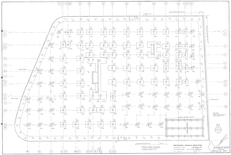

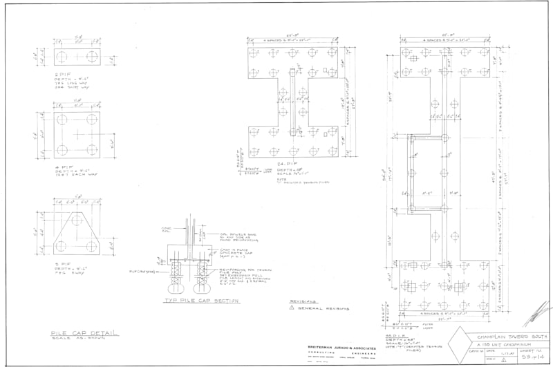

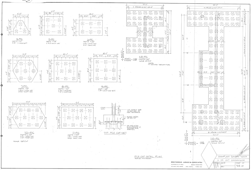

Santos81 said:
The piling elevations are not in the plans. They’d be attached to the DERM certs. It’s still unknown if it’s all precast driven or the mixture with driven at the boundary and franki for the interior.
I'm assuming based off of dimensional call-outs for 3'6" and 48" of piles, the 2'2" slab elevation for the parking/basement level, 4" pile to cap recess, and 32" pile cap height.
The simple fact that depths of the piles are called out makes no sense to me.
I could completely be reading the plans incorrectly, I don't doubt that one bit. They're a mess and they make the Fontainebleau renovation plans look like a masterpiece.
It was Miami in the 1980s. Augercast piles? Especially with depth callouts, that would be the easiest pile job ever. Drill to depth, insert some corrugated steel tubing to stop the water ingress, pour your concrete, and call it a day. (Old but very common practice here, and wasn't known back then but we know today, water flowing underground around steel pipes leads to open voids). Only deviation being dropping a wired up #7 cage assembly. Few inches of concrete at the bottom so the 72" long rebar cage (Or 78" long rebar cage for the 48" piles, but we're talking about 6" here and you can easily cheat only using 72" long embedded reinforcement, because just like using the incorrect size nelson studs, aint no body going to know once it's in the ground.)
I fully understand this is NOT how it should be. But I'll refer back to my story of the kid using his fall arrest harness to try and swing to a lower level during construction as the level of brilliance building our high rises.

tnwaits1 said:
The original plans are, as you noted, terrible. Full of discrepancies and missing and inconsistent information. To clarify, I think the depth you are seeing refers to pile cap thickness, not depth of pile. The depth or length of piles (either 150 ton PIF or the original 50 ton PC) should have been determined by installing a test pile where in the case of the PC would have been driven to practical refusal. How they determined the 150 ton depth of the PIF (aka franki pile) back in 1980 I don't know. Also note that the original pile cap plan which shows closely spaced square concrete piles (PC) was not apparently revised to show a new layout with the PIF. As you can see below, they only provided revised section views for caps with 2,3,4 PIF and the two H shaped shear wall caps. There is no revised cap plan that shows the foundation for the columns that failed (K,L,M). The foundations supporting the main columns that failed cannot be determined from these plans. To my mind, there have always been 2 separate questions regarding the collapse which are; 1. what triggered the collapse? and 2. why was the damage not more localized? The second question comes down to the original design being flawed, and there is certainly evidence in the original design documents and photos of the collapse debris to strongly suggest that the building lacked the type of redundancy that would have ordinarily limited the damage.
However, we have drawn to scale.
Measure that pile cap to scale off the known 4".
Fuckin oops
Edit: Were the caps supposed to be the 3'6" sections? Because that is not how the plans call it out. As read, and hopefully not as built, that building stood on 6ft legs.

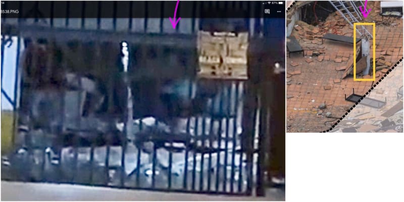

jbourne8 your mention of column labeled 39/40 in the garage resulted in being able to reinterpret this as an uninterrupted view of the fallen pool deck, but the column is further back in the image. I did lighten and color enhance an image (not remembering now if it’s one I pulled from the forum here or one I took a screen print of from the video). You can faintly see the color of the pool deck tile surrounding that column after this image enhancement, below the arrow. The other image is from the WaPo article, for reference. This is also the correct location for where this column would be seen from this viewpoint.
The column in the foreground labeled for parking spot 27 delineates where the building meets the pool deck. It does appear that the pool deck fell all the way to the edge of the building, before the building collapse. The edge of the pool deck that connected to the building at this location is clearly illuminated on the ground from a light still on in the garage, because you can see the sharp shadow of the broken piece of the deck undeneath it, probably the deck immediately outside unit 111 that was their private deck bordered by the planters. It is located just past column 27, where you would expect it would be. It appears you can then see all the way back to that column labeled for parking spots 39 and 40, behind the fallen planters, partially sticking up through the pool deck tile. This suggests that at this location the pool deck fell all the way from the exterior wall to where it met the building, which would also explain why there are no remaining garage overhead lights in this back part of the garage; we’re only seeing the fallen pool deck. Since it was nighttime there would have been no illumination from the sky, but at this point it is likely there is still some faint illumination of the pool deck from the building lights enabling the view of the distant column.
Admittedly there is a lot of noise in the image so I would not want to overanalyze it, but I was surprised when enhancing the light and color to see that, and felt confident in this conclusion. Also because of the extreme foreshortening in the image it is a challenge to understand the perspective.
