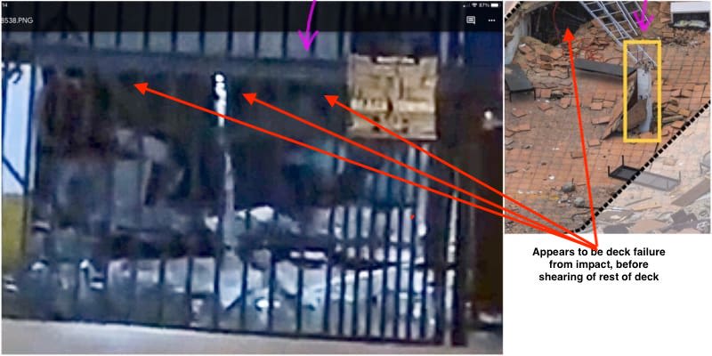

I actually think it could make sense:
- There's a column visible embedded in the wall, right near this object.
- Perhaps the floor has detached from the column. The floor slab may be sliding down but the column may not be.
- In this break between the two elements, the column takes a little chunk of the floor slab with it, or the floor is generally buckling around where the floor slab previously attached to the column.
- The black object moves "up" because most of the floor below it is now sliding down, but the small chunk of floor slab still attached to the column is not moving down, and that's causing this object to tilt to the left as you suggest, and also back toward the kitchen.

I believe, generally, that the failure methodology you described makes a lot of sense.
I have a slightly different take on this however. There is a beam constructed that acts as a transfer beam to support the changed slab level beam. This spans from Col M-11.1 and M-9.1. In pre-failure photos, this beam has appeared deflected. Photos can distort. There is a lot of water leakage in this area. I believe that this beam failed very early on and maybe it took the pool deck with it. If this failure was caused by connection to Column M-11.1 the beam could drop and it could take awhile for Column M-9.1 to fail. This makes sense with the video by the tourist through the parking door. I believe we see M-11.1 on the ground and this beam dropped. Although it is hard to discern.
IF this beam to column connection at M9.1 was compromised due to reinforcing degradation (it is directly below a planter) there could be loss of restraint and, possibly, even loss of reinforcing shear capacity. This could have been a construction error and the plans are not great. This could easily be a beam that was overlooked and was added by hanging from the column instead of bearing on it (the photos look like this could be the case).
This beam failure could cause column rotation and failure of the columns on 9.1.
The question still remains on if there was some trigger that set off a serious construction deficiency in the building as a result of the activities to repair the building.

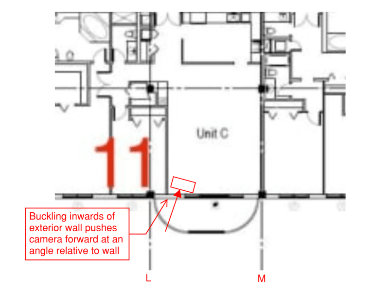

Based on the dimensions of the room and the likely lens size, there isn’t really a good fit for the camera being up against the wall. The center of the view is almost perfectly aligned with the kitchen pillar, making the camera about 36” off the left wall. The angles of the pillar in the right wall and the corner at the end of the left wall match this, and also puts the camera about 88” from the south wall. The lens is about 110 degrees.
So, most likely, the camera is sitting on a table set a few feet in from the window.
Feel free to post an alternate combination of distances and field of view.
I'm still struggling with the "Ring" video sliding to the right too, so tossing out a new theory that the table didn't slide to the right, but was pushed forward/possibly rotated by the exterior buckling behind it and bowing inwards.
@CE2537: If the post above yours, that the camera is 36" off the left wall and 88" off the south wall, is even remotely accurate, I don't see this theory holding up. I tend to agree with the positioning assertions that this credenza/furniture is not pushed up against either wall, so for the wall to push the credenza, it would have to deform a tremendous amount to bridge the gap either to the left or behind.
It does seem odd that the credenza would be so far away from the walls, but there are all sorts of items in here in unexpected locations. Note the couch pushed right up against the back of the chairs, for example. This unit appears to be dormant, so furniture placement may be more about temporary storage and wouldn't necessarily follow a "where the average person places furniture" paradigm.
Also, there's no indication that I see from the interior video that the table or camera has changed angle relative to the south wall. It moves almost exclusively right (and down relative to the kitchen, if you look at the cropped GIF in the middle of the thread). In the first frame-last frame GIF near the top, if the camera angled relative to the south wall I think you'd see it pretty clearly (but I don't).
To be honest 36" off the left wall would tie in perfectly with my original thought of the table or whatever resting against the internal angle of wall or the inside of the balcony door frame

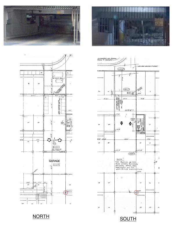

One curious thing about this collapse is that there is the North building which has some identical features, one of which is the column layout in the critical collapse area. A lot of us have looked at the tic toc video to try and understand better the collapse of the pool deck and supporting columns and how that preceded the collapse of the building. Below is a comparison between the north bldg columns and the south building along with views down the respective ramps. the north building view is from google street view and the south is from the tic toc video. This may help in looking at the tic toc video and trying to determine where the columns should be located and what damage they may have sustained in this early failure before the collapse. The column that appears to be missing from the south view is circled in the plan views in red.
Ok so I chanced upon this which could be useful especially for those of us looking at the security camera footage.
This is a virtual tour (with measurement tool) of 611 - the exact same condo the floor below.
I find it particularly interesting that the gap between the west wall and the balcony doors is virtually exactly 36".
Given the imagery in this video, this pretty much confirms for me that whatever the camera is sitting on is flush with the wall.
