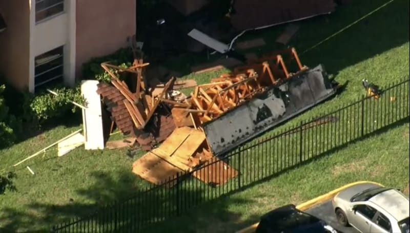

Another partial collapse in North West Miami Date today, looks as if it may be a wood structure in the photo but too far away. Only a three storey building but if it is wood then usually it does not fail suddenly; Things are getting very interesting in Miami Dade area. See previous post by jbourn8.
Who says the wood structure failed suddenly? It could have been failing for months or more. There even could have been plenty of outward indicators.
It fell DOWN suddenly, but that's gravity for you.
spsalso
OK sparky calm down a bit; news said it was re[ported that it suddenly failed. Over what time exactly we may find out later, as far as I know there is no reported video so far.
Yes a different video shows that it probably is concrete; according to the mayor it had had its 40 year inspection almost 10 years ago which jives with the first report that the building was built around 1970. The 40 year inspection apparently revealed no concerns. Residents have been evacuated. Possibly someone should open another thread on this failure.

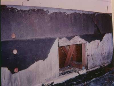

I've seen those referred to as either mansard roofs or false mansard. The actual structure is concrete, but this wooden false roof sat on top of it. A lot of times these get added to existing buildings for curb appeal. Could have gotten blown off or just wood rotted away.
"CE3527 [I've seen those referred to as either mansard roofs or false mansard. The actual structure is concrete, but this wooden false roof sat on top of it. A lot of times these get added to existing buildings for curb appeal. Could have gotten blown off or just wood rotted away."
Or the attachments of the wood to the concrete failed. My first attempt at using a quote and not too great. Weather it rotted or just blew away it should not happen and could easily kill people, why was it certified is the question and obviously closer inspection intervals are required. Was the concrete or anchors deteriorated, was the wood rotten, was it a poor design?
Cockloft is much more appropriate for more than one reason.
They are definitely going to require more competent engineers and building officials in Miami-Dade and possibly other parts of Florida. Unbelievable!!

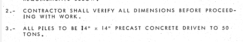

I think what will be found is the piles don't go down nearly what is thought.
All I find are 3'6"and 48". Precast 14"x 14" or as drawn to scale, 13"radius, and 50 tons.
You're not driving 42' or 48" long piles to 50 tons that shallow unless you're. constantly back filling with sand, rock, dirt, wood, rebar, someone's hardhat as a joke, etc.
I still haven't found anything else that calls out dims for the precast piles.
We've seen the other construction flawns. Hell, that odd 2" section in places on the core drills can easily be explained by the drawing issues.
Fuckin typos man.
Hi Demented
Those depths you mention refer to the pile cap itself.
Pile depths - Given the 'bulb' at the bottom of the pile (shown on the drawing), this would indicate that these are driven, cast in-situ piles (Franki). Crudely explained, a steel tube (more or less 20" dia) is driven down until it reaches a point when the displacement of the tube is minimal (probably down onto the limestone). They then anchor the tube to the piling rig and continue dropping a hammer inside the tube, now displacing a dry concrete mix placed in the tube, to create the bulb. A rebar cage is dropped in and concrete or grout is poured in. The steel tube is then pulled out.
Where they call off 'tension' piles, they ensure that the reinforcing cage is linked into the bulb forming an anchor.
These driven piles are usually quite reliable and shaft stresses are quite low (limited to around 800PSI).
Settlement of piles would show up as differential settlement between columns and be noticed long before a collapse. Safety factors on piles is quite generous.
