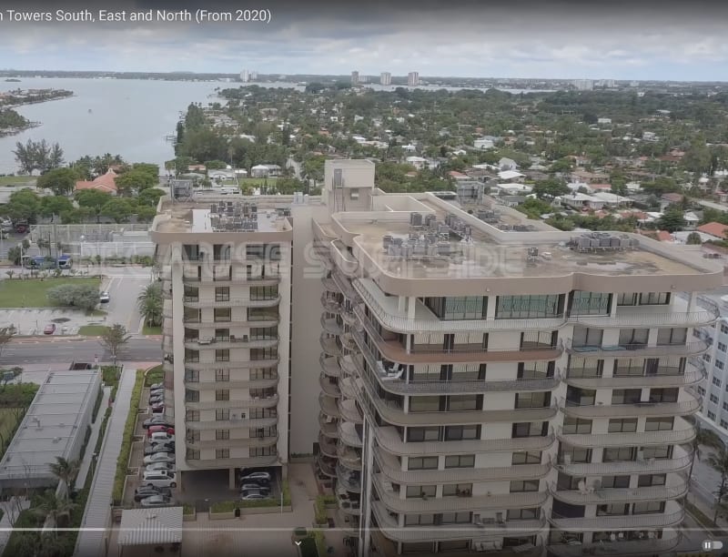

I was not implying any sinister. The plates on the post anchors are like 14-16” square. Those PH columns are small. Holes for plates are at outer edge of plate. So if plate centered over column, then holes drilled are near edge of column. In the collapsed patio deck, there appears to have been rebars near edge of column. If PH roof same scenario, anchor drilling for centered plate might get rebars near or at column edge providing either negative moment or some shear support? They were to scan concrete before drilling. Maybe they did or did not??

w-streng, Agree. It is like because PH roof only 6” slab, they put columns at outer edge of cantilever to let 12th floor cantilever handle PH cantilever and double parapet walls in that area. PH bootleg addition
Just from a logic standpoint about the roof/ac theory, what seems to be getting suggested is that the roof structure was so incredibly flawed that a few holes in a column or some 100lb rolls of roof material caused it to collapse, but that the 12th floor structure was so incredibly strong that it withstood the massive impact of the falling penthouse roof slab.
And as I remember PH cantilever roof projected out further into space than 12 floor cantilever and parapet.
I'm not sure "suggested" is the right word as much as it is "assured" by some posters when it comes to those defenders of the "roof-first" theory. And their theory is that big chunks of roof/penthouse fell (apparently with a convenient delay from when the culprit roof anchors themselves were actually installed), and spectacularly blasted through the pool deck slab like a kill-shot.
