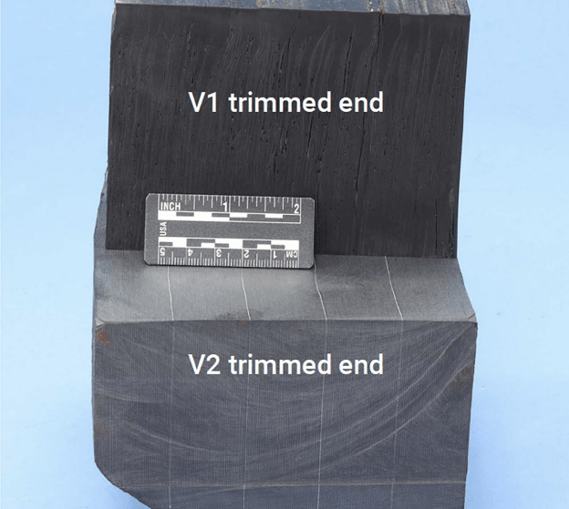

This may have already been known/discussed, but the NTSB showed that the two hulls were of completely different design: the v1 hull was monolithic (?) while the v2 hull was a series of shells bonded to each other with adhesive. Evidently these adhesive joints mostly failed during the implosion and the debris therefore consisted of the fragmented individual layers.
Interested to hear from those of you with CF experience regarding these findings.

The 'V2' hull was wrapped and cured in stagess a direct response to the large amount of internal delamination/porosity seen in the first hulls constructed (both full scale and test) which were wrapped and cured in one go, using a wet layup. This decision is covered in other documents released as part of the hearing.
I would think that obtaining the same strength as a monolithic part would be possible, given sufficient/correct prep of the in-place cured surface... but I've only ever dipped my toe in the composite design pond, I wouldn't call myself an expert.

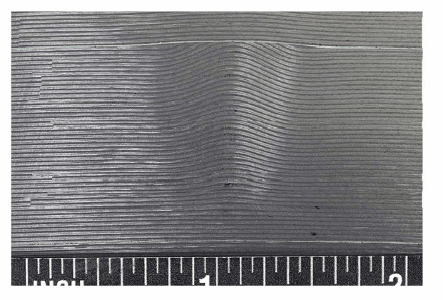

Oh my, it gets worse:
Not only are there nasty wrinkles that significantly reduce the compression strength, but some idiot decided it would be a good idea to machine them flat, thereby cutting the very fibers they are counting on to carry the load. UGH.

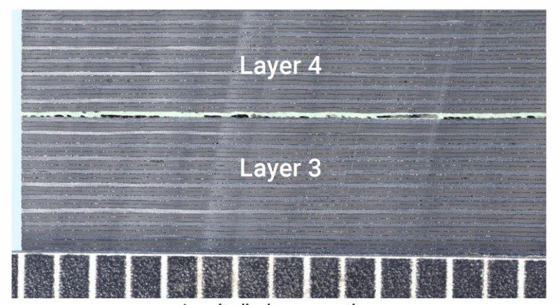

And then this gem:
A "nice" planar disbond along the adhesive line. Great.
The hull fragment photos later in the doc show the hull clearly disbonded along the adhesive layers. Probably too complicated to tell if that was the initial fracture or not.

SWC, I see only 4 fibers of many cut by the machining. Do you think the cutting of the 4 fibers compromised the strength more than allowing the defect to continue through the rest of the layup?
The cut fibers,
- cause a local stress concentration in the laminate as load has to shift to adjacent layers,
- cause a stress concentration in the adhesive bondline, which is already compromised by porosity, voids and general poor quality
How much the cut fibers degrade the overall strength is near impossible to predict, without some test data to calibrate the prediction.
The fiber waviness thru the thickness results in reduced compression strength (like a pre bent column with a axial compression load). This is also hard to predict.
And they apparently designed the laminate to wildly optimistic ultimate strain levels (that essentially assume perfect laminates with no defects or variations).

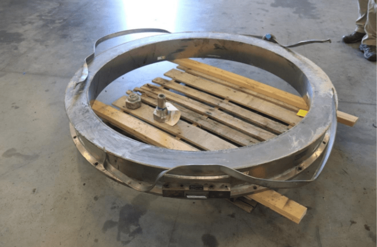

Have any photos of the interface rings been presented? I have zoomed in on the wreckage photos and rhe limited view of the hull interface recess in the rear ring is pretty obscure. The front ring hasn't been shown, has it?

The two reports on the NTSB website go into more detail than the summary on the USCG MBI website. The outer surface was very wavy and there were very many locations where the wrinkles had been ground to allow the next layer to start without wrinkles.
The NTSB report noted a loud bang at the end of dive 80 (after the sub had surfaced), which resulted in a noticeable change in the strain response of the hull (including a new nonlinearity that was shown at the start of the next dives). The NTSB report also noted that the adhesive surface between the end of the hull and the ring had a rubbed beginning near the base of layer 4 and continuing radially inward. This may indicate that about 3/5 of the adhesive had disbonded long before the failure.

From jmec87's link:
The inner location flange failed in shear as the bond between the hull and some failed which is expected. But the outer flange failed in bending and bent outwards.
Having the two flanges is a terrible design as it traps air and doesn't let excess adhesive flow out.
Wouldn't the flanged design be a benefit if the relative compressive response of the hull cylinder ends and the interface rings can be matched. I believe the necessity for this behavior was discussed by 3DDave at 9//2024. The inner flange would limit the shear load on the adhesive. Mechanical interlock of the hull ends to the interface rings would be a necessity. Regardless of any 'bang' that may have been heard, the acoustic monitor location diagrams don't show any strain instrumentation at the interface surfaces or on the interface rings. The sensor are along axial lines of the hull and arcs of the end domes, and at the circumference of the inner edge of the viewport. Mechanical failure at the interface zones was not being monitored. The epoxy is wiped clean off the forward interface ring.
