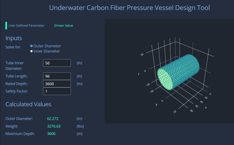

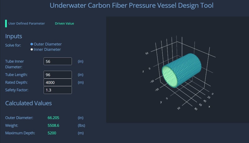

Test Sample Composite Energy Technologies
That page has an interesting design tool for Carbon fibre submersible.
It says for 4000m depth rating with a factor of safety of 2.25 you need 11 inch thick walls.
It says 5 inch thick walls correspond to safety factor of 1.3
For a depth of 3600m with a safety factor of 1, it says 3 inch walls

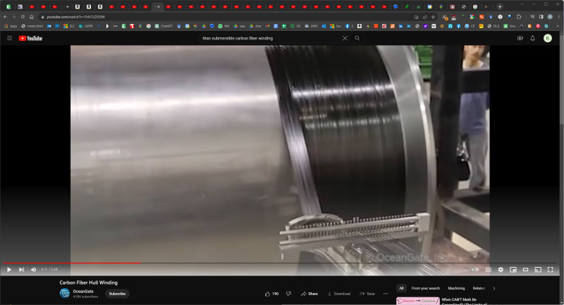

I wonder if the carbon fiber cylinder would be able to support itself without the titanium end caps?
The video I've seen of one of the winding operations showed a metal spool upon which the carbon fiber was wound.
TTFN (ta ta for now)
If a 5 inch thick wall of material isn't enough to provide stability from buckling, the quarter inch of mandrel isn't going to do much to improve that.

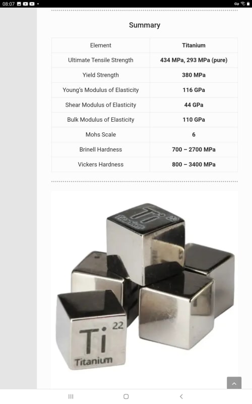

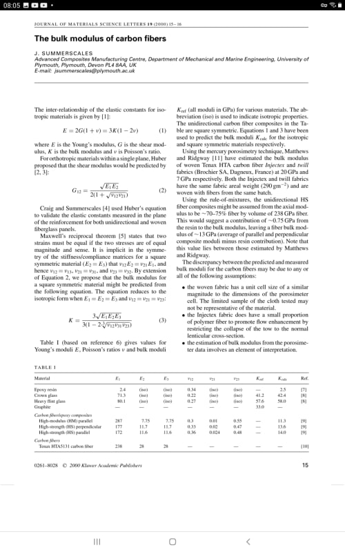

Volume change of materials under pressure is according to their bulk modulus,
Carbon Fiber
Bulk Modulus values of CF from 200 to 700 GPA are reported.
Titanium
It would appear that any interface between the two materials would be complicated by their differential compressive characteristics, not to mention within each material themselves as interior pressure of 30 psia and outside pressure of 5000 psi means volume contraction as one moves from in to outside the tube. It seems that would tend to agrevate any tendencies to form surface cracks at any interface.
