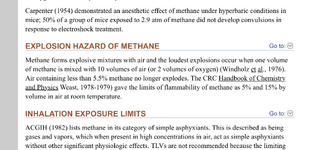

May 26, 2025 Thread starter #3 G Garbage1 Civil/Environmental Joined Oct 31, 2024 Messages 254 It seems there is a sweet spot at 10% methane to air concentration that is the most explosive. With the explosive range being between 5-15% methane to air. Upvote 0 Downvote
May 28, 2025 #4 TugboatEng Marine/Ocean Joined Nov 1, 2015 Messages 12,107 Location US Hydrogen sulfide explosive limit is 4-45% and is also present with raw sewage. We seldom know what other chemicals end up in the sewage stream. Upvote 0 Downvote
