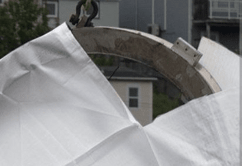

I wonder if the carbon fiber cylinder would be able to support itself without the titanium end caps? In the pictures I have seen that it appears as if the bond at the cap to cylinder failed. On the titanium flange I see epoxy in some areas and bare titanium in others. If the epoxy separates from the titanium would that allow the shell to collapse?
Otherwise, if the shell failed first the deflection could pull the epoxy off the surface of the flange.
No. The cylinder required the titanium domes for overall stability, so as to brace the hull against buckling. An unstiffened cylinder is far less stable than a stiffened one.
I did some quick numbers based on an infinite cylinder the size of the hull, and the buckling load isn't even close. It needs the domes. Submarines have ribs and similar things for the same reason.
With a stiffener at each end the hull's theoretical buckling pressure increases to ~2-3x the pressure at which it failed (based on crude approximate methods).
EDIT: Correction to above. A ideal carbon cylinder has a higher theoretical buckling pressure than the pressure where failure occurred.

Personally, I'm convinced that the failure was very likely due to failure of the window. We're spending an awful lot of time talking about the carbon fiber hull; I'm not saying we shouldn't be, and I'm definitely not saying that the carbon fiber parts of the system were designed appropriately, tested appropriately, engineered or manufactured correctly. But the hull was, in theory, designed for this depth and had some level of safety margin.
The window was literally not designed for this depth, and not properly evaluated by its end user when it came time to determine depth rating. I'd be looking to eliminate that before I started down the hull rabbit hole.
It's just difficult to see how window failure is going to lead to implosion and complete disintegration of the the hull.
Instant death just the same from pressure, but the craft should have then just filled with water and sunk to the bottom of the ocean floor.
although it was only "rated" for 1350m, I think that had a larger FoS on it (x6?) than the hull did and seemingly showed no signs of distress.
the CF hull on the other hand....
Disagree.
Failure of the acrylic window would have resulted in a 15" diameter jet of seawater shooting directly down the long axis of the pressure hull at extreme speed. This would blow the end bell at the far end right off, and release a huge amount of energy due to the water hammer resulting from the collapse of the remaining bubble of air inside the hull.
This was not like a leaky submarine in the movies where there's a little drinking fountain stream of water coming through the joint. This is literally an explosion in reverse.

In theory, yes. The unknowns are whether there were any latent manufacturing defects which could have compromised the design strength, and how much damage had been done to it by the cyclic fatigue of the previous deep dives. The lack of non-destructive testing both after manufacturing and after each deep dive, combined with the highly experimental nature of CF being used in this application, calls the strength of it into question at the start of the final dive. If the reported large bangs were fractures or delamination spreading through the structure, the hull is a highly likely point of eventual failure.
The design was based on design data not specifically intended for this application and on theoretical safety margins. In one of the many articles about this incident was the notion that other vehicles used a factor of 12 FoS based on test results specifically intended mimic underwater environments, so design data based on relevant testing, and a substantially higher FoS, neither of which were used for the Titan.
This was an untried and untested design, so FoS of 2.5 or 2.25 was just plain silly. FoS that low should have only applied to well-used, well-tested, materials with tons of testing and field experience. And even then, this was a life-critical application where a single point of failure means death.
It's likely that the dome was designed with a much higher FoS and possibly the 12:1 value, since that was off-the-shelf, so it's likely that it wouldn't have failed.
