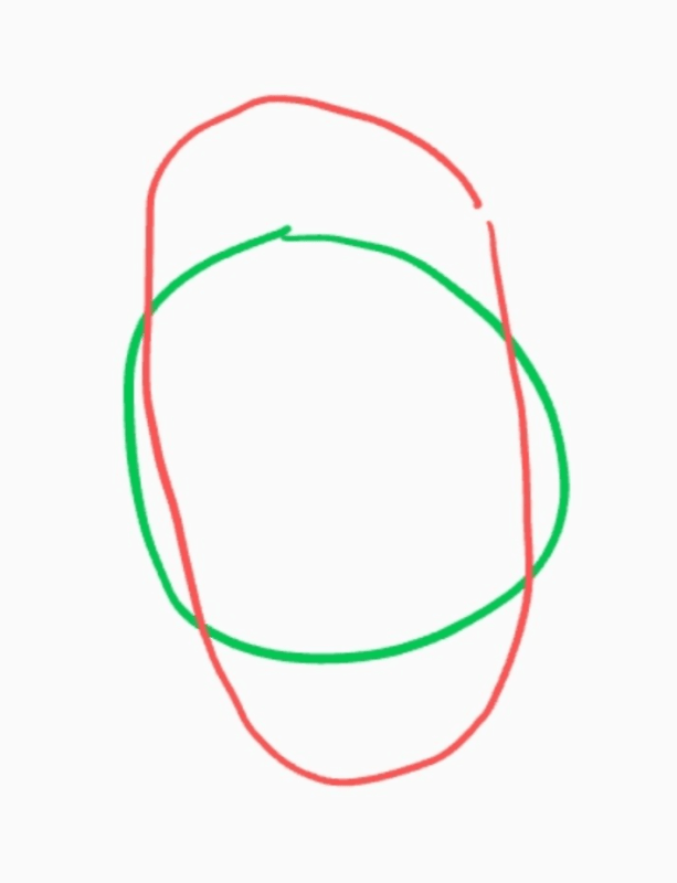

I think I see why the outer flange failed in tension. Notice that it's still attached in two locations roughly 180 degrees apart. The green circle represents the dome and the red oval is the shape of the CF tube as it failed. Sorry for the crude drawing, in the shipyard killing time.

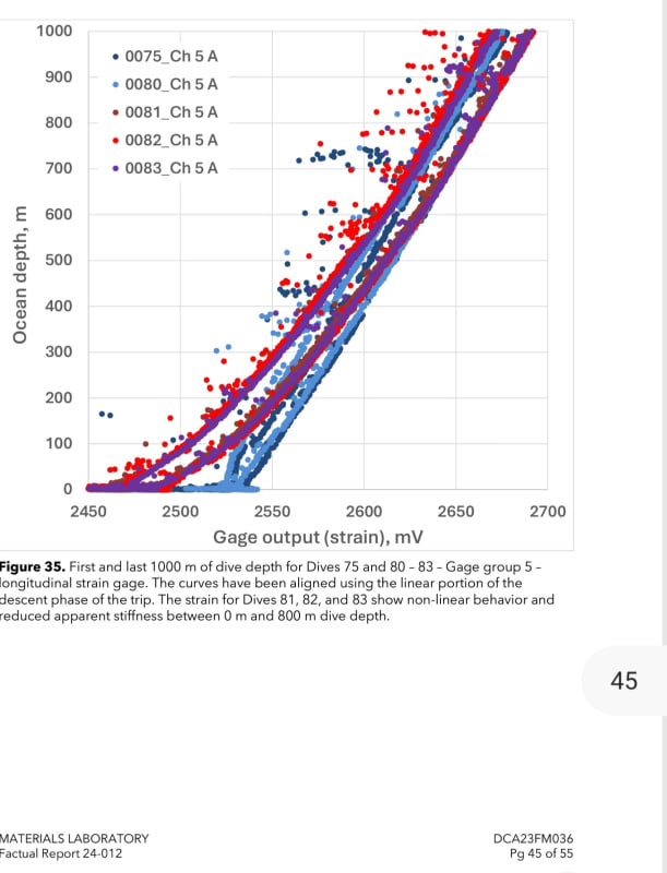

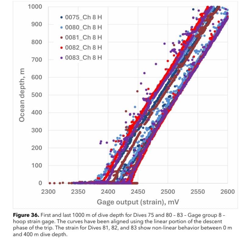

In the shorter report (55 pages) on the ntsb site, this image is presented:
Further images zoom in closer, but the bottom line: a shift in the strain gage vs. load (load=depth which is analogous to external pressure) occurs on a number of the gages recorded (and still functional) across dive 75. Dives 81 through 83 seem to show a nonlinear "hysteresis loop" in the strain vs. load curve, i.e. the strain response follows a different line depending on whether the craft is ascending versus descending. Which would be a major red flag, you'd think? Except, according to testimony, nobody at OG thought to plot strain vs. depth, nor to overlay the traces...they just plotted strain and depth vs. time over the duration of each dive.
Everywhere you look, you see ignorance, hubris and outright negligence.
edit: oh, and failed strain gages were brushed off, no attempt made to figure out why they were no longer working.
Remember that the failure did not occur with the CF tube collapsing in the middle. It seems that Stockton Rush was not incorrect about the factors he spoke about. Instead, there were other factors that doomed the tube. Specifically, in my opinion, this was the bond between the tube and domes.
btrueblood Dive 80 exhibits hysteresis so the effect does not appear to have happened exclusively at Dives 81 thru 83. Wouldn't more info (temperature, system electrical stability, etc.) and analysis be required to determine significance of any offset? Does the NTSB report state why the strain response of these last dives is presented?
Edit - Now I see the differing load/unload offset of the Dives 81 thru 83. Dive 80 has offset similar to Dive 75. So possibly Dives 76 thru 79 were not to 1000 meters, thus not included in the analysis?

Dives 81-83 are interesting because the hull response is no longer a straight line at the start of the dive above 300-400 meters (nice of them to use fat dots.)
The hysteresis on all dives is likely because the hull changed temperature during the dive.
