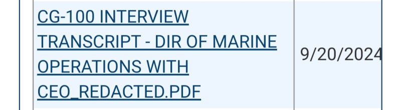

Concerning this document in the Coast Guard investigation files:
Some of you appear to have figured out who is in the discussion, and I think have a grasp of part of it but the title of the document, and the redactions, and transcription errors leave me somewhat baffled.
1. This appears to be a transcription of a recording of a phone discussion between David Lochridge, Stockton Rush, and maybe Tony Nissen, and two other unknown OceanGate personnel? The title says "Interview" but that is a misnomer. The conversation is from January 2018 so presumably before OceanGate fired David. Stockton Rush pretty well just bulldozed every aspect of the report David presented, and the other attendees don't seem to support David's position in any manner or the transcription is not clear to me. ,
2. There are surprising typos in the document with homophones I would not expect in a 'court reporting transcription' - I have not seen many, so maybe this normal.
3. Any clue on is this from a phone recording? OceanGate recorded all office meetings?
4. Stockton Rush seems highly confident of the data and analysis for his belief of the safety of the hull yet says he won't provide data and analysis for review or he uses some type of obsfucation to deny access, but none of the other attendees seem to push back. Very odd review/discussion dynamic for the report David submitted and rather calmly defended.
I find the dynamic indicated to be odd for the presumably technical attendees not seem to have access to the analysis Stockton said he had, and no one but David asked to review the data. So, were the others in agreement with Stockton? Were they just numbed to questioning Stockton's logic and passion? I have seen that dynamic before with a strong-willed CEO, so I get it slightly. But there seemed to be a definite one-sidedness to the interactions of the attendees.
It would seem to be wholly consistent with Lockridge's assertiona that everyone else either sucked up to Rush or were kowtowing to Rush. Also, Lochridge has asserted that OG basically hired babes in the woods to do engineering, so Rush's ego wouldn't get bruised, presumably, and only he would hold sway over the design, design process, fabrication, and validation.

I understand the 'Interview' document a little better now: this is David Lochridge defending his inspection report to Stockton Rush and three other OceanGate employees after the major disagreement on safety of the Titan submersible. The January 2018 date of the interview matches with the claims in the whistle-blower litigation:
So Stockton's antagonistic demeanor and the silence of the other OceanGate technical team is understandable now - this meeting wasn't a technical review. David Lochridge was already out the door at OceanGate, or soon to be.

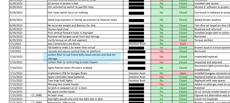

SWComposits, I had read it in the maintenance and repair log posted by the USCG in some liks above. I'm away from my PC, but I'll look through it agaín real quick and try to copy and paste some of that info.
Edit:
Direct link to log:
Mobile screenshot of mention of Hull to frame fastening via bolts.
Thread inserts into the hull. (This was the old hull just around when they found the crack and a month before it was decided to replace it. Modification was likely carried over to the new hull)
Dives and dive notes are the top few pages. Repair logs are below. Dates, dive numbers, etc available to cross reference damage with dives, dive depths, and dive locations.
The closer you look to some of the photos they've released in their shop you can indeed see they've used fasteners to attach directly to the hull, as well as some other modifications that have been done to the hull and domes.
I'm sure more detailed drawings/photos exist but those are not public at the moment.
In the lower portion on the interior of the hulls, they had also drilled for and installed strain and acoustic sensors. Some were surface moint, but one photo of their monitoring system was released during assembly that does show sensors mounted into the hull
Edit 2: Attached document of maint log.

Brian Malone: Agreed. In my scanning of the 'Interview' document I think I recall the phrase "exit interview" somewhere. With redactions it's hard to keep up with who may be saying what (other than Rush), but I gathered someone from HR called a final meeting to try and stave off Lochridge's dismissal. And the purpose of the recording was CYA for OG to justify cause for the firing. There's a detailed rehashing of the technical disagreement (with a lot of Rush rationalizing his technical bases for dismissing Lochridge's concerns- consciously 'for the record' in tone), and at the end Lochridge(?) agrees there's no 'path forward' for him with the organization, which would be a key outcome for HR's files. If it was an HR meeting that could color the technical team's participation because they were presumably included only to clarify the circumstances surrounding the Rush/Lochridge dispute rather than adjudicate it in that forum.
What struck me is Rush's conviction he had designed around ANY possibility for catastrophic failure modes, along with his utter contempt for conventional subject matter expertise. So the hubris of Rush met its nemesis in the similarly unsinkable Titanic- if this story appeared as a modern techno-Greek-tragedy the critics would probably dismiss it as far-fetched or derivative.
drwebb - yes, the confidence and conviction Stockton Rush had for the hull safety and design /testing method(s) is on one hand admirable: he is all-in with the design and believes in it and is the principal pilot of the vehicle, but on the other hand: this is tragic due to the known failure and loss of life of Stockton and those on board who trusted the vehicle and Stockton. Definitely a reminder that engineering requires confidence and some level of swagger but when faced with multiple inputs for caution maybe a step back for reassessment is warranted.
